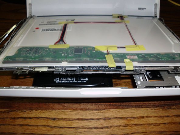

Step 1
Installing LCD & Inverter (fast method) A1181

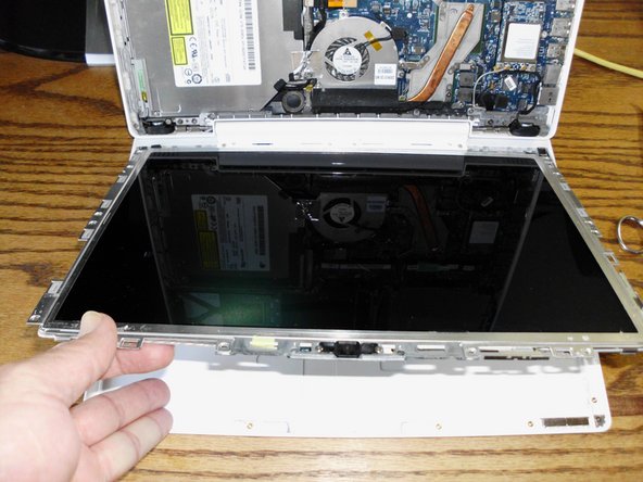

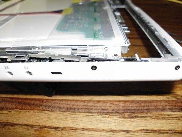

Although not necessary, I've removed the keyboard and battery to reduce weight, preventing the unit from constantly falling over. Here the bezel has been removed.
It's likely the clips will stick to the bezel. Remove them and place them back in the metal frame around the LCD. Cover them when prying them off the bezel unless you like looking on the floor for tiny parts.

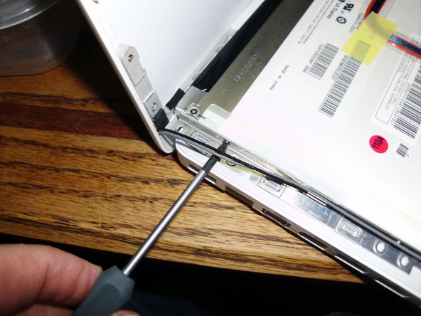

Step 3
Remove more screws

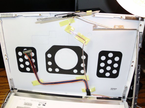

The back of the iSight camera comes up without removing screws on either side. Be careful not to lose track of the lens cover. It may or may not stay with the bezel.

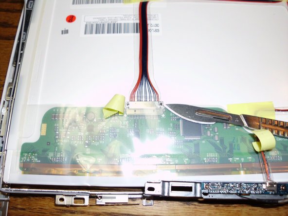

Third photo here... A blade or better, a spudger here to disconnect the cable here. Pry and slide this connection (towards the top of this photo).

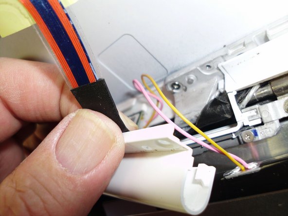

Step 6

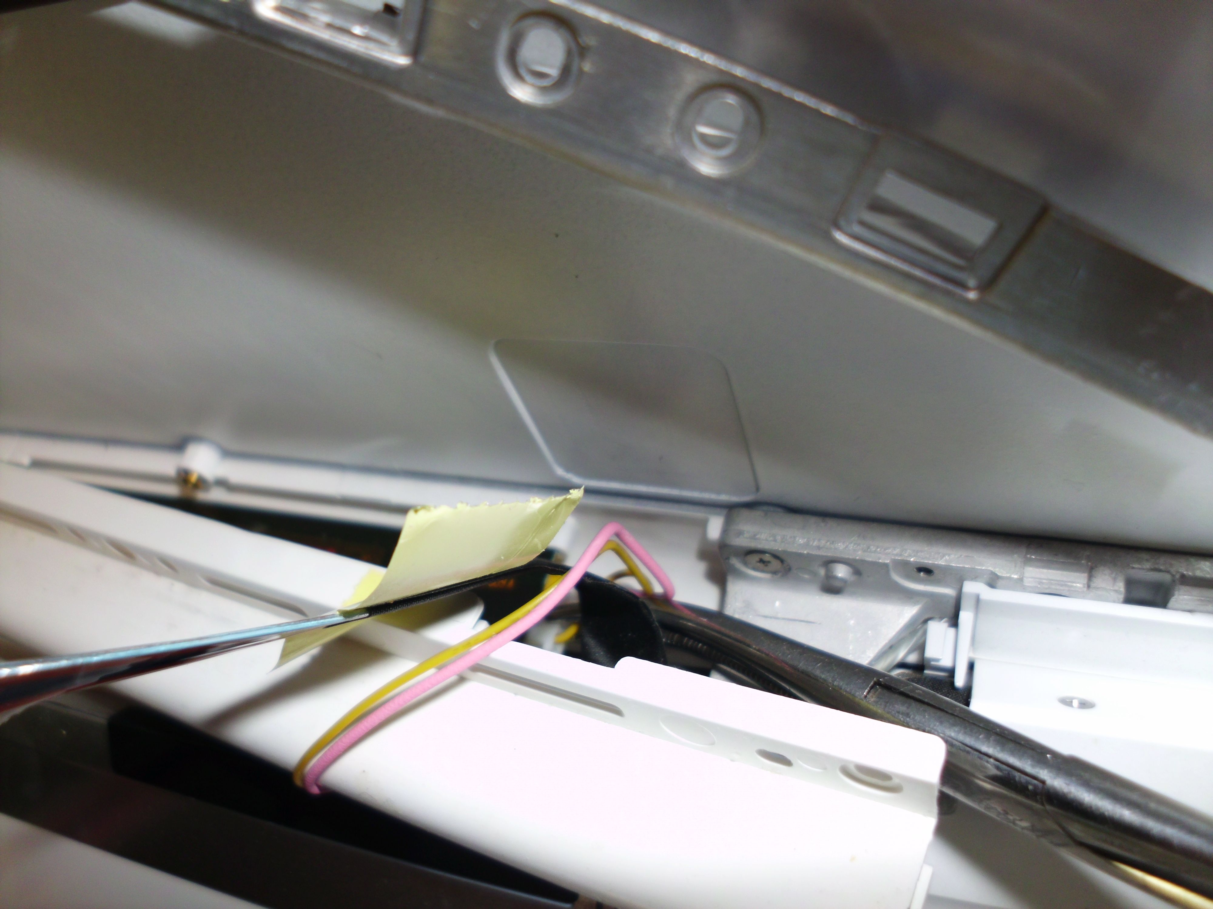

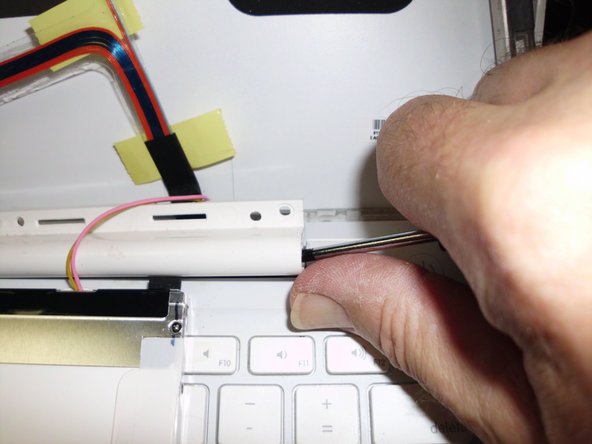

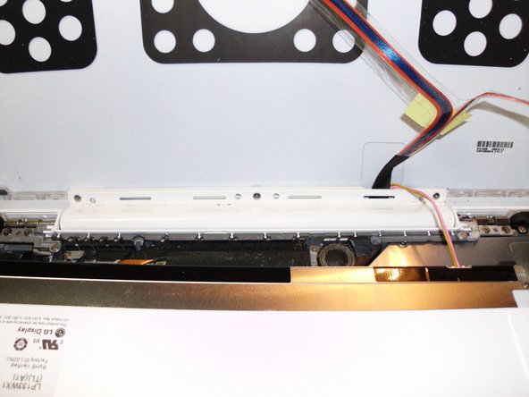

See Step 7 and come back to here. 3 screws must be removed first. Lift clutch cover up slightly
Getting the clutch cover up is going to be the most difficult part. You'll feel like you're going to break it. There are also two little plastic parts on each end of the clutch cover. They're easy enough to remove so you don't use them as a fulcrum. Be careful though - they also tend to fly fast and high when being pried out.

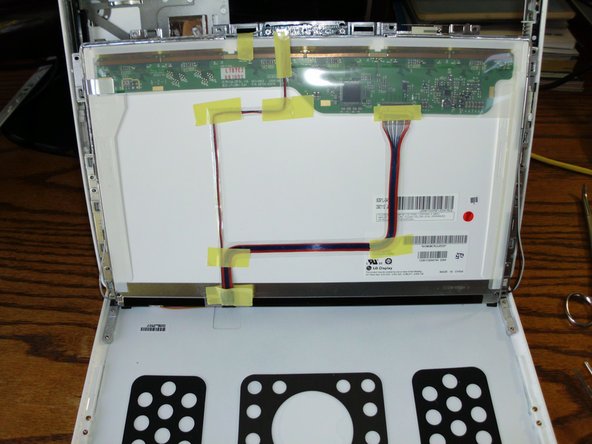

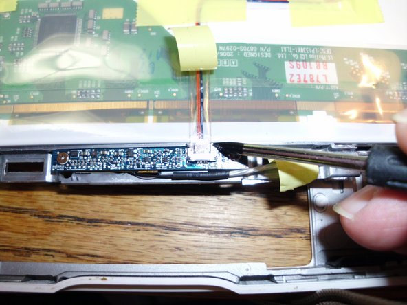

Reveal plug in to inverter board
Use small hemostat or tweezers to grasp end of inverter plug in and pull out.

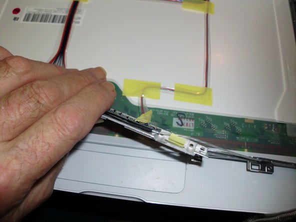

The LCD is now free to be removed.

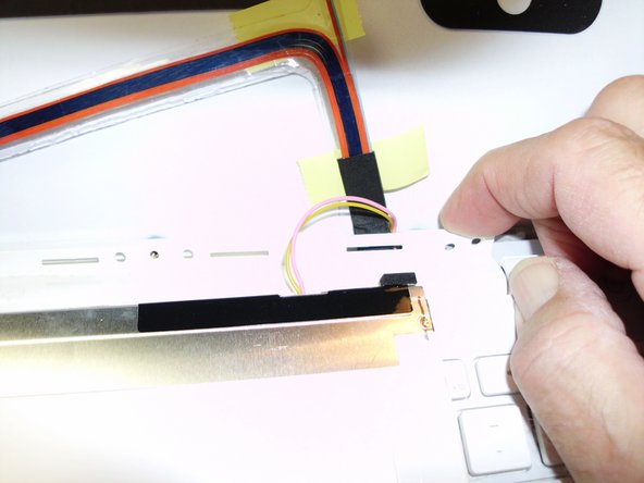

To install an inverter just lift the cover up higher and remove it.
I was able to leave the left end of the clutch cover 'mostly' in place and unplug both ends of the inverter.
When replacing the clutch cover inspect the back. I had both ends 'sticking out' a little and had to break the little plastic tabs to make it flush again - or I could have started over and removed everything to properly replace the clutch cover. On a 5 year-old machine I elected to break plastic tabs off the clutch cover.
