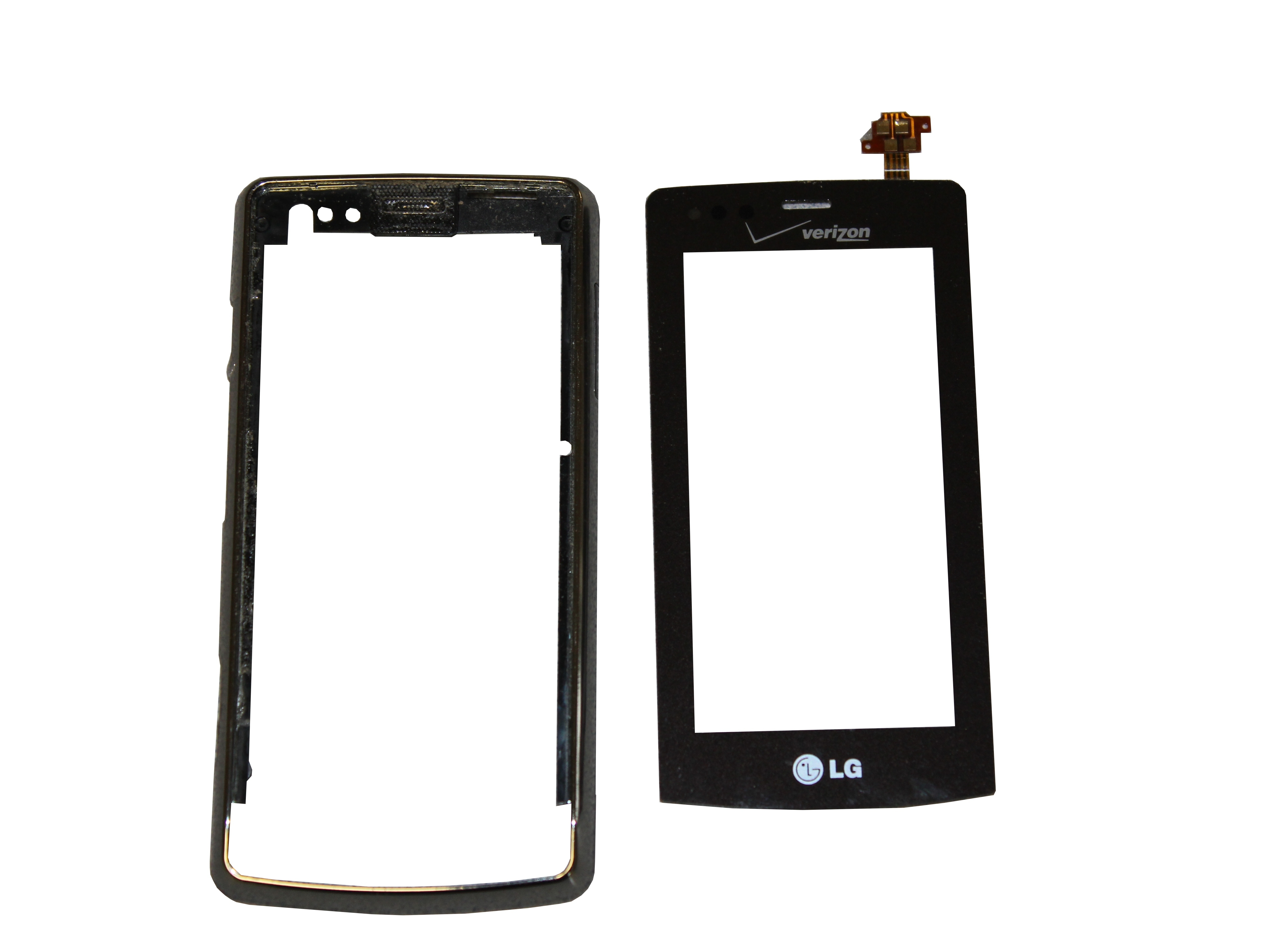

This guide will show you how to replace a cracked touch screen for the LG Versa VX9600.
Also look at the LG Versa VX9600 Teardown for help disassembling your phone.

  • Six Phillips screws holding down the battery housing (Circled in the picture). Unscrew the six screws and put them aside.
Image #1 Image #2
Add Note Edit Step 7  ¶
  • Insert a safe prying tool between the slot between the front screen housing and the battery housing to remove the battery housing.
Image #1
Add Note Edit Step 8  ¶
  • In the bottom right corner of the logic board, disconnect the button connector with tweezers or a prying tool.
