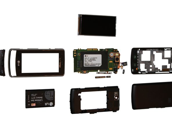

Add Note Edit Step 1 — LG Versa Teardown  ¶
  • Insert wisdom here.
Image #1 Image #2 Image #3

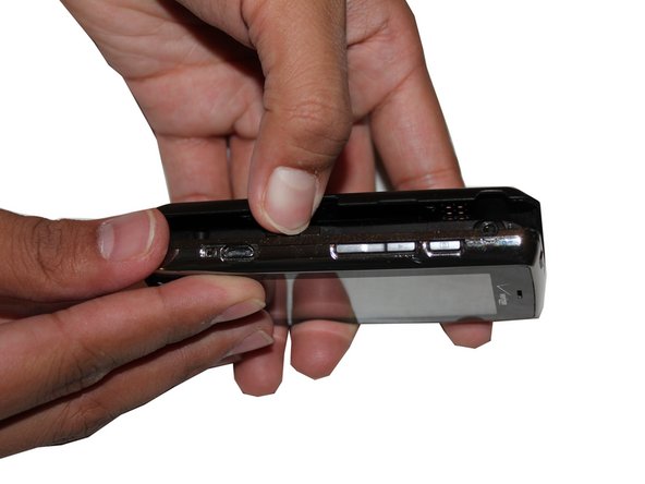

Add Note Edit Step 2  ¶

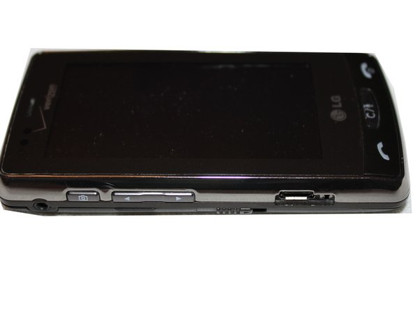

  • LG Versa has a 3" touchscreen with a call, power, and clr button on the front.
  • On left side you will find the volume control buttons and camera button. Also, the charger port.
  • On the other side you will find the microSD or microSDHC slot.

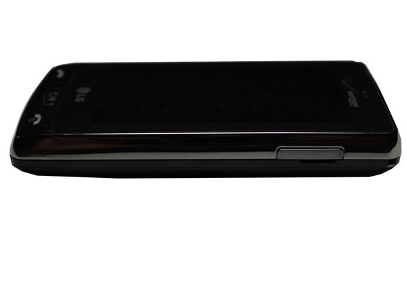

  • On the right hand side of the LG Versa there is a latch to open up the back of the cell phone. Push the latch up and lift off the back of the phone exposing the battery.

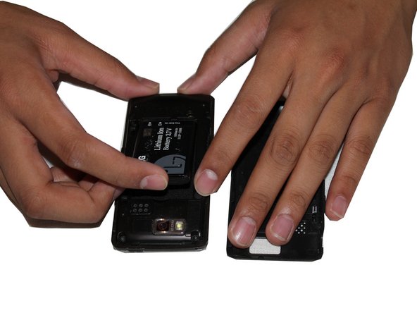

Add Note Edit Step 5  ¶
  • Simply insert your finger in between the slot and the battery and push down and up to remove the battery.
Image #1

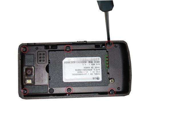

Add Note Edit Step 6  ¶

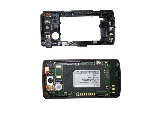

  • Six Phillips screws holding down the battery housing (Circled in the picture). Unscrew the six screws and put them aside.
Image #1 Image #2

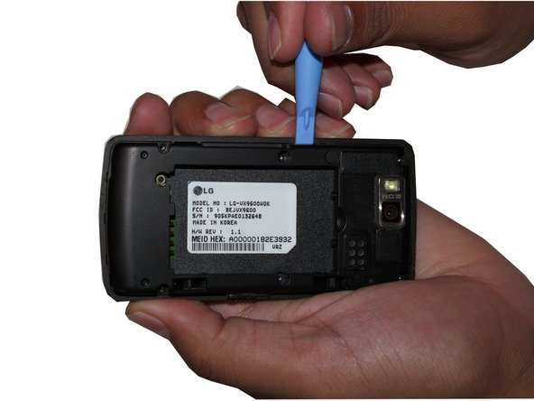

Add Note Edit Step 7  ¶

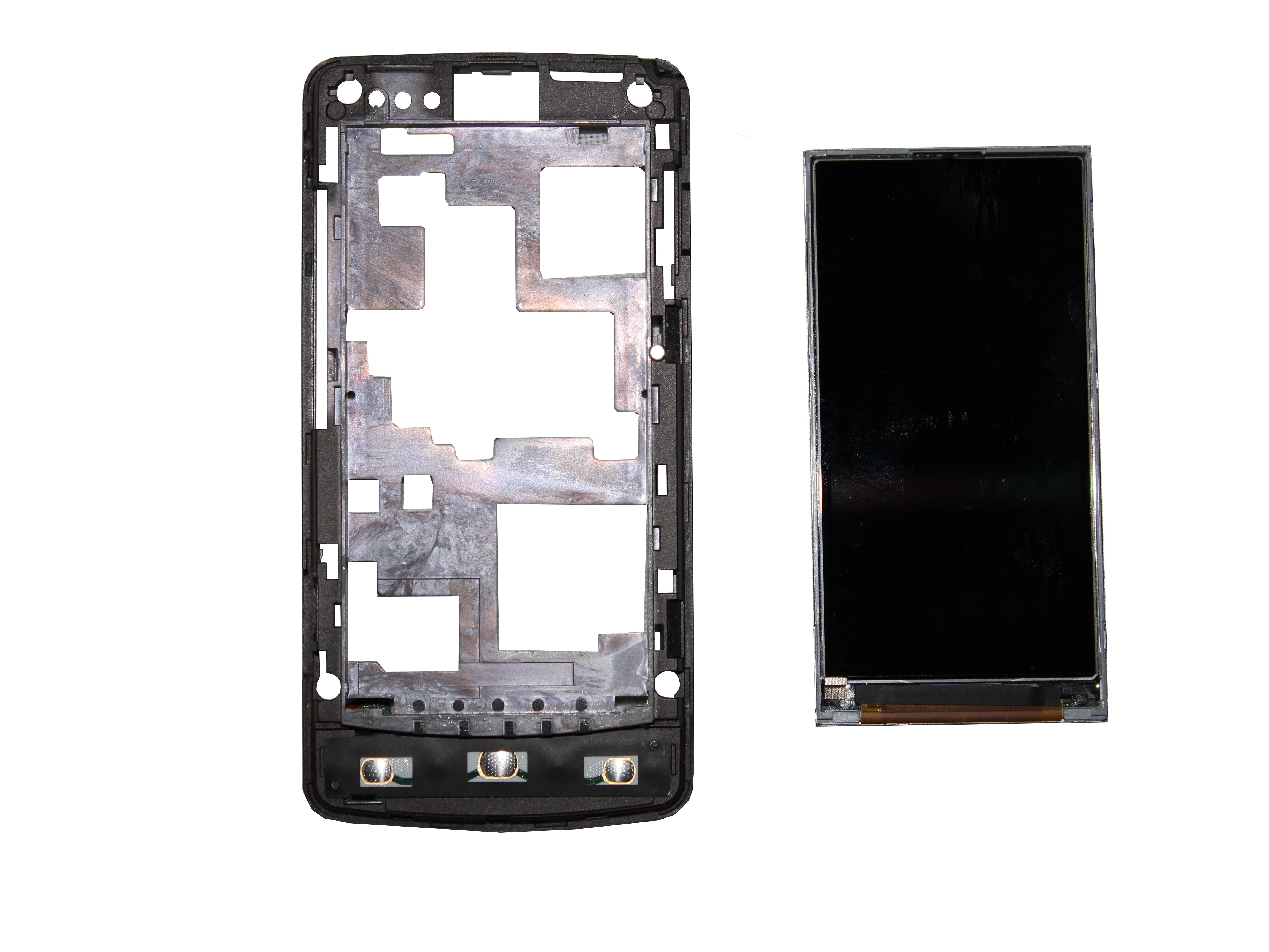

  • Insert a safe prying tool between the slot between the front screen housing and the battery housing to remove the battery housing.
Image #1

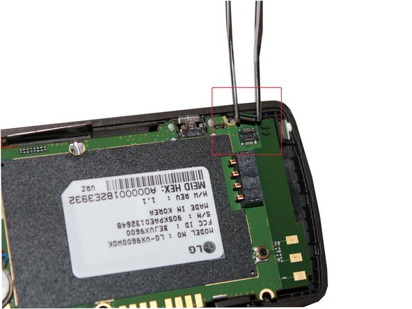

Add Note Edit Step 8  ¶
  • In the bottom right corner of the logic board, disconnect the button connector with tweezers or a prying tool.
