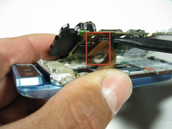

Add Note Edit Step 9  ¶
  • Carefully lift up on the motherboard to see the ribbon cables underneath.
  • Use the spudger to carefully disconnect the ribbon cable from the motherboard.
Image #1

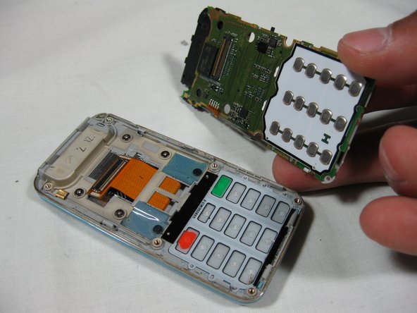

Add Note Edit Step 10  ¶
  • Remove the motherboard from the front casing by lifting straight up.
Image #1

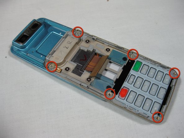

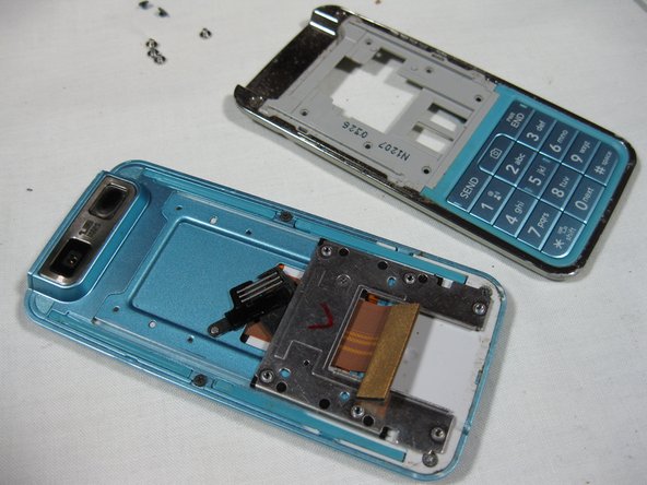

Add Note Edit Step 11 — Keypad Housing  ¶
  • Lay the phone with the screen facedown.
  • The 6 slider screws are visible.
Image #1

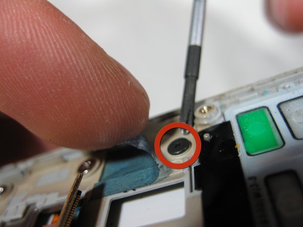

Add Note Edit Step 12  ¶
  • Peel back but don't remove the blue tape to access the 2 center screws.
  • Remove the 6 slider screws with the Phillips #00 screwdriver.
Image #1
Add Note Edit Step 13  ¶
  • Lift the keypad housing away from the slider.
Image #1

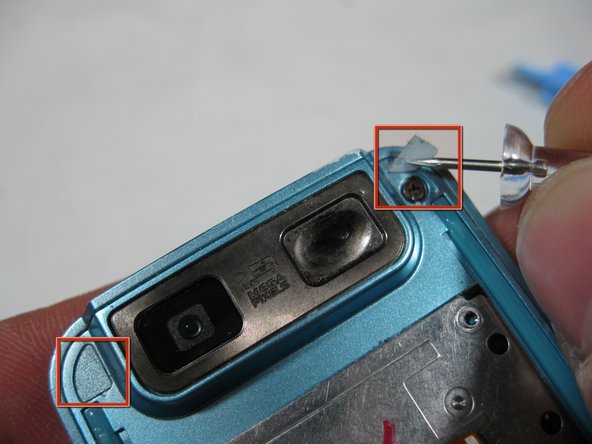

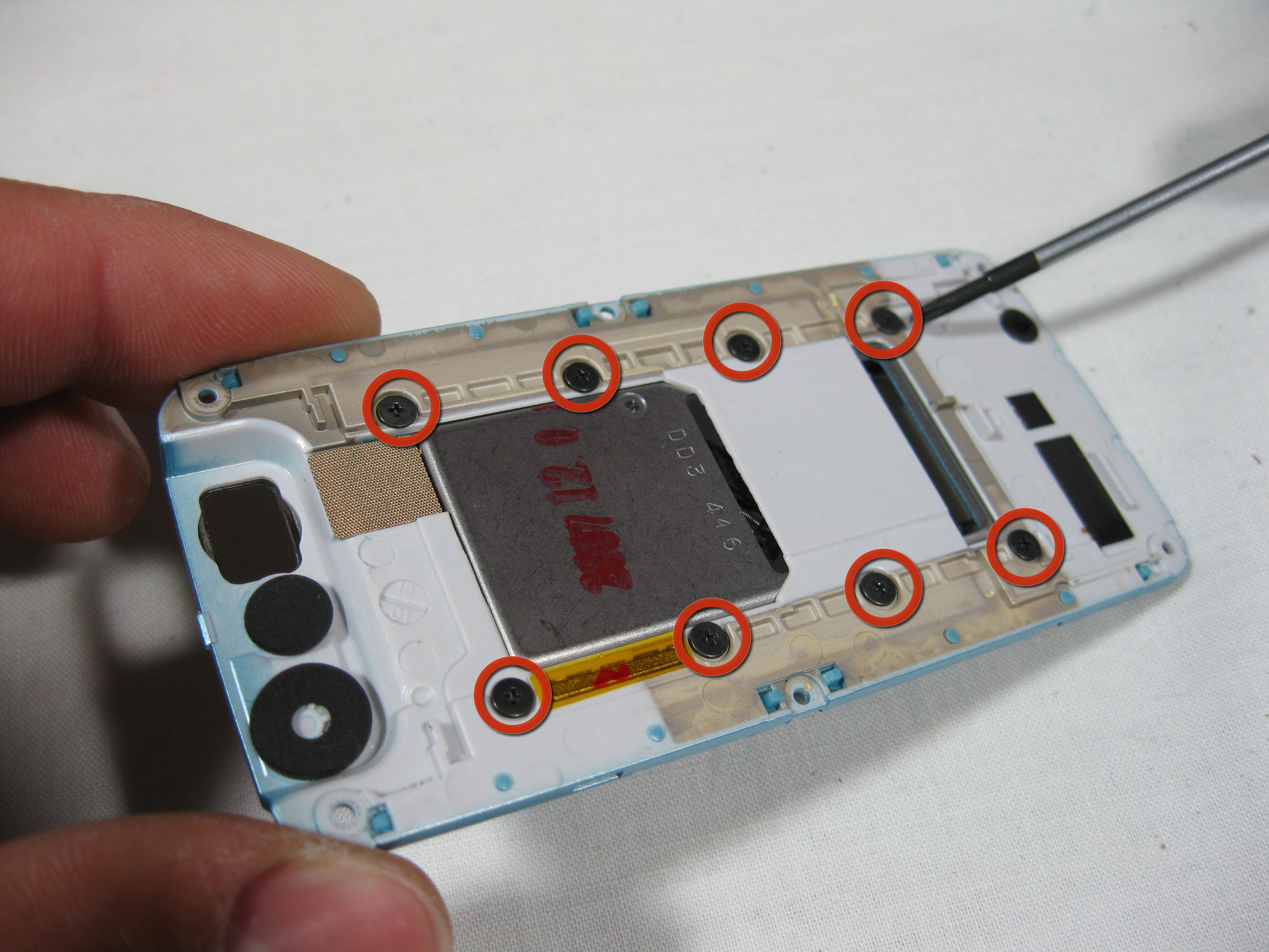

Add Note Edit Step 14 — Front Case  ¶
  • Remove the 2 screw covers next to the speaker with a push pin next to the camera.
Image #1

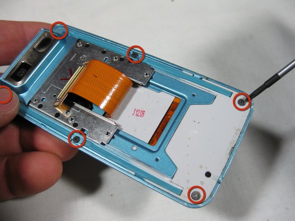

Add Note Edit Step 15  ¶
  • Remove the 6 screws with a Phillips #00 Screwdriver.

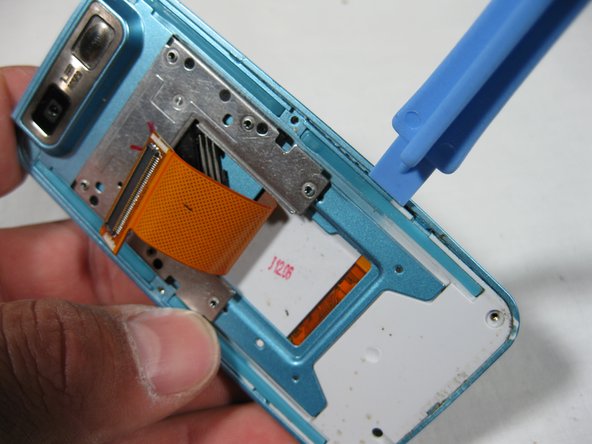

Image #1
Add Note Edit Step 16  ¶
  • Use the ipod opening tool to pry the screen casing and the slider mechanism apart from each other.
