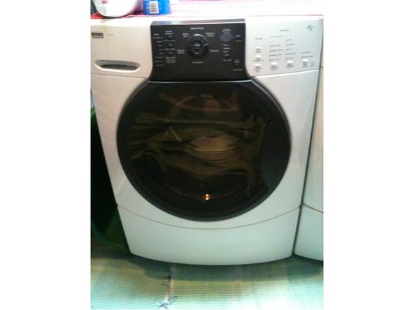

Repairing Kenmore Elite HE3 Washer Control Board Relays
  1. Repairing Kenmore Elite HE3 Washer Control Board Relays, Open the locked door manually: step 1, image 1 of 3 Repairing Kenmore Elite HE3 Washer Control Board Relays, Open the locked door manually: step 1, image 2 of 3 Repairing Kenmore Elite HE3 Washer Control Board Relays, Open the locked door manually: step 1, image 3 of 3

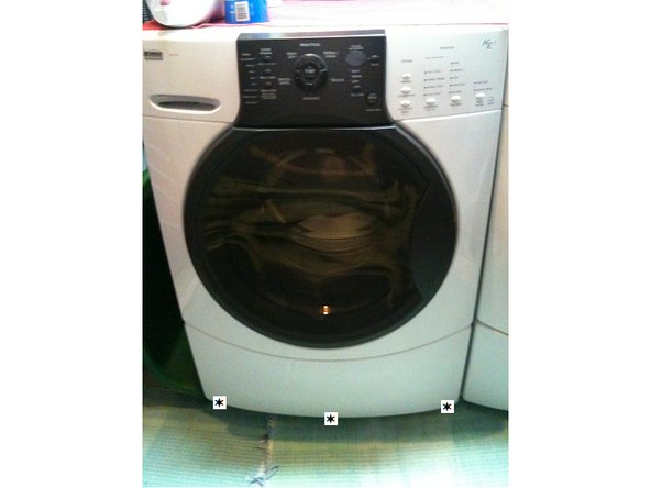

    • The F-DL door lock error may indicate an inability to open the door, trapping your damp clothes inside. This first step is optional, and explains how to release the door lock manually.
    • Unplug the washing machine!
    • Using a Torx T20 screwdriver or a 9/32" socket wrench or driver, remove the three screws along the bottom front of the washer, and remove the panel.
    • Reach up inside the right hand side behind the door latch, and you should be able to feel a 1" diameter ring. Grab the ring with your fingers, and pull it down toward the floor. It will release the door lock.

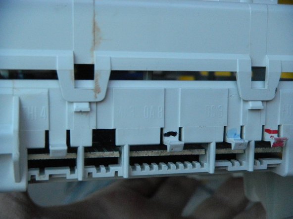

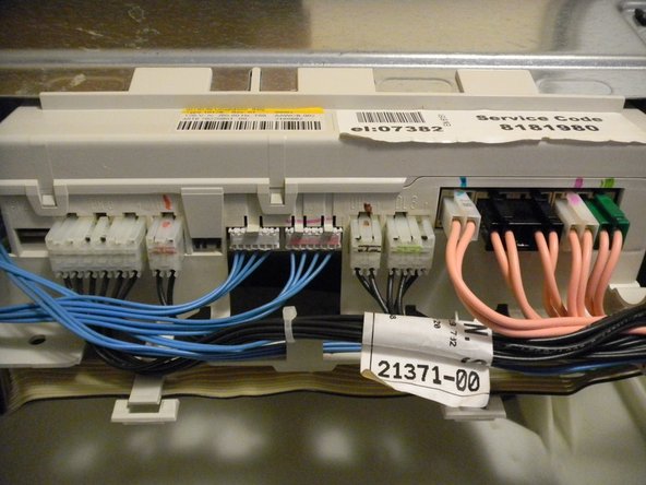

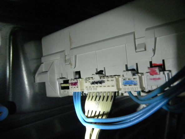

  4. Repairing Kenmore Elite HE3 Washer Control Board Relays, Mark the wires: step 4, image 1 of 2 Repairing Kenmore Elite HE3 Washer Control Board Relays, Mark the wires: step 4, image 2 of 2
    • Mark the wires and note how the cables are routed, so you can return them to their original routes after disassembly.
    • Either apply wire labels, or take a fine-tipped permanent marker and as you disconnect each connector mark it with the two letter name of the mating socket, which you will find stamped on the plastic of the control unit's housing. A flashlight will help reading the letters along the left side of the control unit.

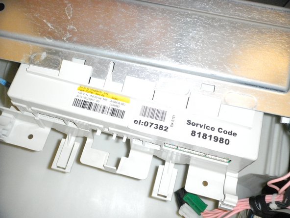

  5. Repairing Kenmore Elite HE3 Washer Control Board Relays, Access the main controller board: step 5, image 1 of 3 Repairing Kenmore Elite HE3 Washer Control Board Relays, Access the main controller board: step 5, image 2 of 3 Repairing Kenmore Elite HE3 Washer Control Board Relays, Access the main controller board: step 5, image 3 of 3
    • Remove the control unit by very gently prying up the two outside tabs that hold it to the top crossbar with a flat bladed screwdriver and simultaneously sliding the control unit toward the front of the washer.
    • Only the outer two tabs have a locking notch holding the control unit to the crossbar. The middle tab is there just for support.
    • Open the gray housing of the control unit by gently prying the side tabs open.
    • Remove the circuit board the same way, by gently prying open the tabs holding it down.
  6. Repairing Kenmore Elite HE3 Washer Control Board Relays, Circuit board repair and replacement: step 6, image 1 of 1
    • There are three or five relays on the circuit board. K6 is an OMRON G2RL-1A-E, 12VDC, and rated to switch 16A at 250 VAC. K1 and K4 are both OMRON G5LE-1-VD, 12 VDC, and rated to switch 10A at 250 VAC.
    • K1 controls the door lock solenoid. I found the contacts on it were blackened due to arcing. I didn't bother to find out what the other two relays do, but I cleaned them all anyway. Another repairer says that only K1 & K4 were inspected; K1 had significant contanimation & K4 looked new by comparison. Treated K1 only with all problems resolved!
    • Unsolder one relay at a time from the circuit board, clean or replace it, then solder it back in position.
    • To unsolder a relay, start by heating the solder at one end of the relay, and gently pull the relay's plastic package with a finger on the hand holding the circuit board. Use solder wick to remove excess solder. After making progress at one end, switch to desoldering the contacts at the other end of the relay in the same fashion.
    • To clean a relay, open its plastic case. Blow out the dust and grit. Dress the relay contacts with a small piece of folded-in-half 200-400 grit sandpaper, treated with contact cleaner. Replace the plastic case on the relay.
    • Solder the relay back onto the circuit board, and repeat with the next relay until all relays are cleaned and/or replaced.
