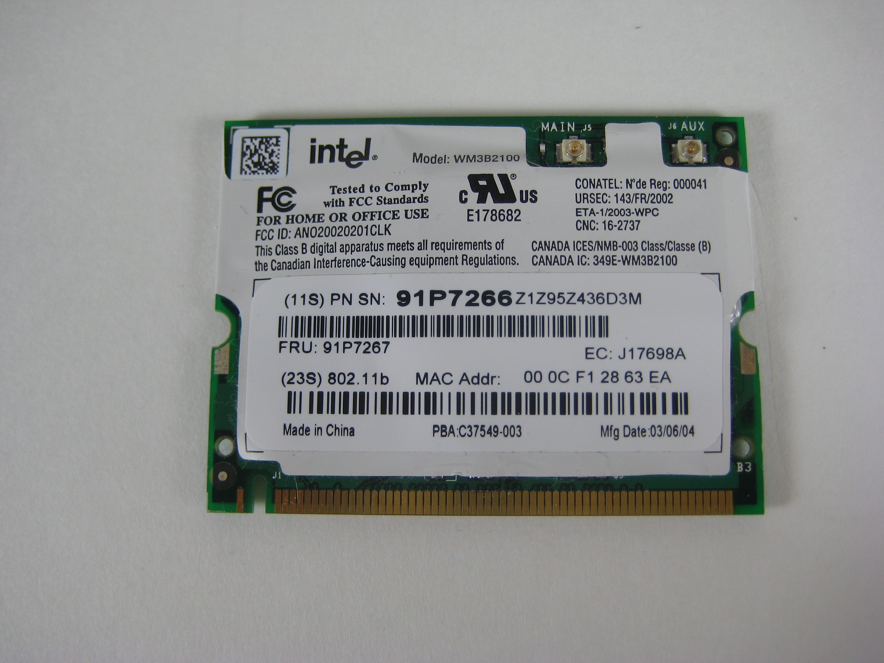

This is a step by step guide for replacing/repairing the wireless network card of an IBM ThinkPad T41 laptop. It will aid you in taking apart your laptop to reach the wireless network card.
  • Add Note x
  • x 6
This simple repair guide will aid you in taking apart your IBM ThinkPad T41 laptop to reach and replace its wireless network card.
