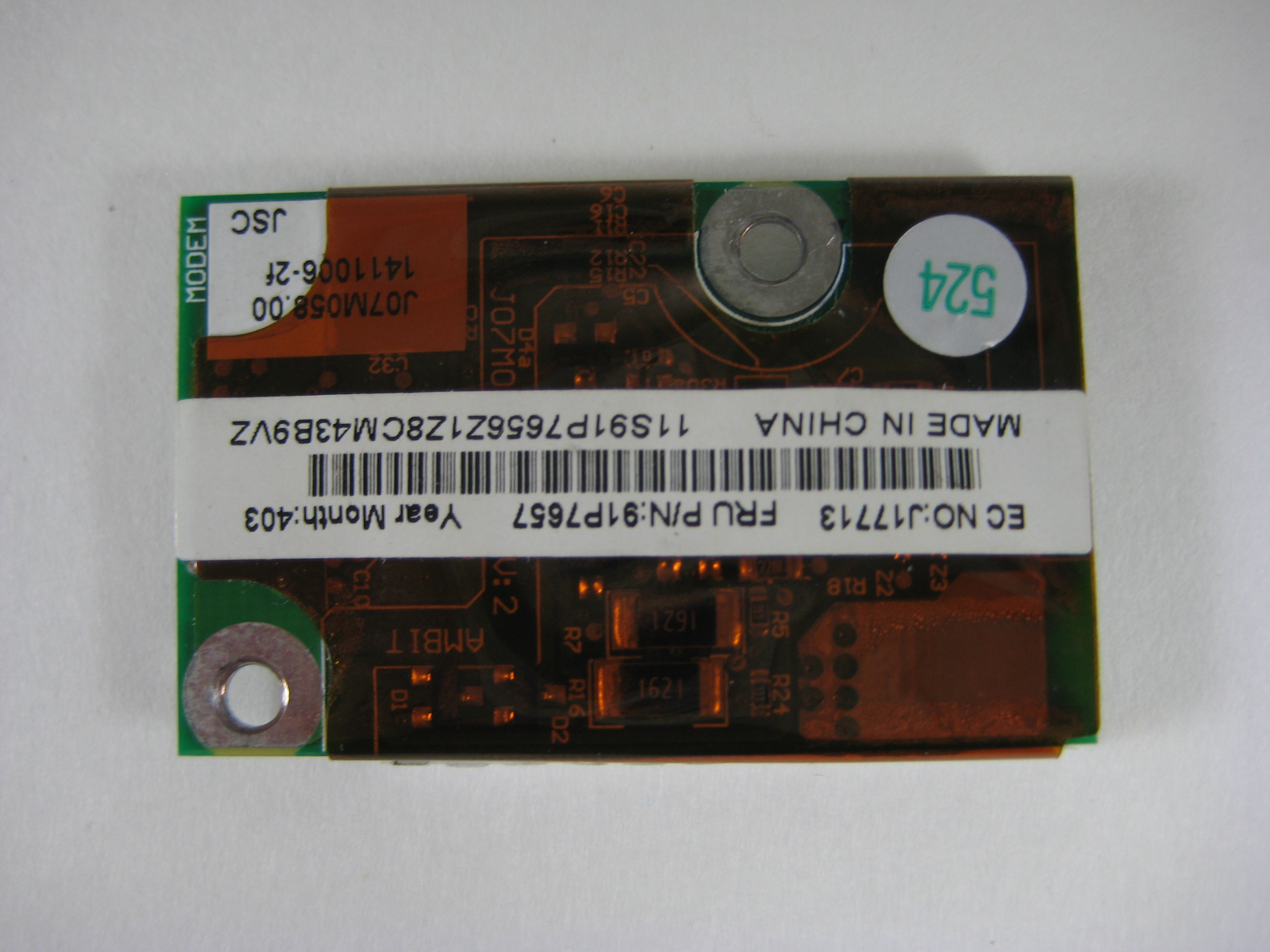

Add Note Edit Step 22 — Modem  ¶
  • Remove the three screws holding down the modem in the upper left corner of the laptop.
Image #1
Add Note Edit Step 23  ¶
  • Lift the modem up, unplugging it from the motherboard as you lift.
Image #1 Image #2
Add Note Edit Step 24  ¶
  • Pull out the wire that connects the modem to the screen.
  • Unplug the other cable that attaches the modem to the motherboard
