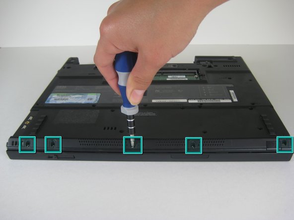

Image #1
Add Note Edit Step 6  ¶
  • Unscrew the five screws that were hidden by the stickers.
Image #1
