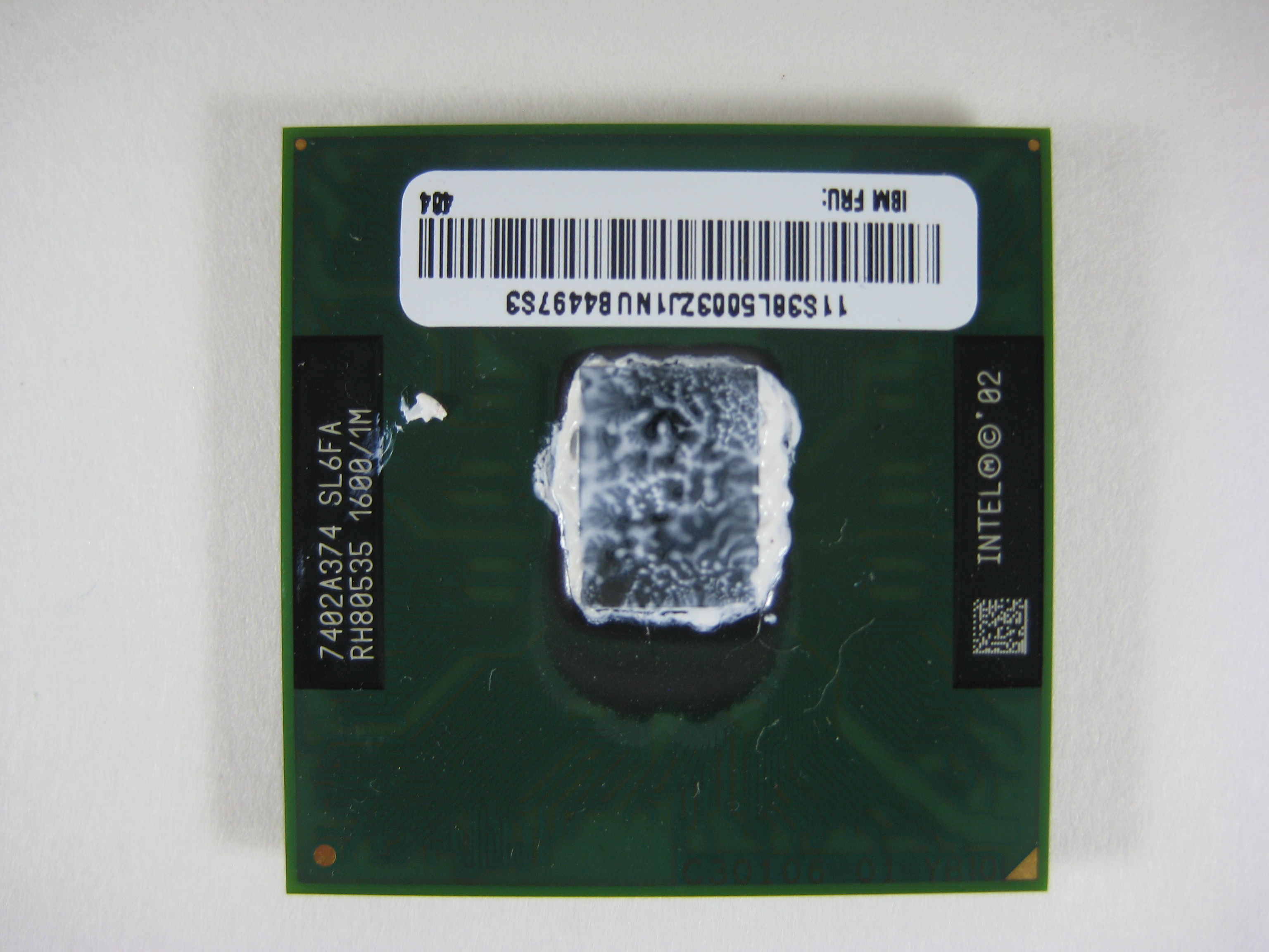

This is a step by step guide for replacing/repairing the CPU of an IBM ThinkPad T41 laptop. It will aid you in taking apart your laptop to reach the CPU.
This repair guide will aid you in taking apart your IBM ThinkPad T41 laptop to reach and replace its CPU.
