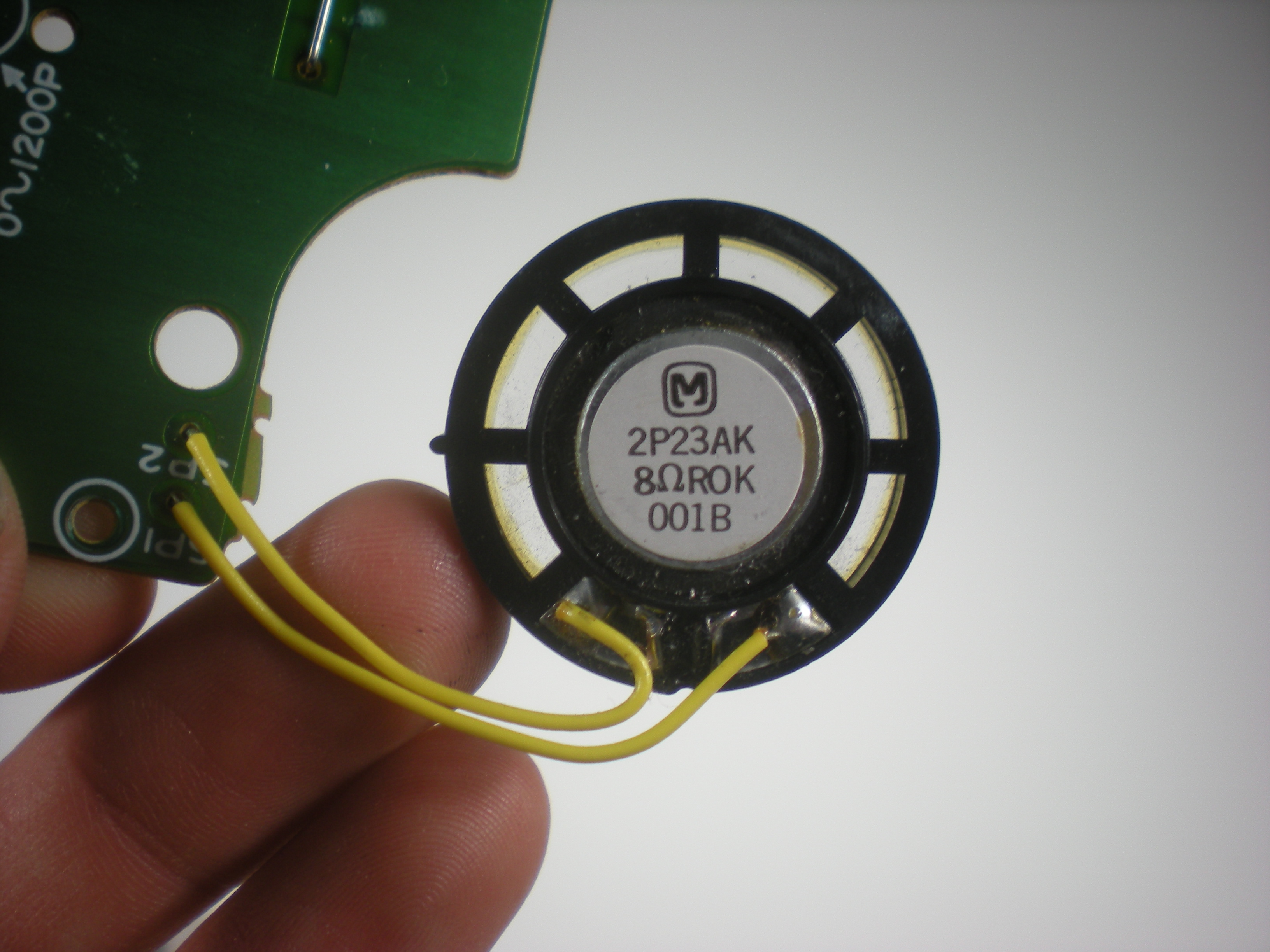

How to replace the speaker in a first-gen Game Boy system.
How to access and replace the speaker on the front panel of a Game Boy system.
Relevant Parts
  • 8-ohm mini speaker Be careful with the replacement part. I have not been able to verify the specific stats for the speaker, so I would recommend asking an electronics professional. If you find this info, please edit them into this guide!
