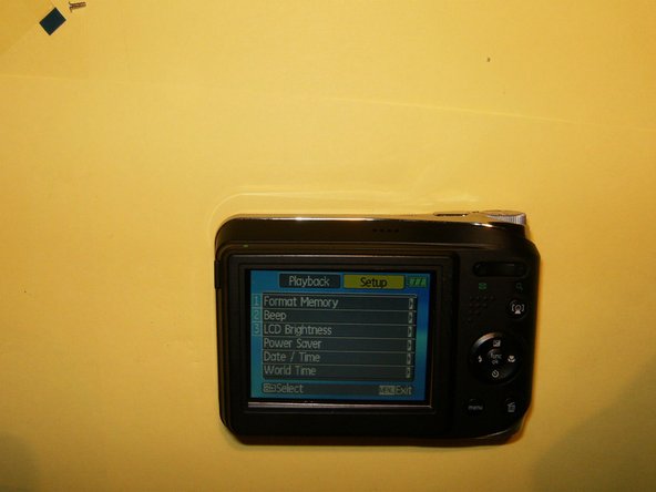

I got two of these for $4.00 and the only thing they needed was the LCD replacement. $12 for the LCD and 15 minutes time are the cost. Cameras are working great :-) love the Kitchen Junk Drawers
  • Author: oldturkey03
  • Time required: 15 to 30minutes
  • Difficulty: Moderate
The repair of the LCD is straight forward. No special skills or knowledge are required.

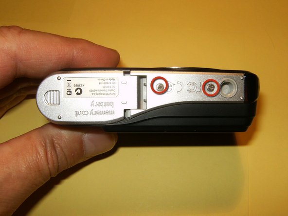

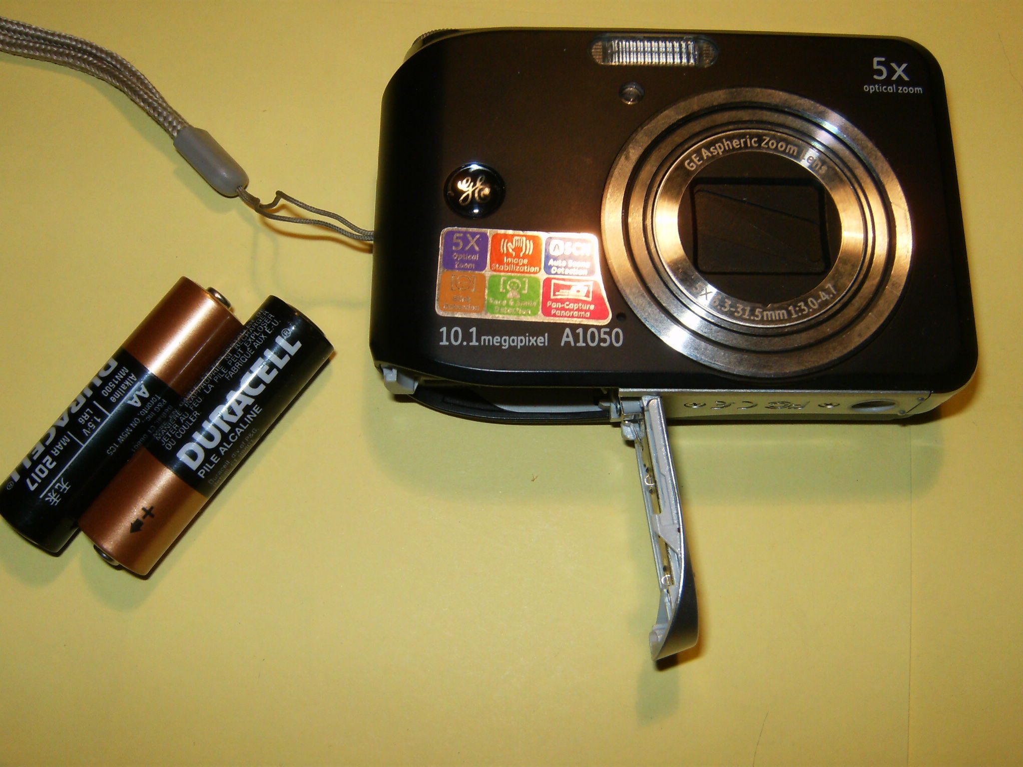

  • Remove the batteries, hand strap, and memory card if so equipped.
  • Remove the two Phillips screws from the bottom.

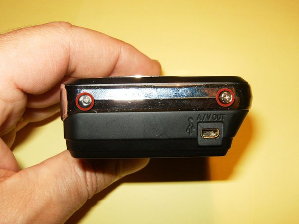

  • Remove the two Phillips screws from the left side.

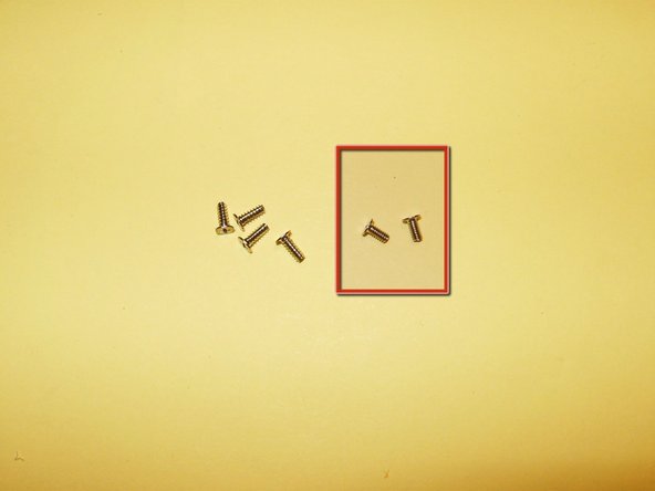

  • Remove the two screws from the right side.
  • The two screws from the left side are shorter than the ones from the right. Keep those separated.

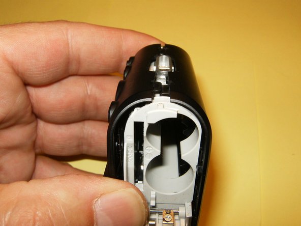

  • Start splitting the case from the battery compartment to the sides. No special tool is needed to split the case.

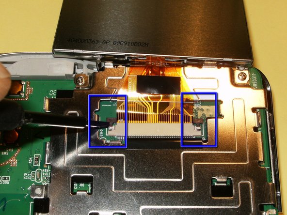

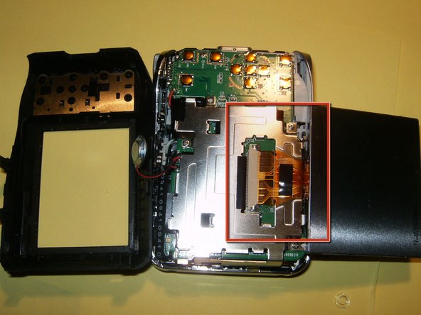

  • Do not remove the back side of the case, just flip it over. The speaker is connected by wires to the main body, but positioned in the back case.
  • Flip the LCD to the bottom. You can not yet remove it, because it is still attached to the board.
  • The LCD cable is held into the connector via some compression clips. Move both ends carefully away from the connector, toward the LCD.
    • The clips only move about an 1/8 of an inch. Be careful not to use too much force.

  • After exchanging the LCD for a new one, and after reassembling your camera, you should have a working LCD.
