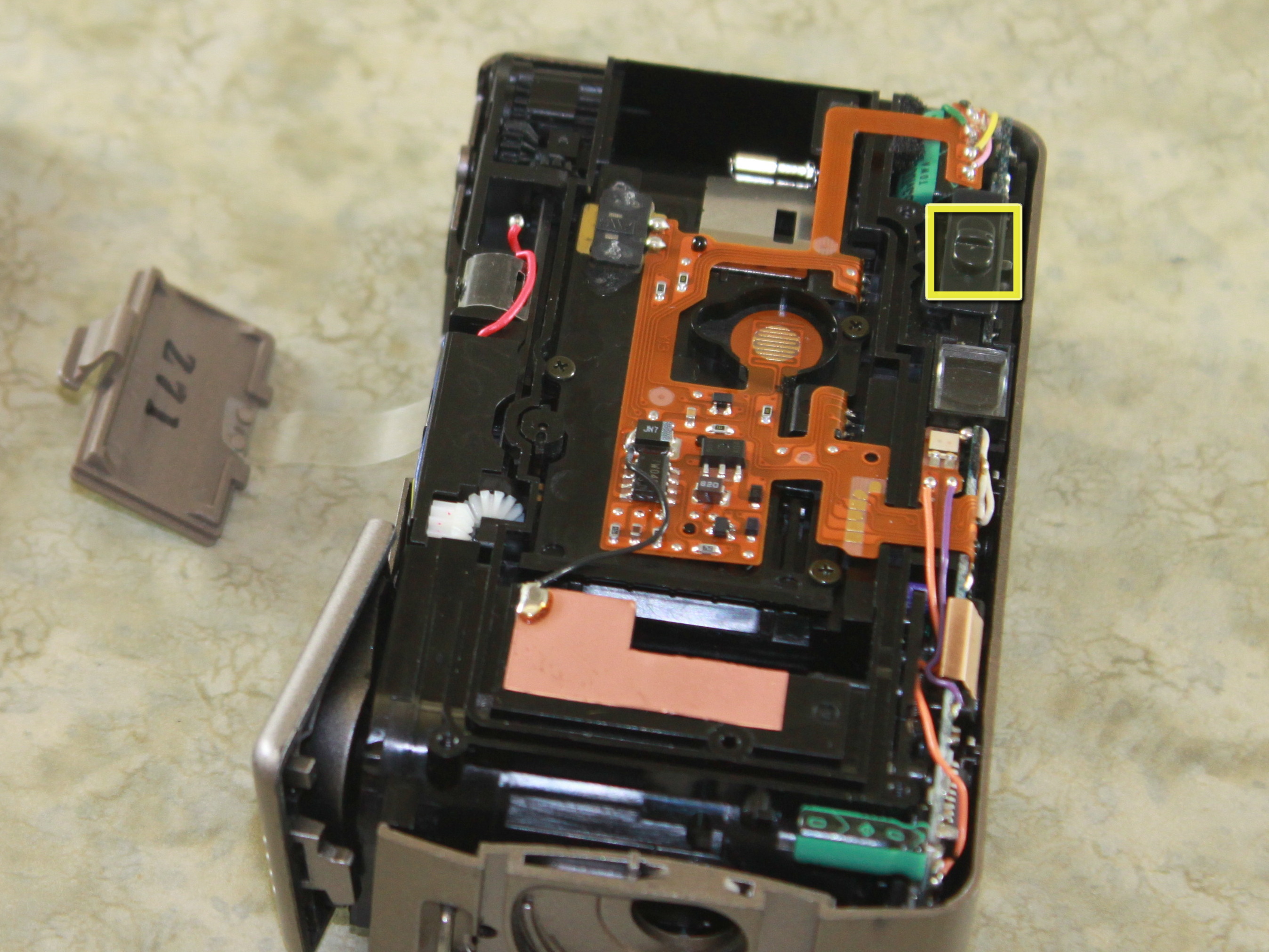

The following guide will help you to fix the CHP Mode Switch by taking off the back cover and cleaning around the switch.

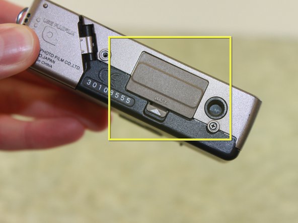

Add Note Edit Step 2  ¶
  • Locate the battery door.
Image #1
Add Note Edit Step 3  ¶
  • Locate the latch on the battery door marked by the word "BATT." Use your finger to pry it open.

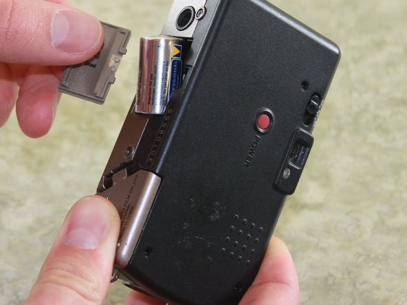

Add Note Edit Step 4  ¶
  • Remove the battery from the camera by pulling the battery door outwards.
