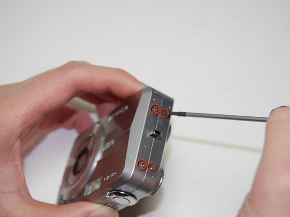

Add Note Edit Step 1 — Motherboard  ¶
  • Remove the four screws on the side with the speaker.

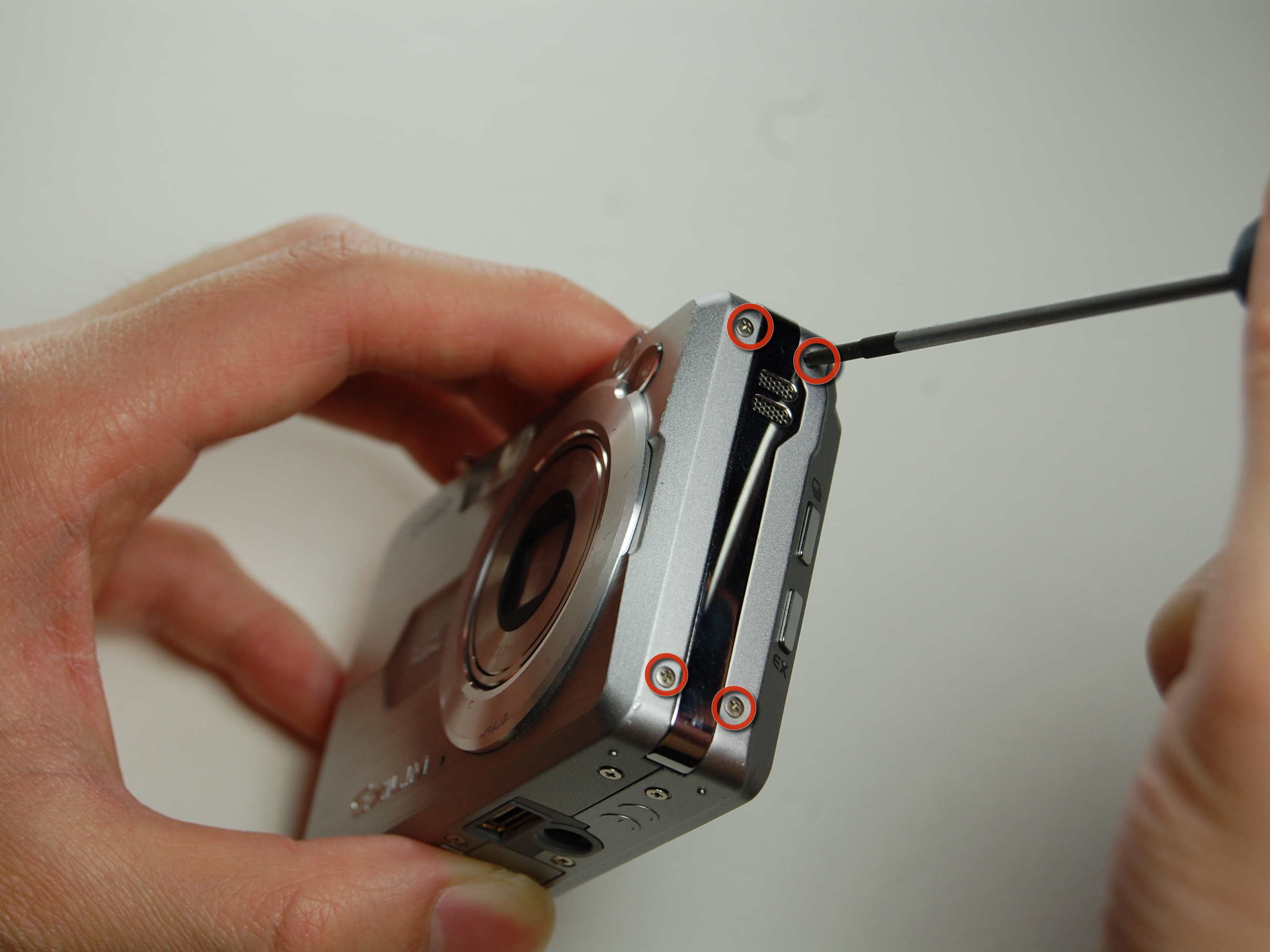

Image #1
Add Note Edit Step 3  ¶
  • Remove the four screws on the side opposite of the speaker.

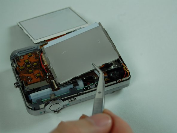

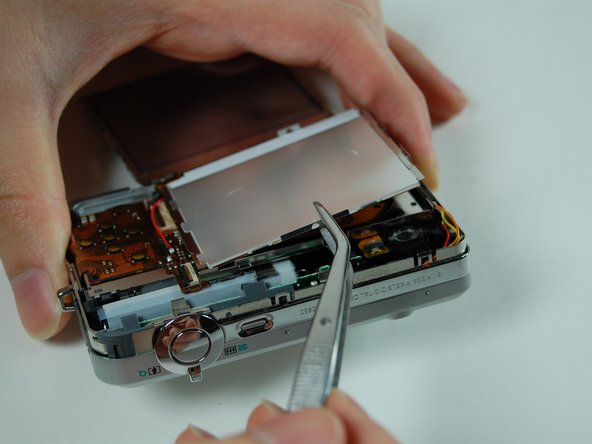

Image #1 Image #2 Image #3
Add Note Edit Step 5  ¶
  • Pry apart the top casing using tweezers.
  • Set the top casing aside.
  • Note: Bottom left screw on board is orange and the longest.

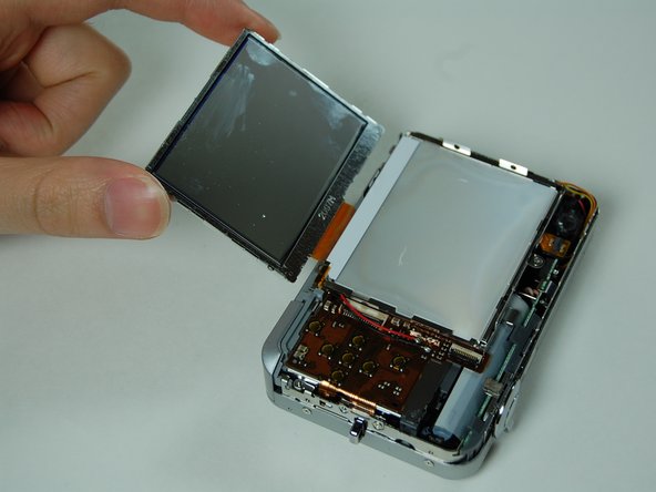

Add Note Edit Step 6  ¶
  • Use tweezers or prongs to pry the LCD screen off from the opening.
  • Note: The bottom of the LCD screen is attached to the frame by a few pieces of black tape.

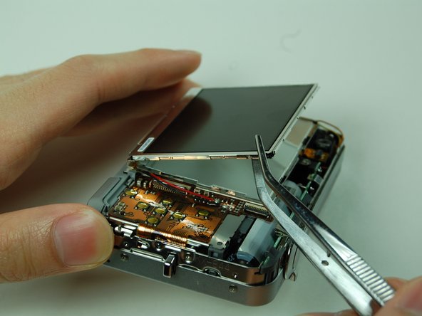

Image #1 Image #2
Add Note Edit Step 7  ¶
  • Lift up the LCD screen, slowly move it to the other side.
