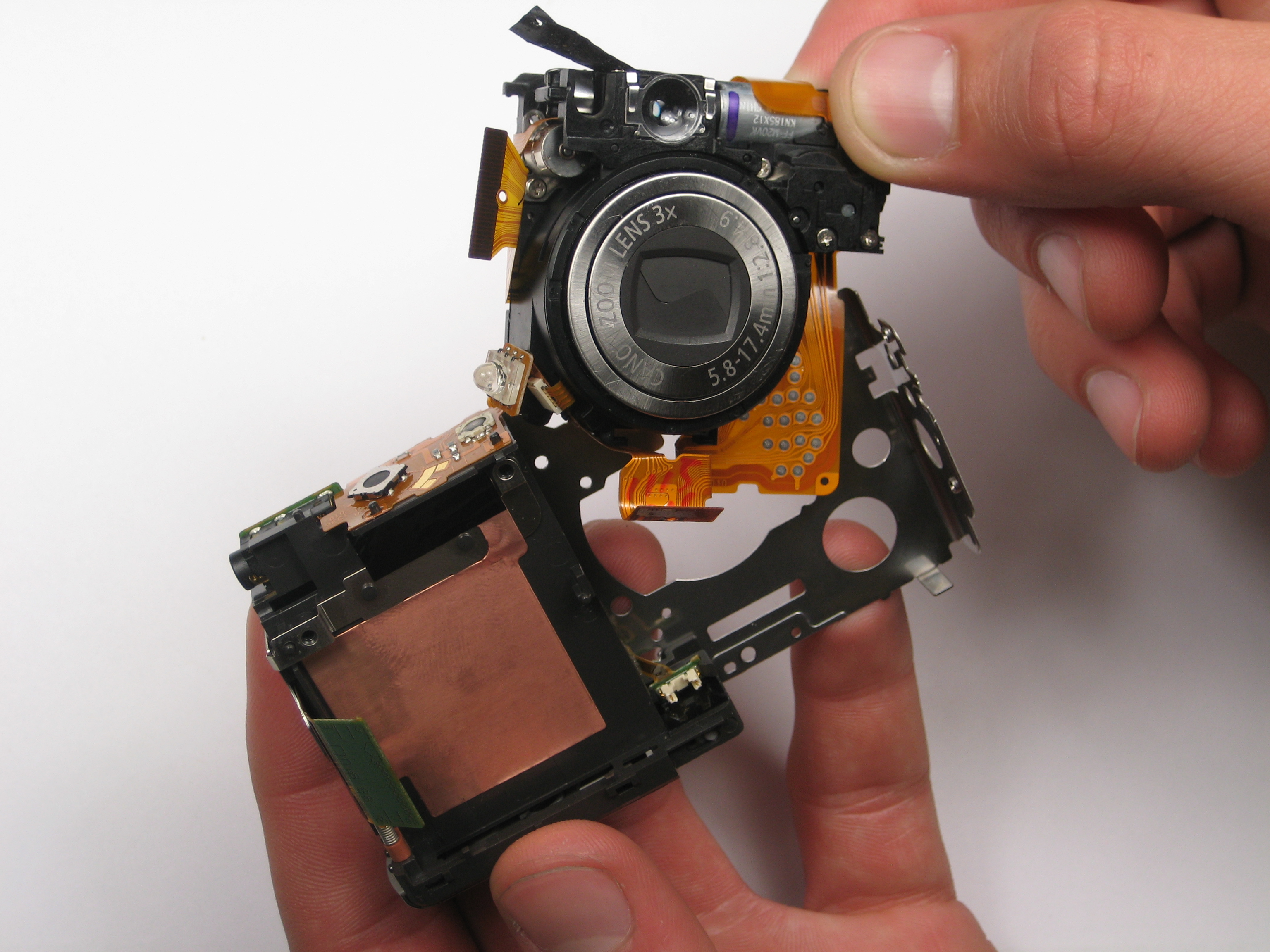

Add Note Edit Step 4  ¶
  • Take hold of the inside of the camera, and gently pull away from the back casing.

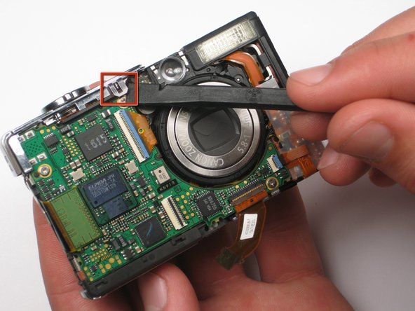

Add Note Edit Step 8  ¶
  • Lift up the metallic-colored clip with the spudger to remove the shutter panel.
