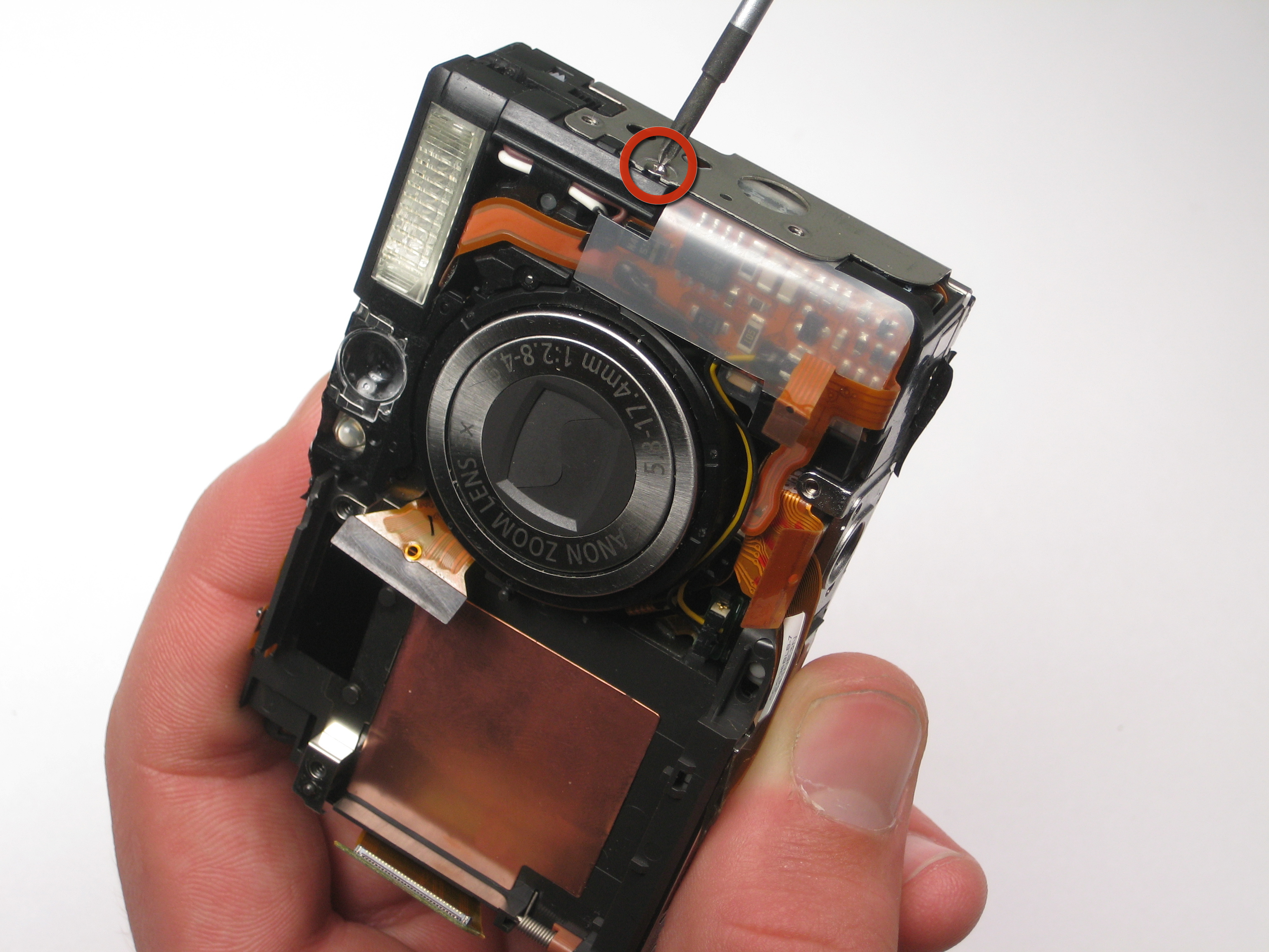

Add Note Edit Step 7 — Logic Board  ¶
  • Remove the LCD cable by gently prying the hinge open with a spudger or your finger. The cable should easily slide out.
Image #1
Add Note Edit Step 8  ¶
  • Lift up the metallic-colored clip with the spudger to remove the shutter panel.
