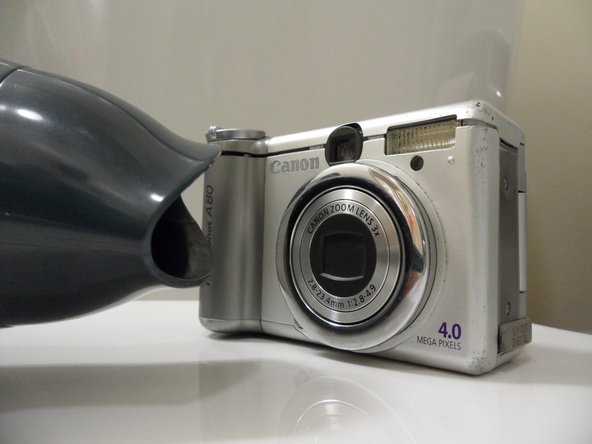

This guide includes four methods to repair a lens that has stopped extracting or "E-18" error.
  • Author: Tim
  • Time required: 5 minutes
  • Difficulty: Very easy

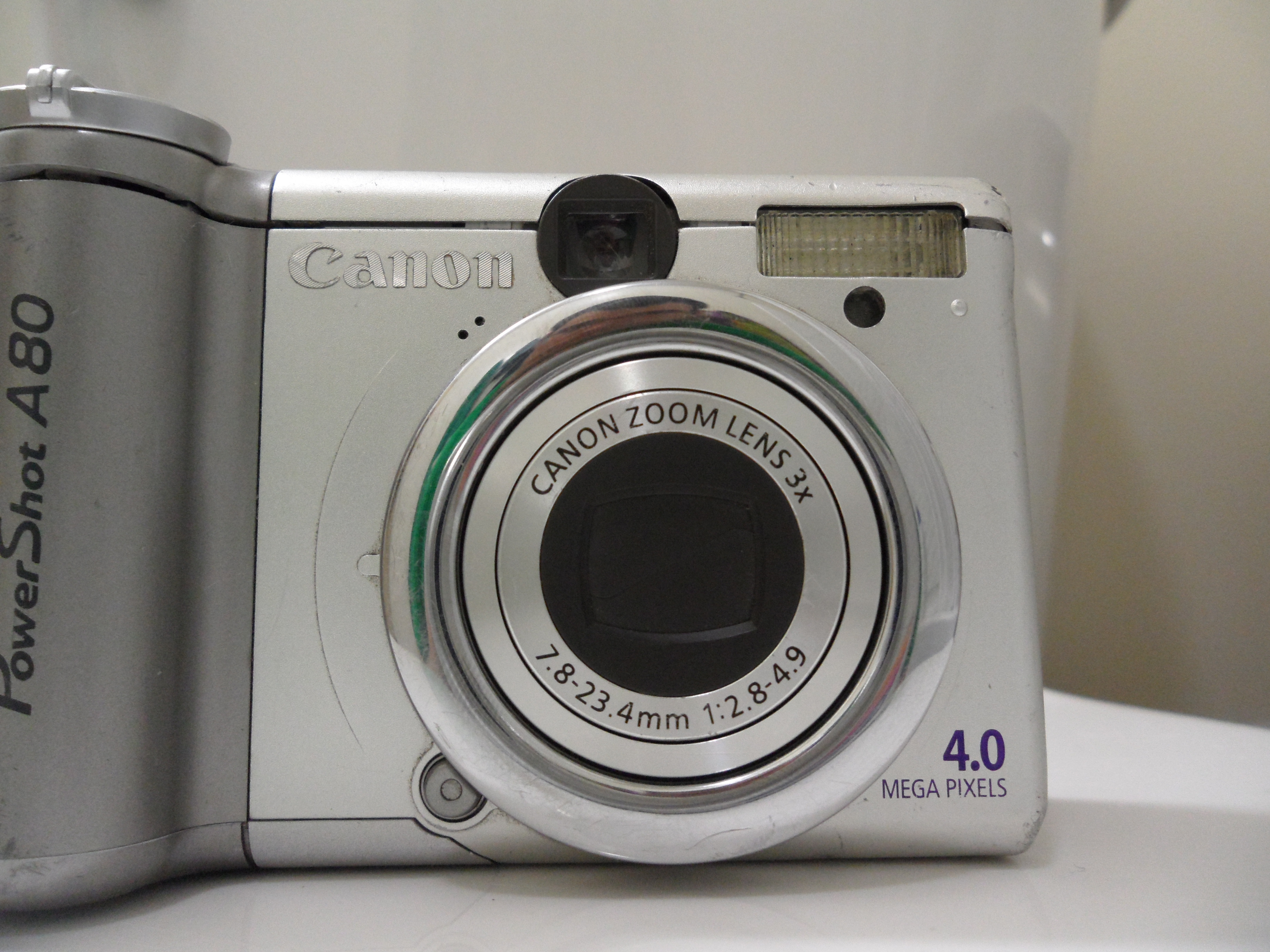

Canon "E-18 error" happens when the lens gets stuck in the extended position. The LCD will display a little E-18 in the lower-left corner and start beeping.
Image #1
Add Note Edit Step 1 — Lens  ¶
  • Place camera on its back on top of a table with the lens facing upwards.
  • Press and hold down the power button, and simultaneously press down the shutter button.
Image #1
Add Note Edit Step 2  ¶
  • Remove the batteries from the camera, wait a few minutes.
  • To open the battery cover slide the black lever on the underside of the camera and pull the cover toward the front.
  • Put in a fresh set of batteries, close the cover and turn it on.
Image #1
Add Note Edit Step 3  ¶
  • Use a hair dryer in "no heat" setting to blow air in the gaps between the lens.
