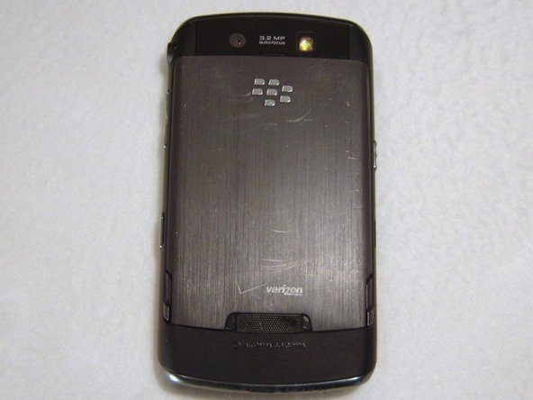

  • Turn your Blackberry Storm 9500 onto its back side, and remove the battery door & battery.
Image #1

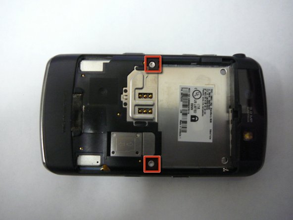

Add Note Edit Step 2  ¶
  • Remove the 2 screws (T6) under the battery compartment they are located as shown in red.

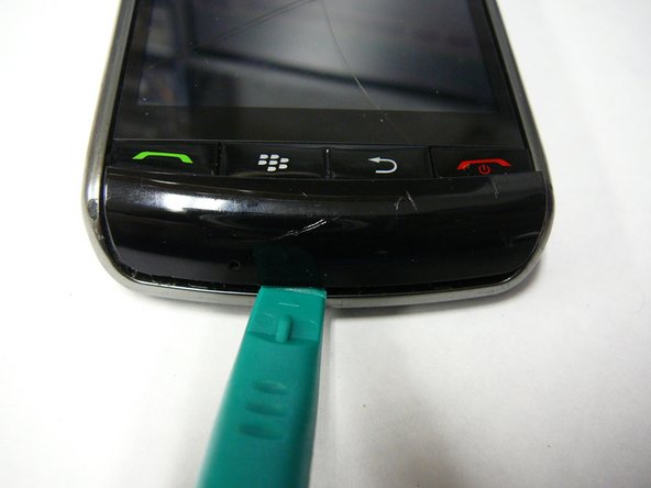

  • Turn the Blackberry Storm 9500 around and pry off the microphone cover at the top using a safe pry tool.
Image #1

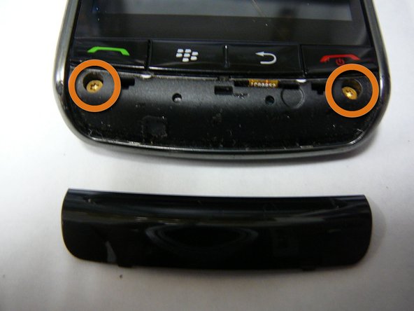

Add Note Edit Step 4  ¶
  • Remove the two screws(T6) as shown.

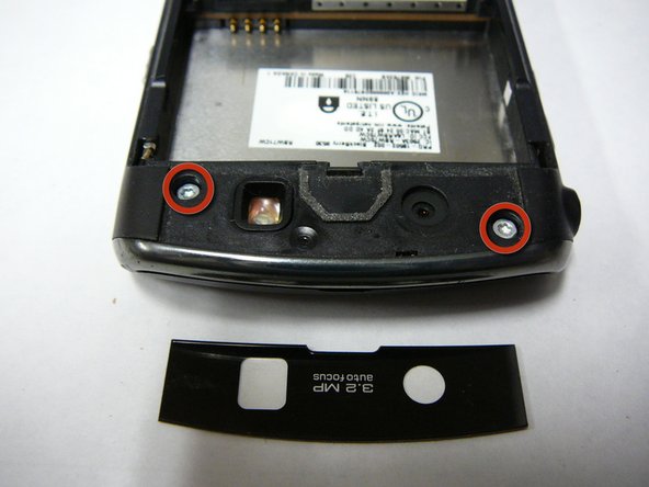

Add Note Edit Step 5  ¶

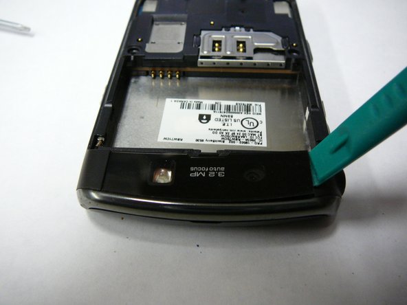

  • Flip it back over to the back of the phone, and remove the plastic lens on top of the camera & flash. This is held in place by some adhesive, so use a safe pry tool to remove as shown.
Image #1
Add Note Edit Step 6  ¶
  • Once the plastic piece is removed, unscrew the two torx screws underneath it.

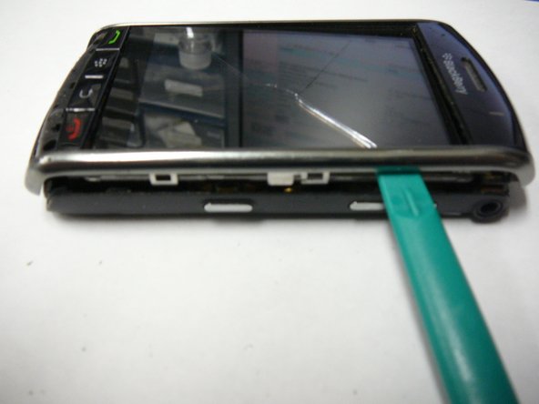

Add Note Edit Step 7  ¶

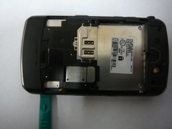

  • Now use a safe pry tool, and go along the edges of the phone to release the clips to open the housing. There are a total of 6 clips, 3 on each side.

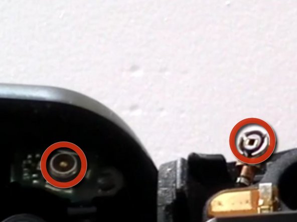

  • There is a small cap connection that connects the antenna to the logic board as pictured.
Image #1

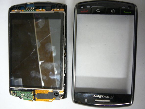

Add Note Edit Step 8  ¶
  • Once you have worked you way all the way around the device with the safe pry tool you can now separate the two pieces of the housing.
  • *Be sure to remove the antenna cable in the top portion of the housing. You will need to reattach this when you repair the phone*
