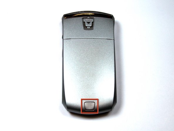

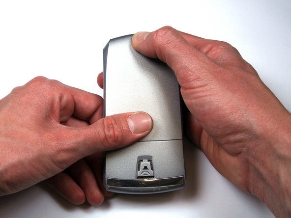

  • Turn over your BalckBerry 7100g so that the back cover is facing up.
  • Locate the battery cover release button near the bottom of the back panel.
Image #1 Image #2 Image #3

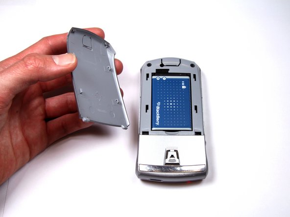

Add Note Edit Step 2  ¶

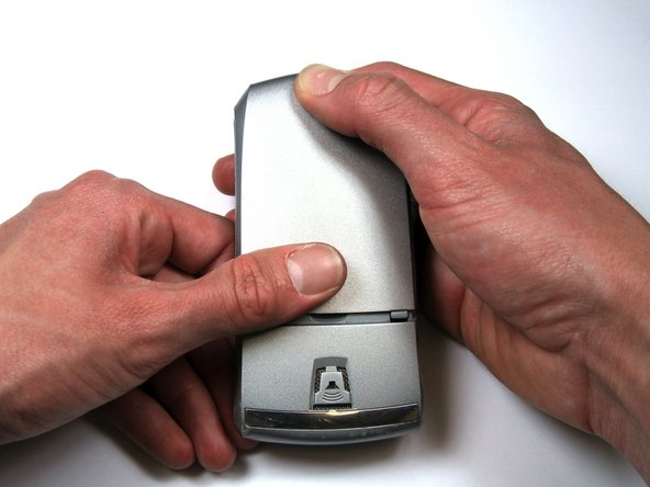

  • Push down on the release button with one thumb.
  • Slide the battery cover off with the other thumb.
Image #1

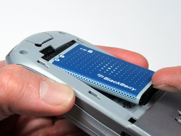

Add Note Edit Step 3  ¶
  • Remove the battery from the battery housing by flipping up the top of the battery.

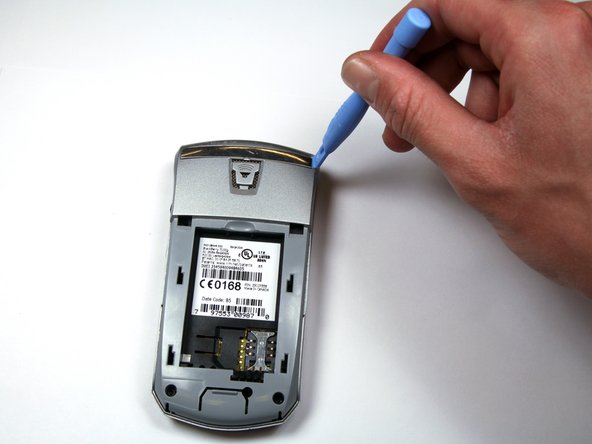

Add Note Edit Step 4 — Housing  ¶

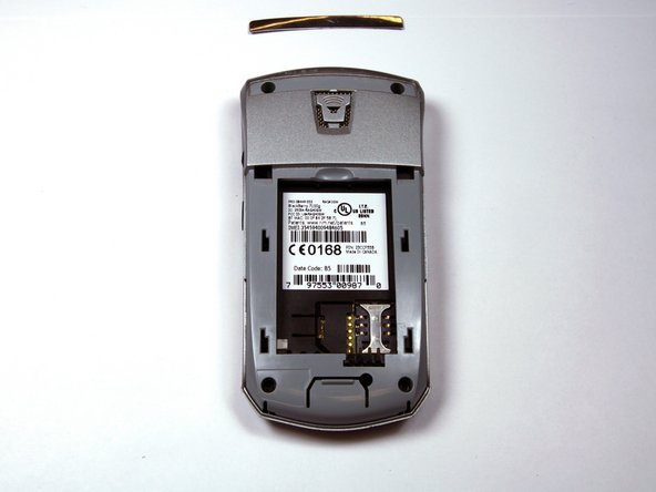

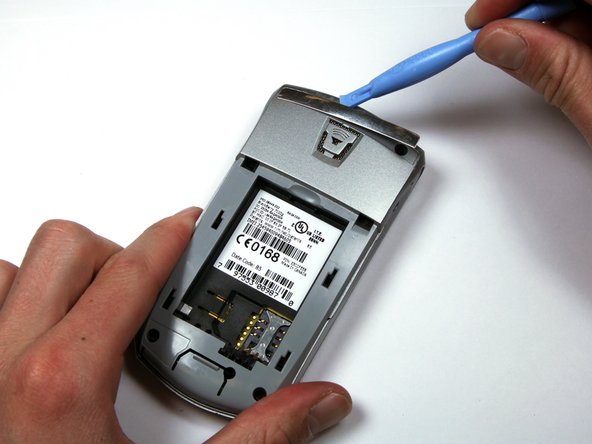

  • Locate the silver strip near the top of your BlackBerry.
  • Use a plastic opening tool to pry off the edge of the silver lining.
  • Slide the tool along the length of the silver strip to completely remove it.
Image #1 Image #2

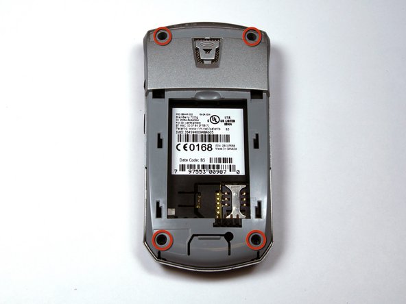

Add Note Edit Step 5  ¶

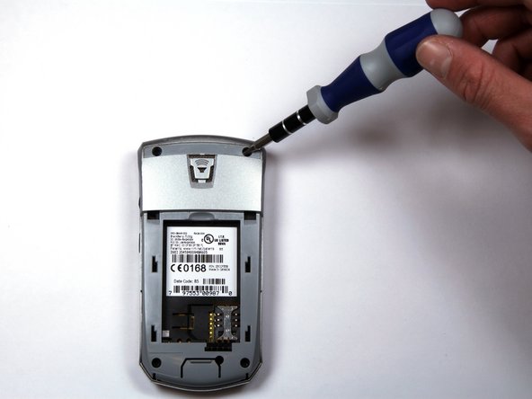

  • Do not lose the screws. They are quite small and can easily be misplaced.
  • Locate and unscrew the four (4) screws using a T6 screwdriver.

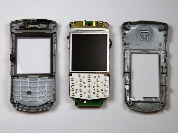

Add Note Edit Step 6  ¶

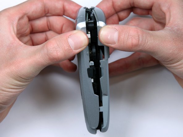

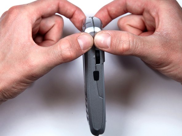

  • The keypad cover may fall out of the housing when prying the housing apart.
  • Tightly pinch the top of the front and back halves of the housing.
  • Carefully pry the two halves of the housing apart.
Image #1

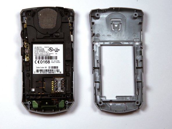

Add Note Edit Step 7  ¶

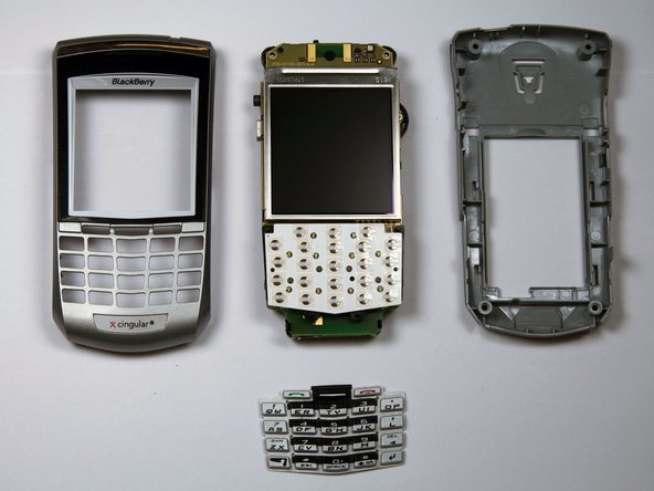

  • You can now easily remove the "guts" of the phone from the housing.
Image #1 Image #2

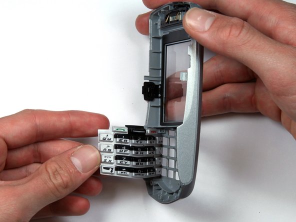

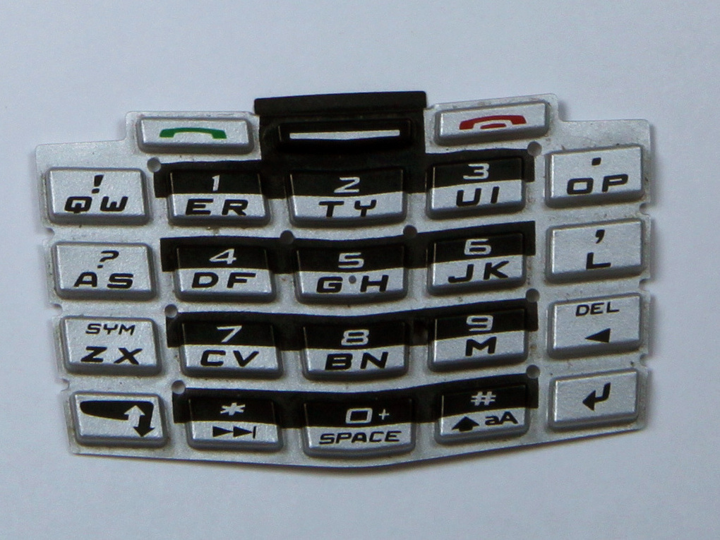

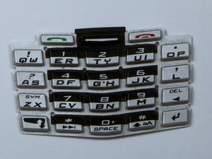

Add Note Edit Step 8 — Keypad Cover  ¶
  • Remove the keypad cover.
  • Insert the new keypad cover.
  • You are done replacing your keypad cover.
