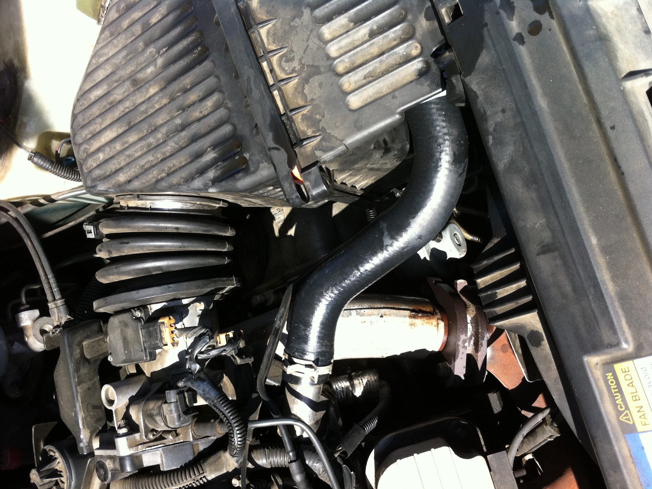

  • Here you can see the upper radiator hose which we are going to replace.
  • You can see in more detail that this hose has a large gash in it where pressure build up and old age caused it to fail thus rupturing.
Image #1
