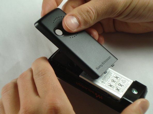

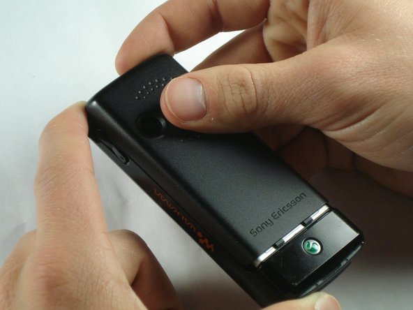

  • Slide the battery cover up and off the phone.

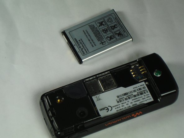

  • Pop the battery out of its slot by lifting it up.

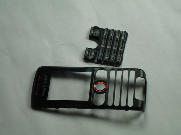

  • Insert the plastic opening tool in between the front case and the back case.
  • Apply downward pressure to make the case lift upwards, thus popping the front case off.
    • Use caution when removing the front case. It may seem stuck but just ease it out.

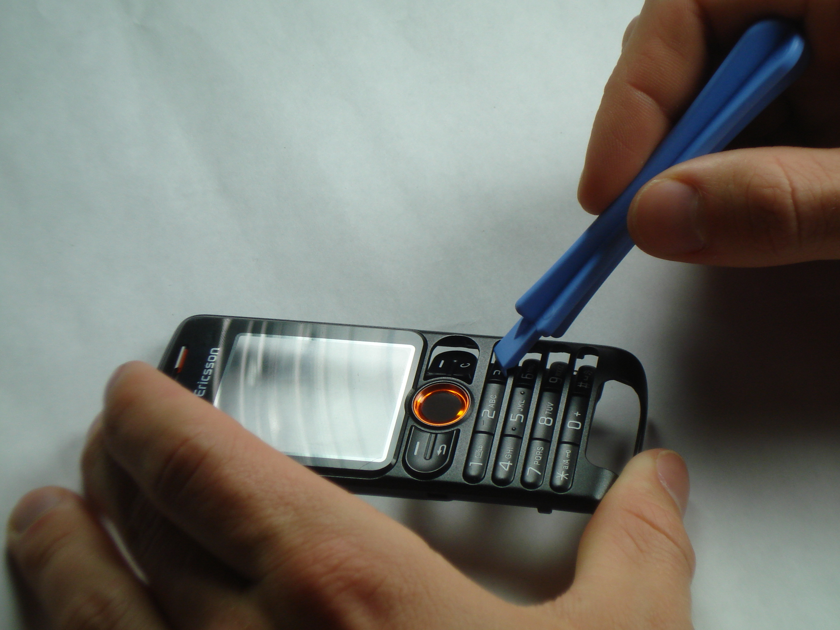

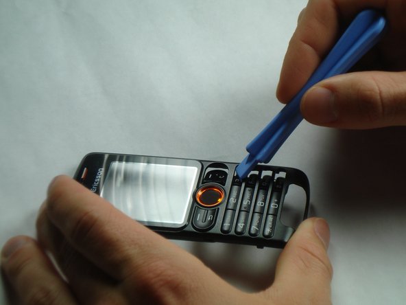

Add Note Edit Step 4 — Keypad  ¶
  • Using the plastic opening tool, press down anywhere on the keypad to separate it from the front case.
