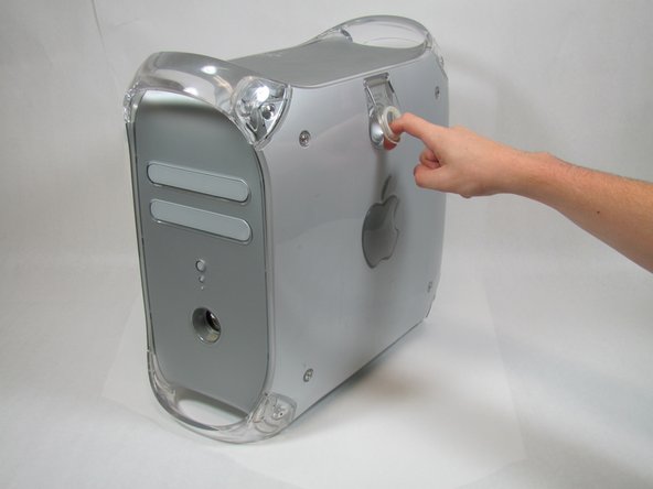

  1. Power Mac G4 Quicksilver Optical Drive Replacement, Opening the case: step 1, image 1 of 1

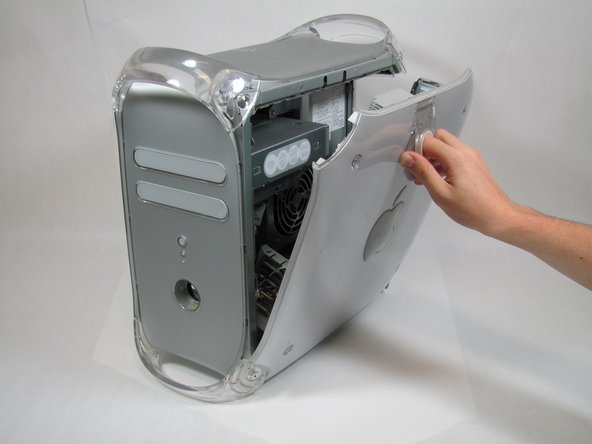

    • The handle to open your computer is located on top of the right side panel.
  2. Power Mac G4 Quicksilver Optical Drive Replacement: step 2, image 1 of 2 Power Mac G4 Quicksilver Optical Drive Replacement: step 2, image 2 of 2
    • Grab the circular handle and pull outward.
  3. Power Mac G4 Quicksilver Optical Drive Replacement: step 3, image 1 of 1
    • Your computer is now open and ready for repair.

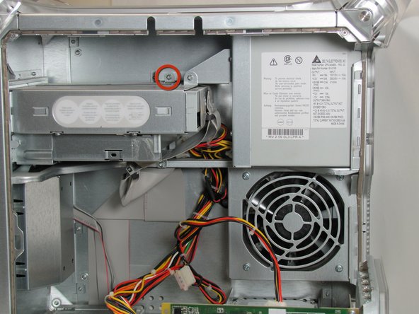

    • The optical drive is in the top left corner of the case.

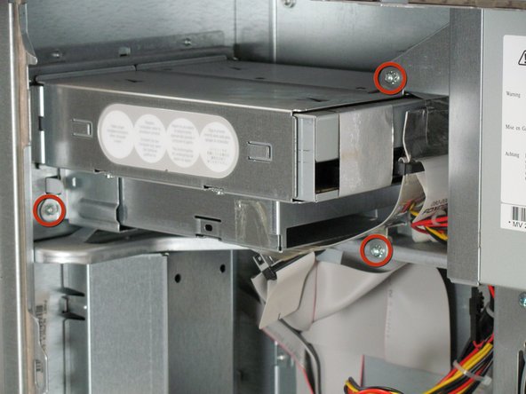

  5. Power Mac G4 Quicksilver Optical Drive Replacement: step 5, image 1 of 2 Power Mac G4 Quicksilver Optical Drive Replacement: step 5, image 2 of 2
    • There are four screws to be removed.
    • The first screw can be seen in the first picture.
    • The remaining three screws can be seen in the second picture.

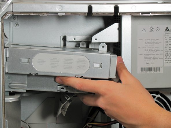

  6. Power Mac G4 Quicksilver Optical Drive Replacement: step 6, image 1 of 1
    • Remove the optical drive by pulling the drive away from the front of the computer and out.

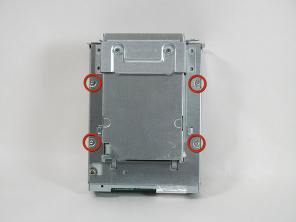

  8. Power Mac G4 Quicksilver Optical Drive Replacement, Optical Drive: step 8, image 1 of 1
    • Remove the four screws holding the enclosure to the drive.

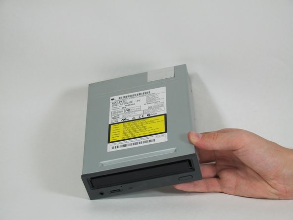

  9. Power Mac G4 Quicksilver Optical Drive Replacement: step 9, image 1 of 1
    • Push on the back of the drive (side with the connectors) to slide the drive out of the enclosure.
    • Your optical drive is now ready to be replaced.
