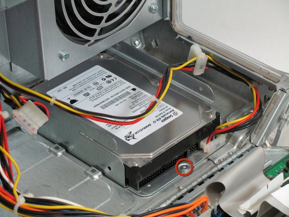

  1. Power Mac G4 Quicksilver Hard Drive Assembly Replacement, Hard Drive Assembly: step 1, image 1 of 1
    • The hard drive is located in the back right corner of the case.

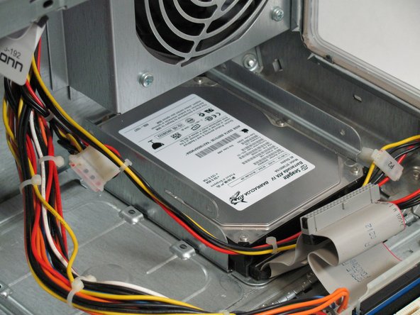

  2. Power Mac G4 Quicksilver Hard Drive Assembly Replacement: step 2, image 1 of 1
    • Remove the flat ribbon cable by pulling with substantial force.

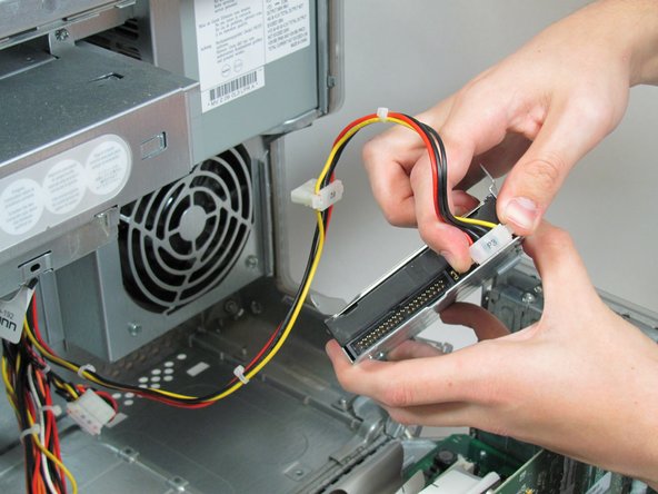

  3. Power Mac G4 Quicksilver Hard Drive Assembly Replacement: step 3, image 1 of 1
    • Remove the screw holding the hard drive to the computer.

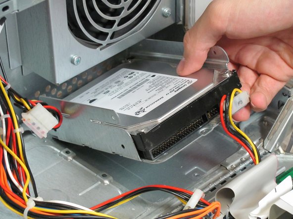

  4. Power Mac G4 Quicksilver Hard Drive Assembly Replacement: step 4, image 1 of 1
    • Pull the drive up and out of the computer.

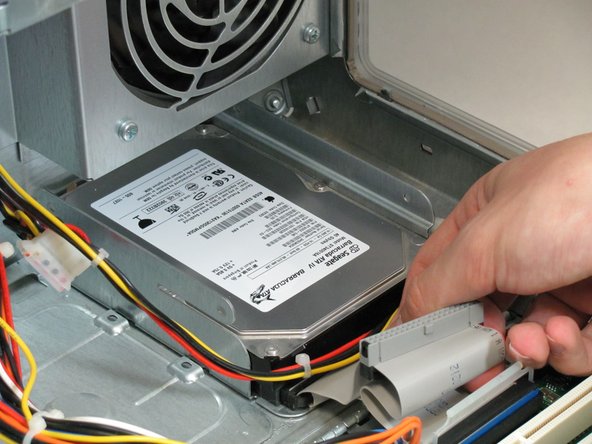

  5. Power Mac G4 Quicksilver Hard Drive Assembly Replacement: step 5, image 1 of 1
    • Remove the multicolored cable by grasping the plastic connector on either side and pulling with substantial force.
