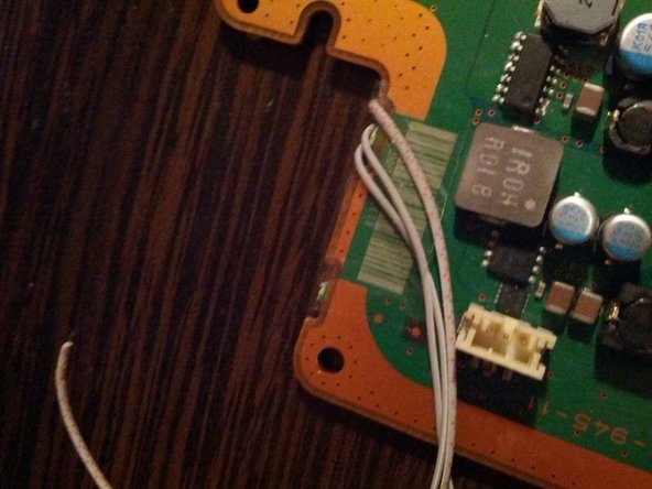

If you ripped of your Fan Connector, here is a Guide which will show you how bypass/fix it.

Add Note Edit Step 1 — Ripped of Fan Connector  ¶
  • Solder 3 wires to the 3 Points on the Backside of the Mainboard. The 3 Points are right under the Fan Connector on the other side.
Image #1
Add Note Edit Step 2  ¶
  • Use some Tape to fix the wires on the Board. As you can see, i used the gap on the right to get the wires to the other side.
Image #1
Add Note Edit Step 3  ¶
  • This is the upper side of the Mainboard, you can/should also use some Tape to fix the position of the wires. Also you can see, i glued the connector back on the board (no electrical connection).
Image #1
Add Note Edit Step 4  ¶
  • Solder the wires to the Connector you glued on the Mainboard, or directly to the fan or any other idea you can come up with.
