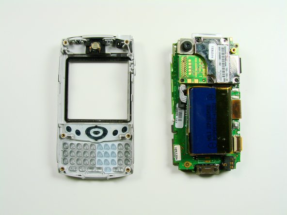

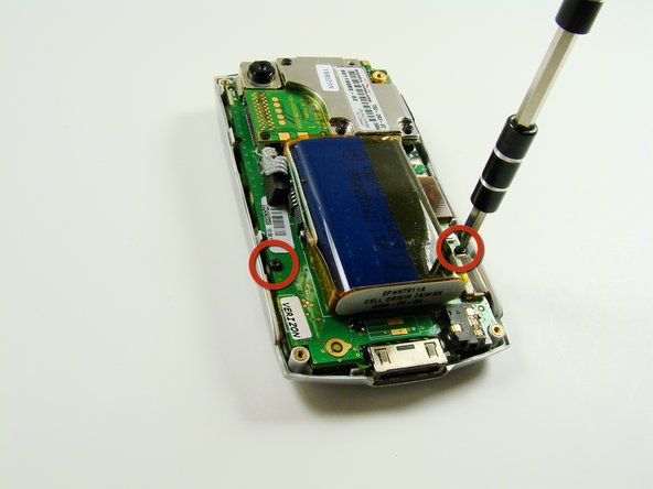

Add Note Edit Step 4 — Front Case  ¶
  • Using a T6 Torx Screwdriver, remove the two screws.
  • The motherboard will now be loose from the front case.
Image #1

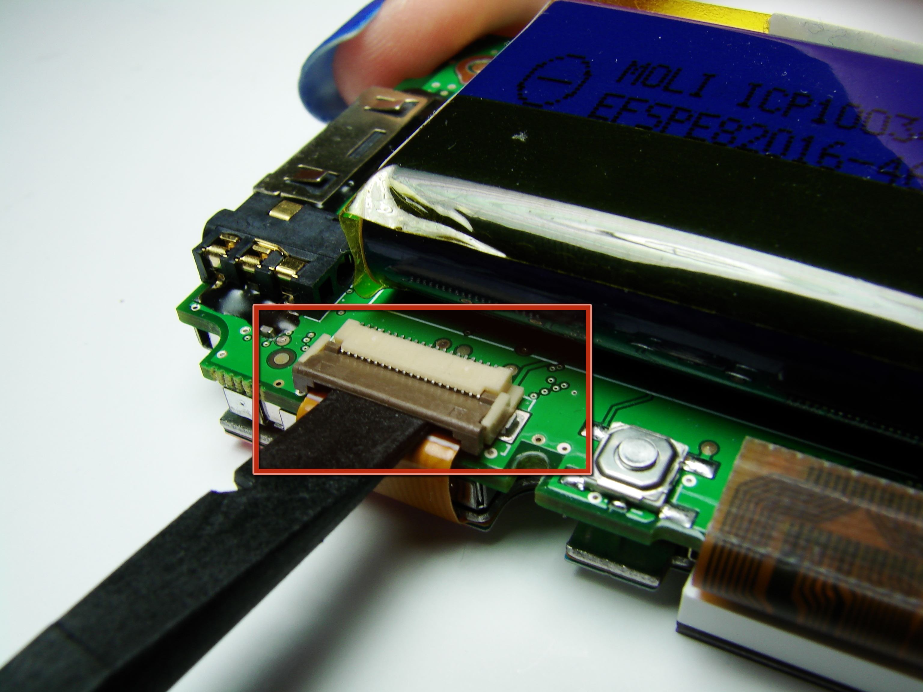

Add Note Edit Step 5 — Keyboard  ¶
  • Using the spudger, flip open the clasp that holds the data ribbon in place.
Image #1

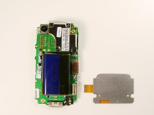

Add Note Edit Step 6  ¶
  • Pull out the ribbon.
  • The keyboard will disconnect from the phone.
