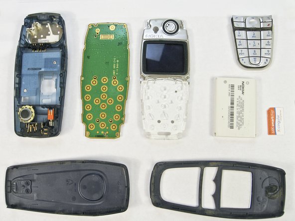

Image #1 Image #2 Image #3
Add Note Edit Step 9  ¶

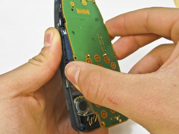

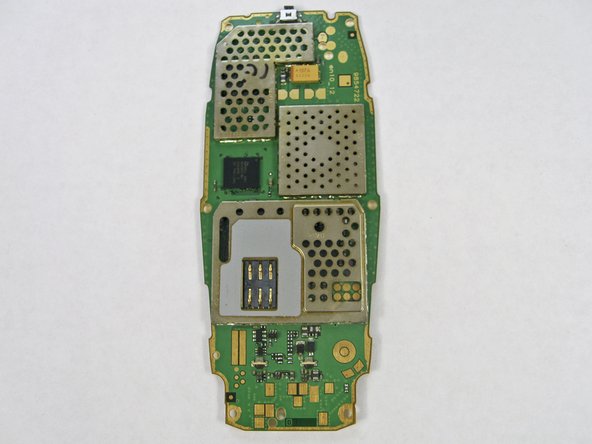

  • Insert a finger between the phone body and logic board.
    • The logic board is the green plastic piece with circuitry attached.
  • Pull the board away gently.
    • The board is delicate and contains electronic parts. Be careful while removing it.

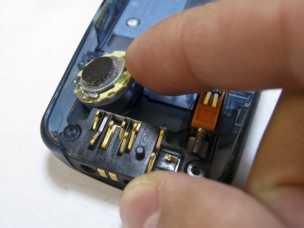

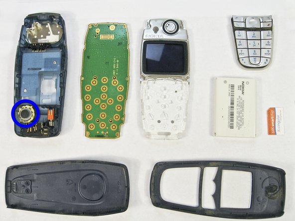

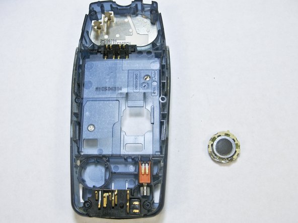

  • Use a spudger or a finger to lift the the microphone off the body of the phone.
  • The microphone is attached to the phone with glue, but removes easily with a spudger.
