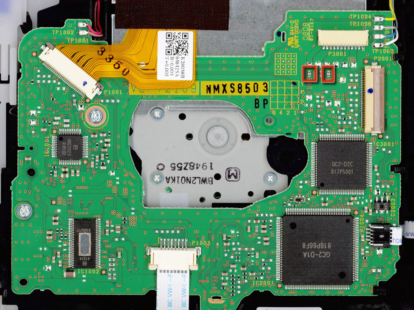

If you have a drive which fails to spin the disc up or properly eject or "eat" discs, you may have one or two blown fuses on the drive PCB. This guide will show you how to test and replace those fuses!

Add Note Edit Step 23 — Drive Board Fuses  ¶
  • Measure across each fuse with a continuity meter.
  • If either fuse is open, you will need to replace it with an 0603 fuse; if one is not available, you can use a 0-ohm resistor or jumper wire for testing purposes.
