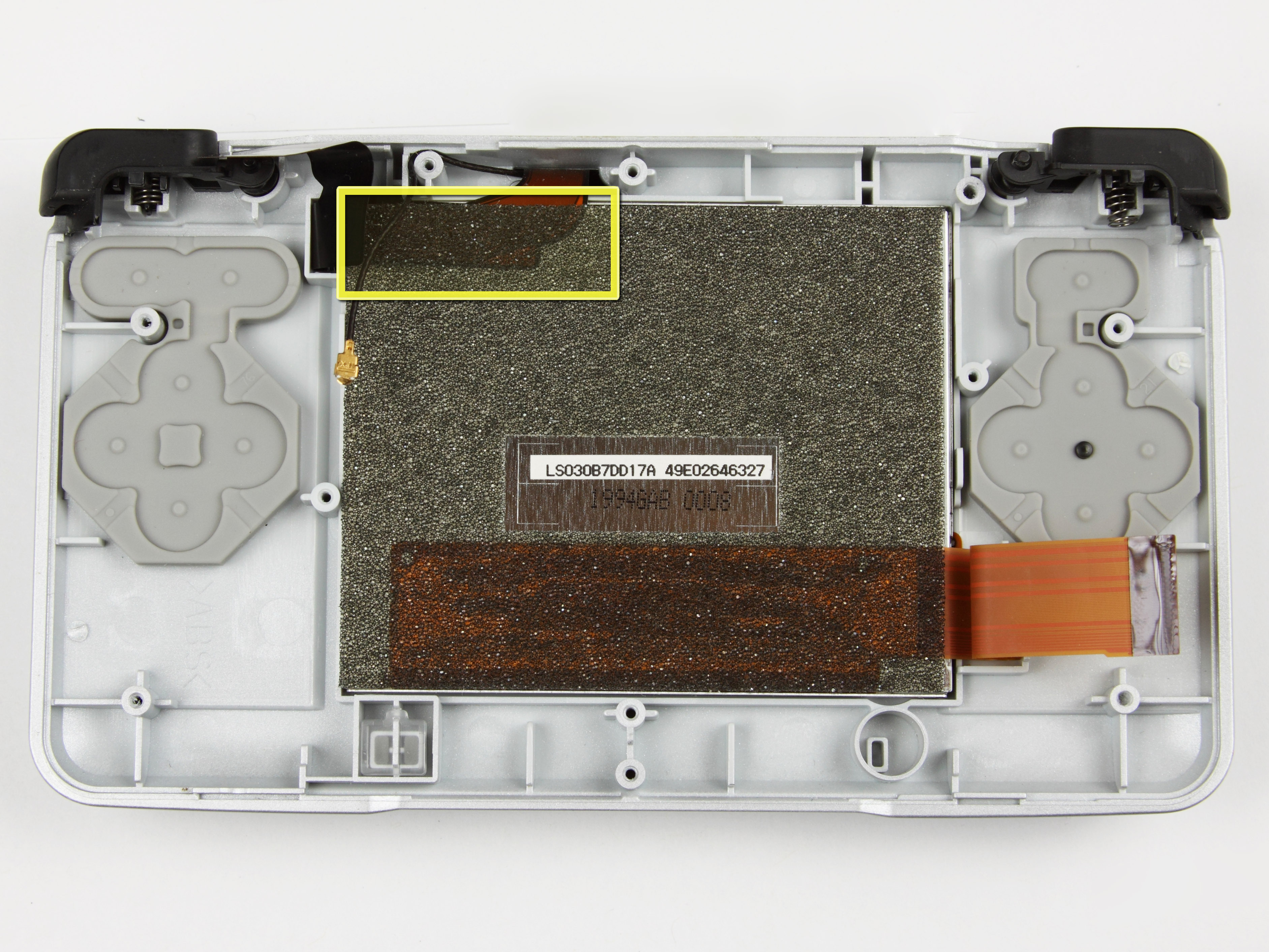

Image #1 Image #2
Add Note Edit Step 11 — Bottom LCD Screen  ¶
  • Peel off the back foam on the bottom touch screen to expose the ribbon cable.
  • Gently lift the screen out of the base.
