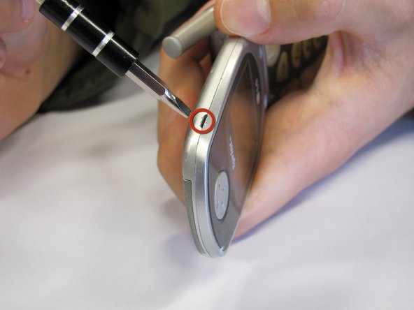

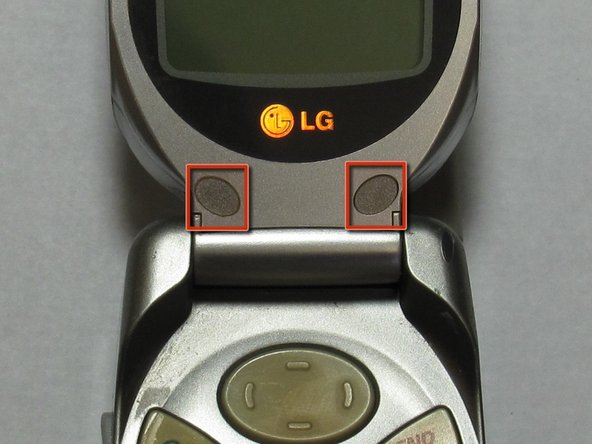

  • Remove the two plastic screw covers below the inside phone screen.
Image #1

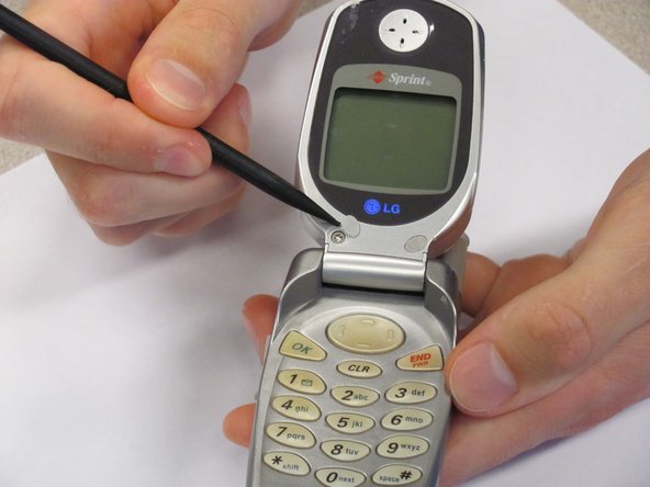

Add Note Edit Step 2  ¶

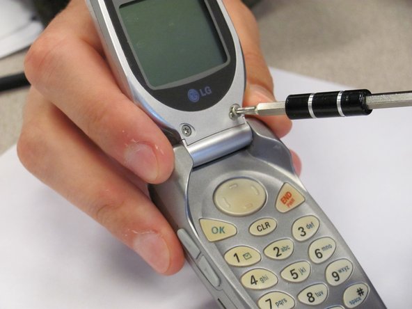

  • Unscrew both screws using a Torx T6 screwdriver.
Image #1 Image #2 Image #3

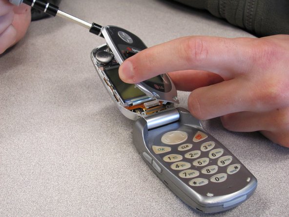

Add Note Edit Step 3  ¶

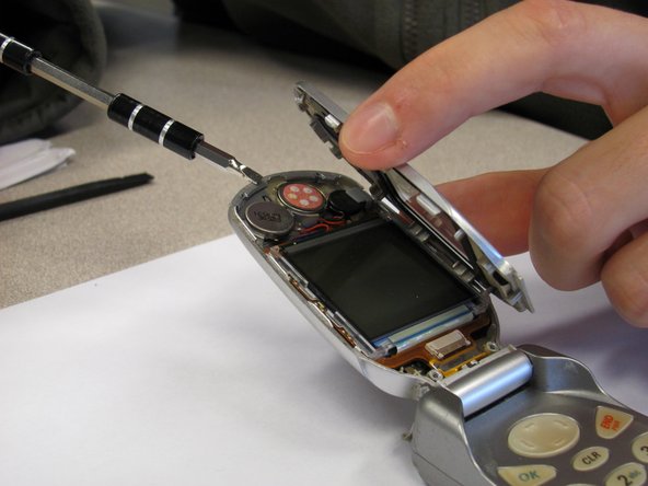

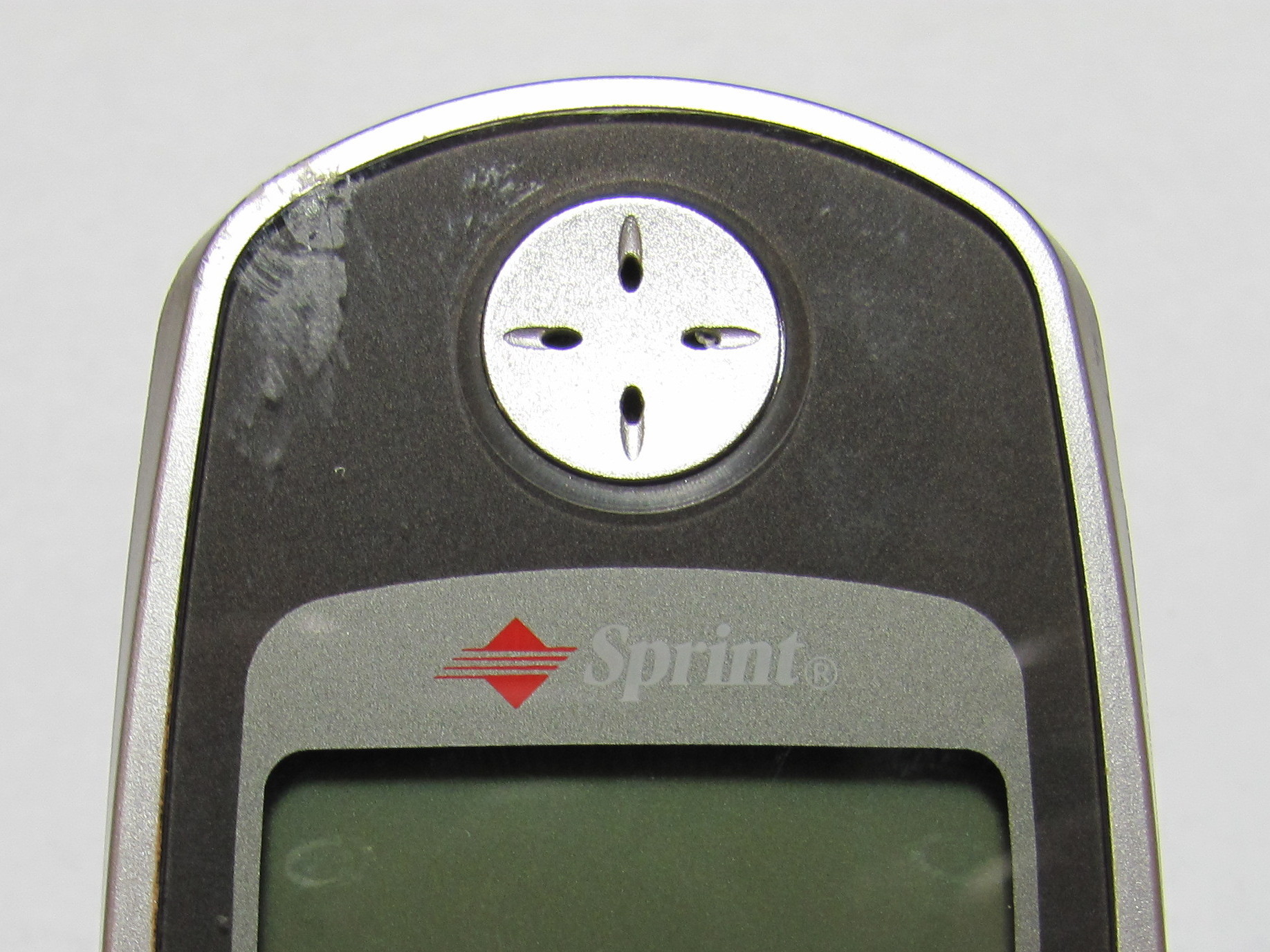

  • Pry off screen front cover with a straight 3mm screwdriver.

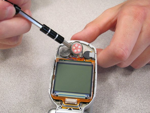

Add Note Edit Step 4  ¶
  • Pry off the speaker which is glued on to the front cover using a Small Flathead Screwdriver.
Image #1

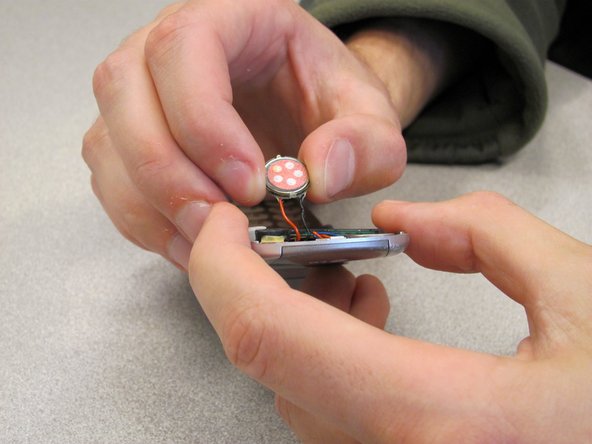

Add Note Edit Step 5  ¶
  • Unsolder the black and red wires of the speaker from where they are attached to the base of the screen.

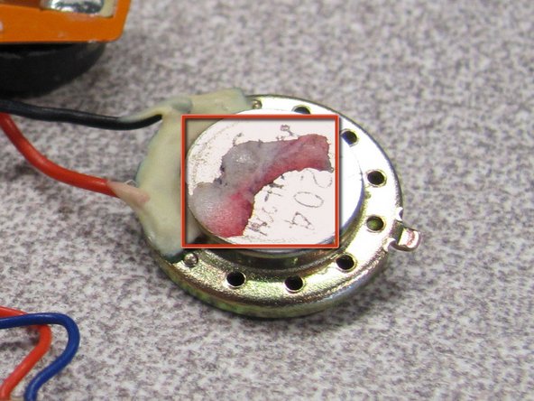

Add Note Edit Step 7  ¶
  • Apply glue to the back of the speaker and place it back in its original position.
