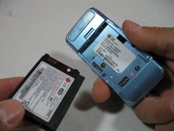

  • Slide the battery release up.
Image #1
Add Note Edit Step 2  ¶
  • Remove the battery by lifting away from the case.

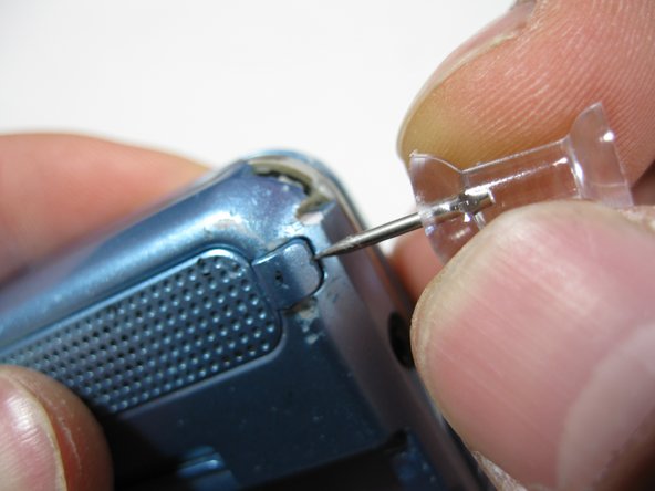

  • Remove the 2 screw covers next to the rear speaker with a Push Pin.

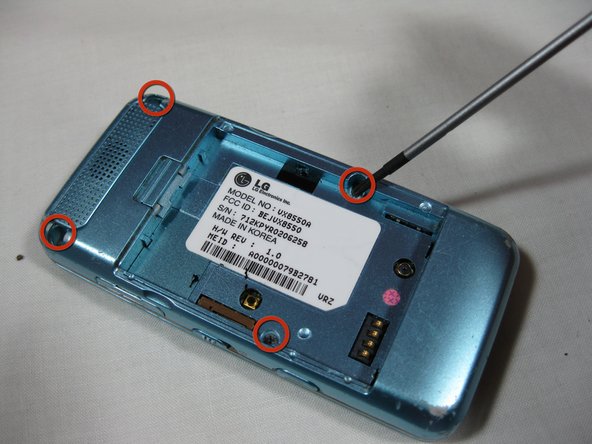

  • Remove the 4 cover screws with a Philips #00 screwdriver.

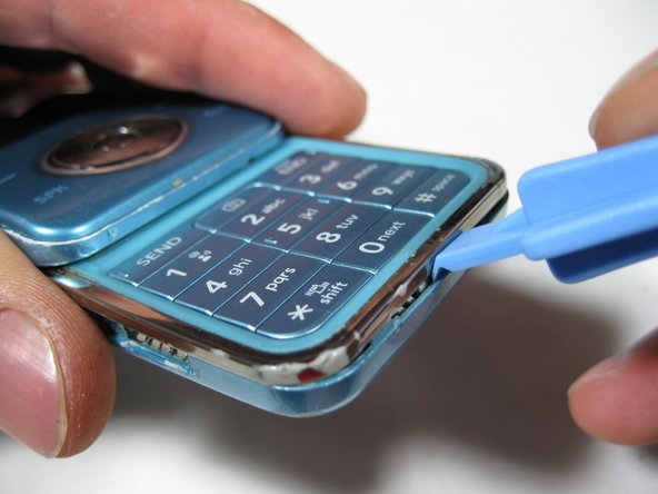

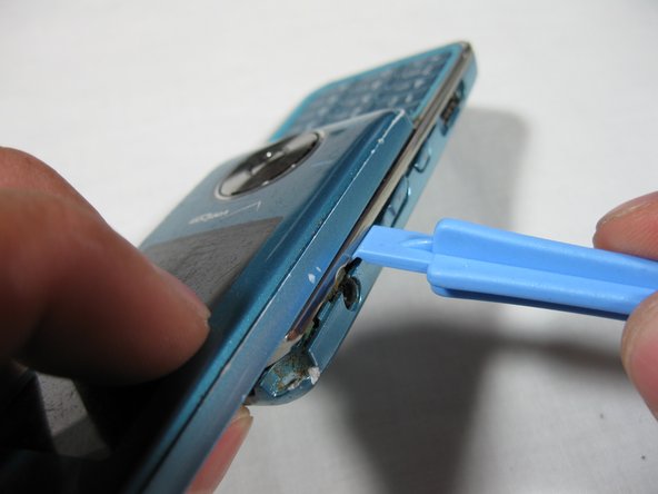

  • Use the iPod opening tool to pry off the back casing.
Image #1
Add Note Edit Step 6  ¶
  • Continue sliding the iPod opening tool around the seam of the casing to separate the front and back casings.

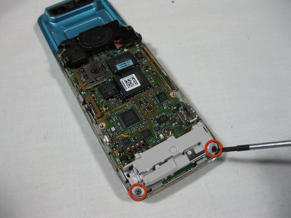

Add Note Edit Step 8 — Motherboard  ¶
  • Remove the 2 screws from the back of the phone with a Phillips #00 Screwdriver.

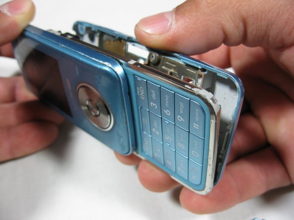

Add Note Edit Step 11 — Keypad Housing  ¶
  • Lay the phone with the screen facedown.
  • The 6 slider screws are visible.
Image #1
Add Note Edit Step 12  ¶
  • Peel back but don't remove the blue tape to access the 2 center screws.
  • Remove the 6 slider screws with the Phillips #00 screwdriver.
Image #1

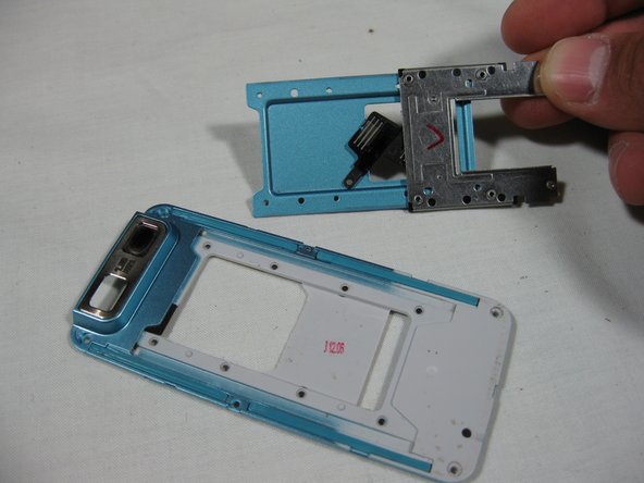

Add Note Edit Step 13  ¶
  • Lift the keypad housing away from the slider.
Image #1

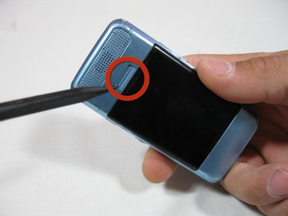

  • Remove the 2 screw covers next to the speaker with a push pin next to the camera.

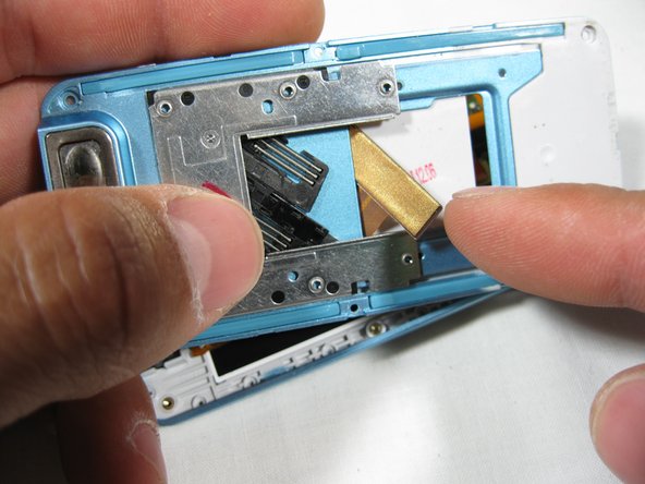

  • Use the ipod opening tool to pry the screen casing and the slider mechanism apart from each other.
Image #1

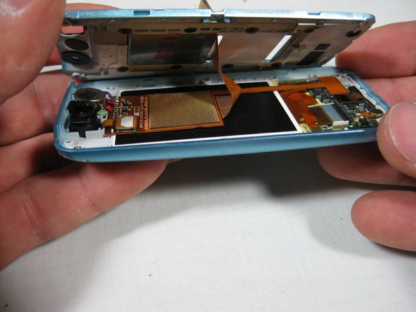

Add Note Edit Step 17  ¶
  • Carefully lift the slider mechanism to see the ribbon cables underneath.
Image #1
Add Note Edit Step 18  ¶
  • Slide ribbon cable through the slider mechanism.
Image #1

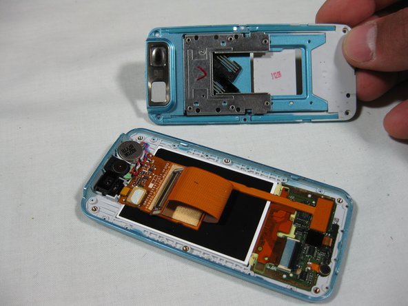

Add Note Edit Step 19  ¶
  • Separate the two halves.
Image #1

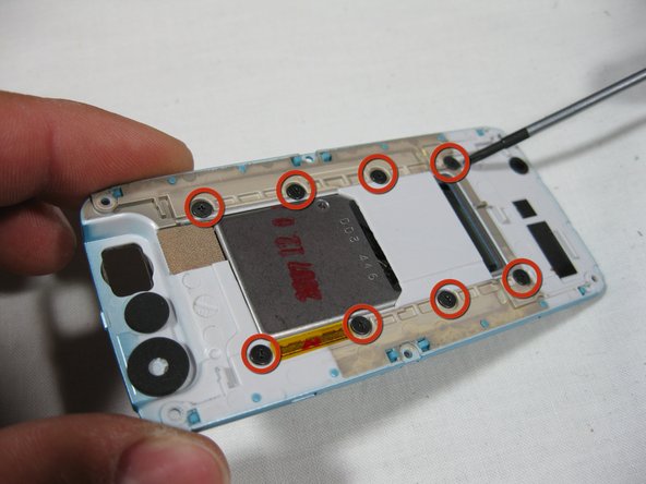

Add Note Edit Step 20 — Slider Mechanism  ¶
  • With the slider mechanism separated from the screen casing the 8 screws securing the slider mechanism are visible.
  • Remove the 8 screws.
Image #1
Add Note Edit Step 21  ¶
  • Remove slider mechanism.
