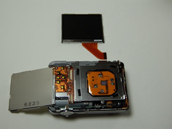

  • Pry off the LCD casing.
Image #1 Image #2 Image #3
Add Note Edit Step 9  ¶

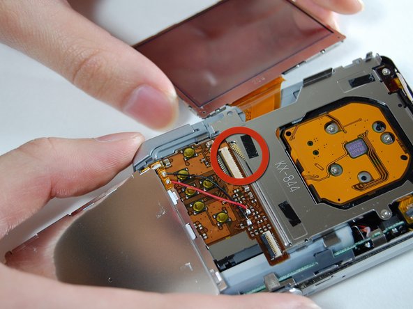

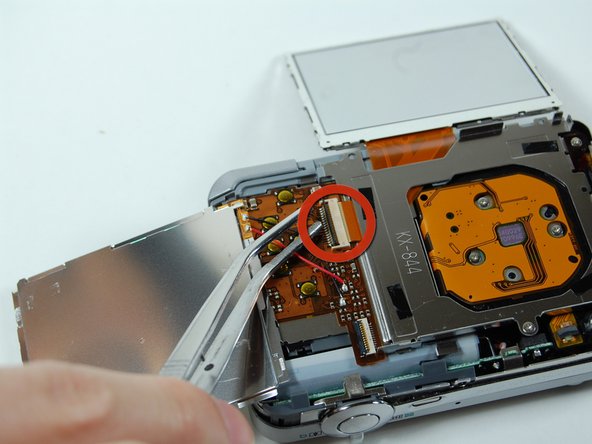

  • Flip open the connector holding the ribbon.
  • Pull out the LCD screen with the ribbon from the camera.
Image #1 Image #2

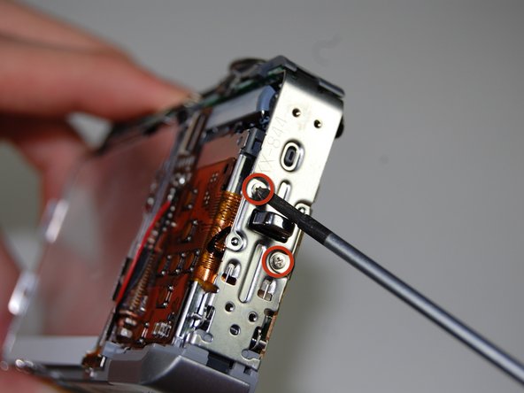

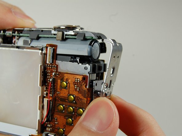

  • Remove two screws on the side where the battery is located.
  • Remove the lanyard loop after the screws come off.
  • Slowly pull the side casing so it becomes dislocated from the top of the camera frame.

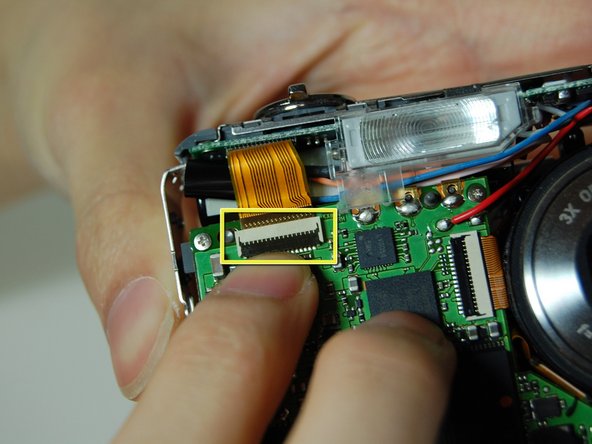

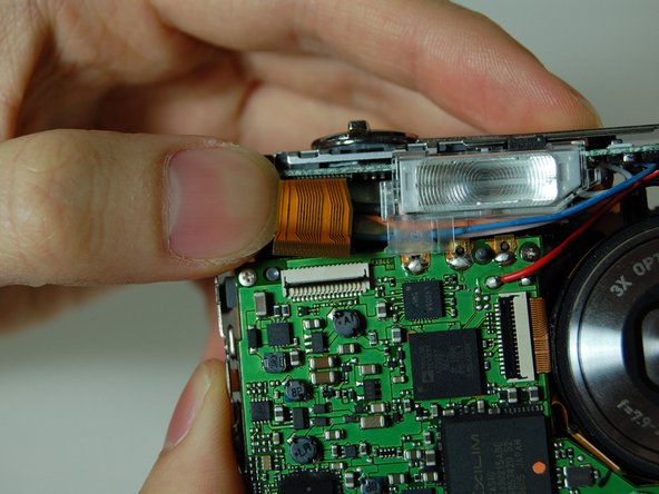

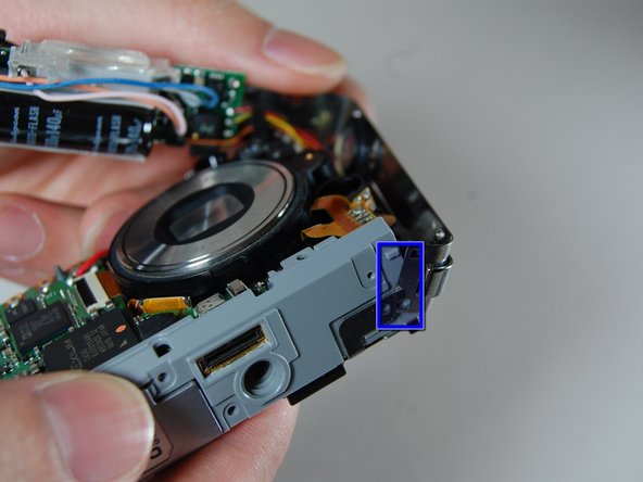

  • On the front of the camera near the flash flip the connector holding the ribbon.
  • Remove the ribbon from the connector.
Add Note Edit Step 12  ¶

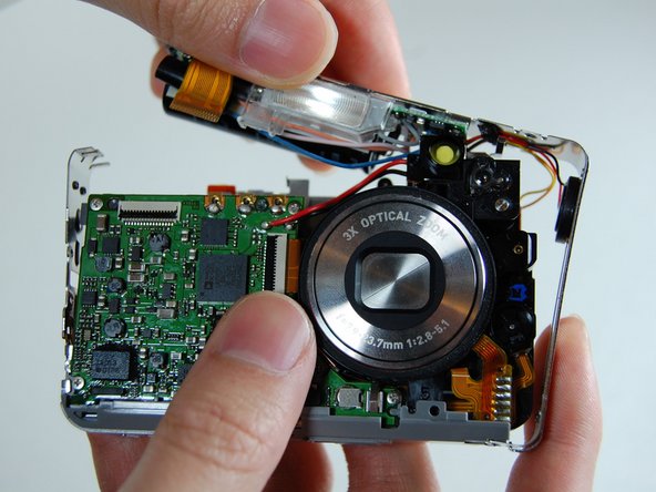

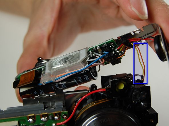

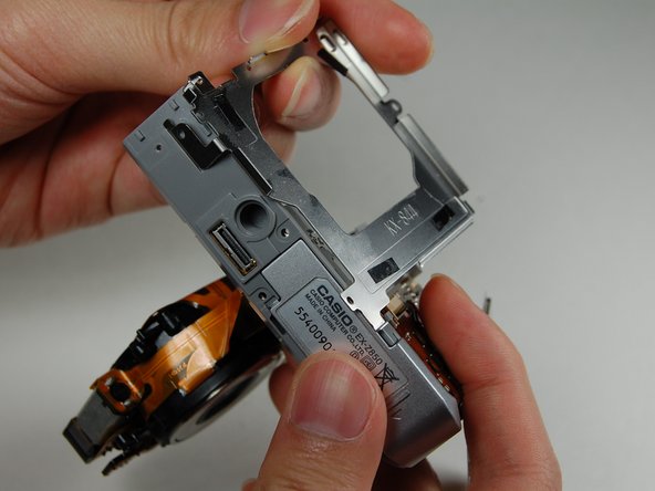

  • Carefully remove the L shaped frame from the camera.
  • At the bottom of the camera the L shaped frame is being held in by two plastic bumps and a metal tab.
  • Pop the frame off the bumps and tabs.
  • Note: There is a yellow and orange wire soldered onto the camera. Be careful not to pull them off.

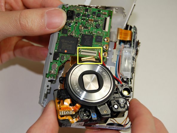

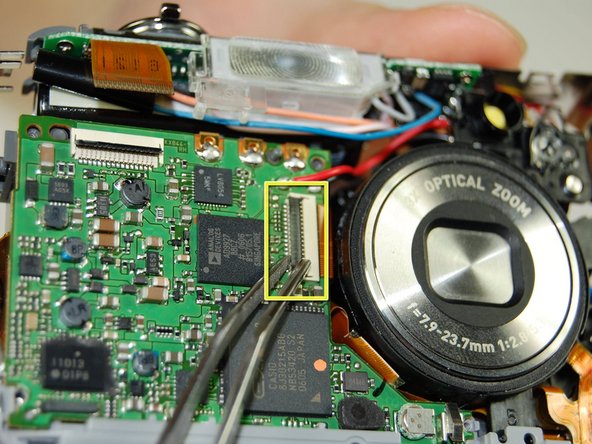

  • On the logic board next to the lens is a connector with a ribbon.
  • Flip the connector and remove the ribbon.

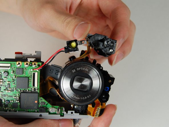

  • Remove the frame on the back side of the camera where the LCD screen was.
  • Remove the two screws connecting the frame with the camera.
  • Slowly pry off the frame from the camera.
  • After removing the frame a plastic piece with two yellow button connections should fall off.
  • Note: This plastic piece is soldered to two wires a yellow and orange one.

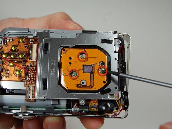

Add Note Edit Step 15  ¶

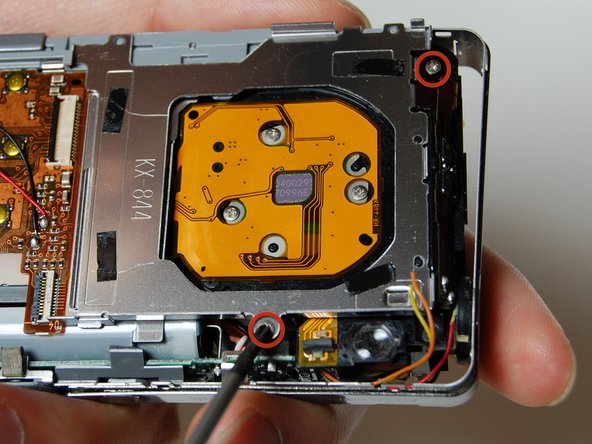

  • On the back of the camera where the LCD screen was, remove 3 screws located behind the lens.
Image #1
Add Note Edit Step 16  ¶

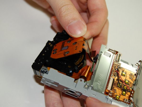

  • Remove the large orange ribbon previously held in by screws from the camera.
Image #1

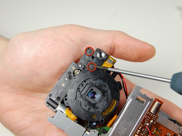

  • On the backside of the camera where the indicator lamp is located remove the two screws.

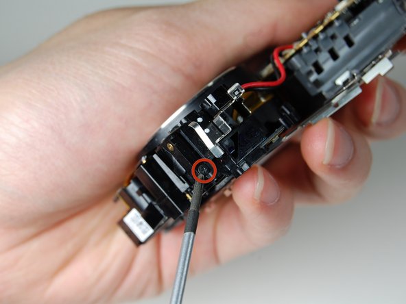

Add Note Edit Step 18  ¶

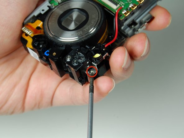

  • On the side of the indicator lamp remove a screw.
  • On the front side of the indicator lamp remove the a screw.
  • This should remove the indicator lamp from the lens.

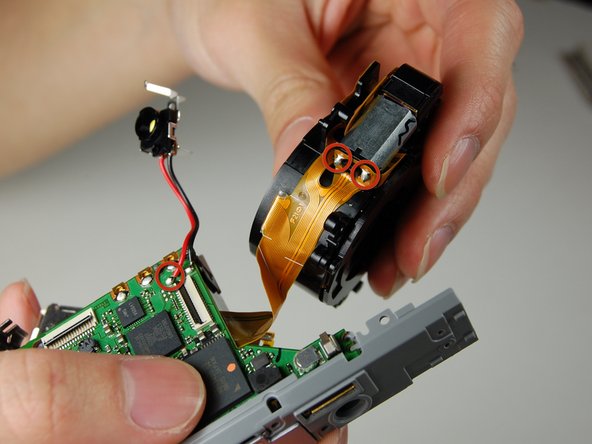

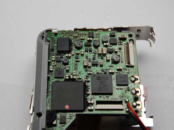

  • Desolder the lens from the logic board.
  • Desolder the wire from the logic board.
  • The logic board is now detached from the rest of the camera.
