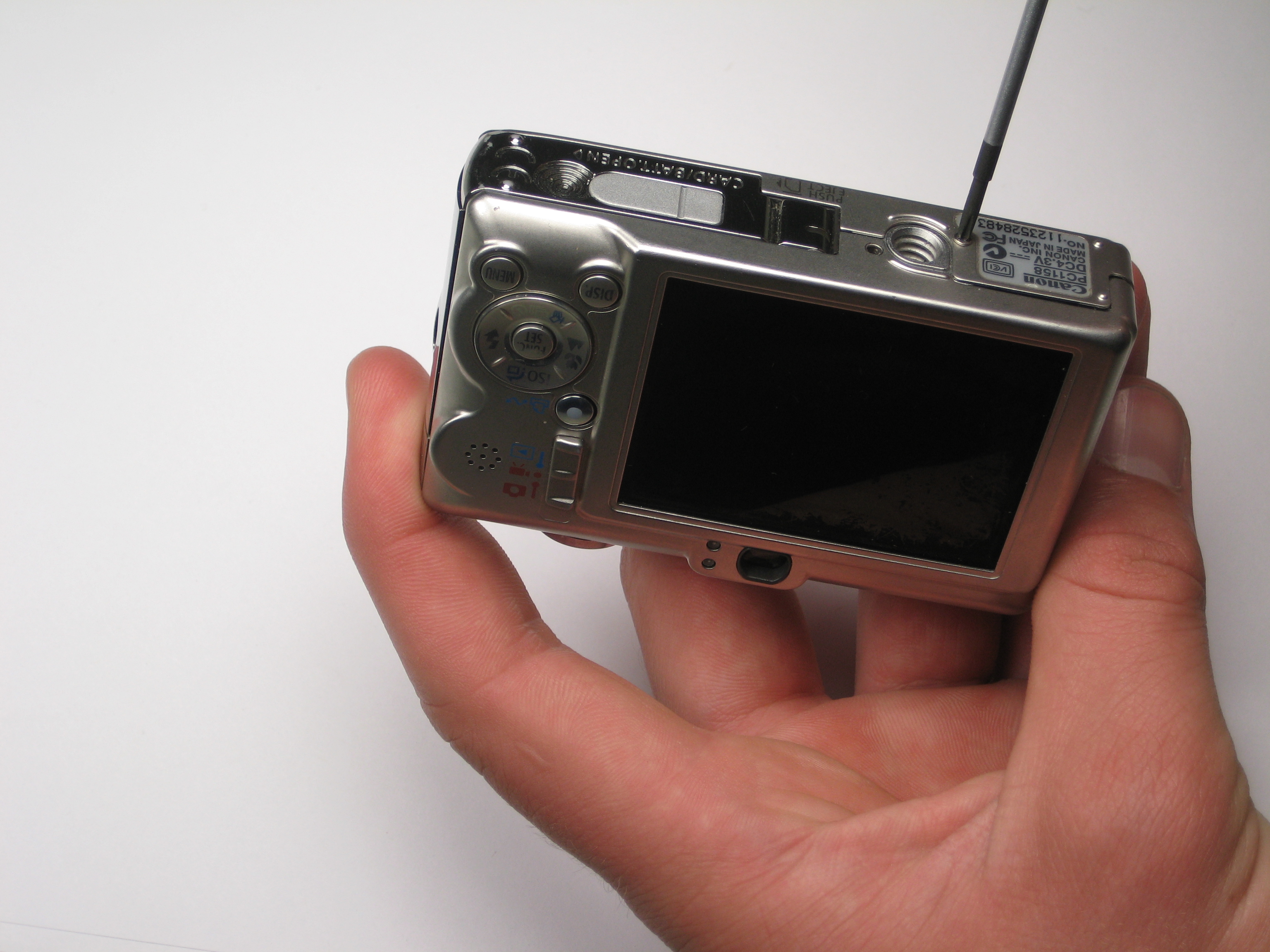

  • Remove the battery and SD Card from their slots. Leaving these in could cause the battery to ground and ruin the electronics.
  • Unscrew the six screws on the casing. Two are on the bottom as pictured; two more are on each side of the camera.

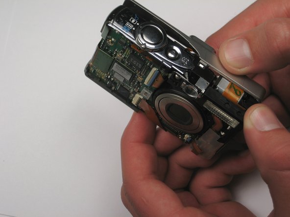

  • Take hold of the inside of the camera, and gently pull away from the back casing.
Image #1
Add Note Edit Step 5  ¶
  • Remove the square, clear, rubber protector from the front of the logic board. This is not necessary to remove, but can easily fall off and get lost during later steps.
Image #1
Add Note Edit Step 6  ¶
  • When you reassemble the camera, make sure the switch on the casing (pictured left) matches the position of the switch on the camera internals.
  • The black viewfinder padding (pictured right) can easily fall off the casing. Make sure you don't lose it when moving around parts.
