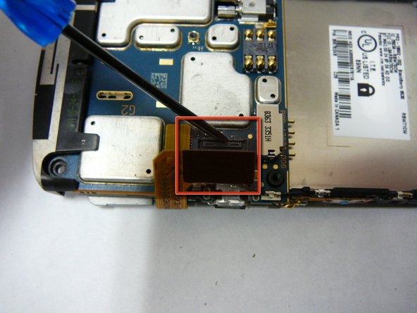

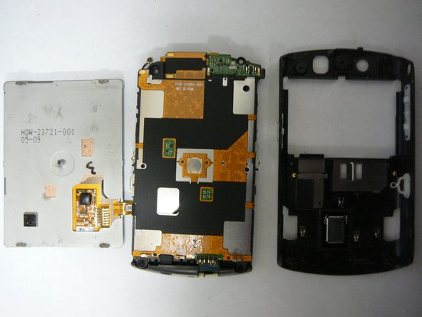

  • Now remove the logic board & LCD assembly from the rear housing. Be gentle, and do not use excessive force.
Image #1 Image #2
Add Note Edit Step 10  ¶

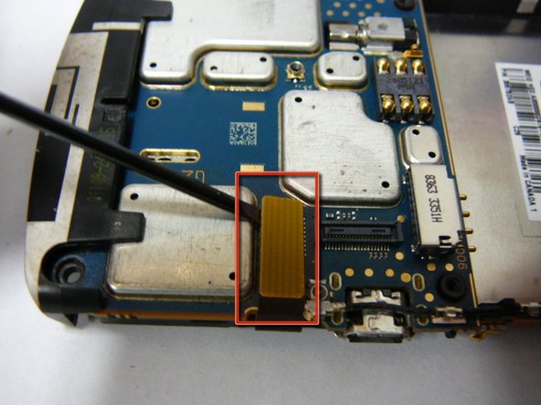

  • Flip the logicboard around so that it is sitting on top of the screen, now remove the two ribbon cables for the LCD & Digitizer.

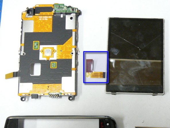

  • Put your broken assembly to the side, and now install your new one following the past steps in reverse.
  • ONE THING TO KEEP IN MIND WHEN ORDERING YOUR NEW PART, LOOK ON THE RIBBON CABLE FOR ETHER V.014 or V.024 . (Shown in blue)
