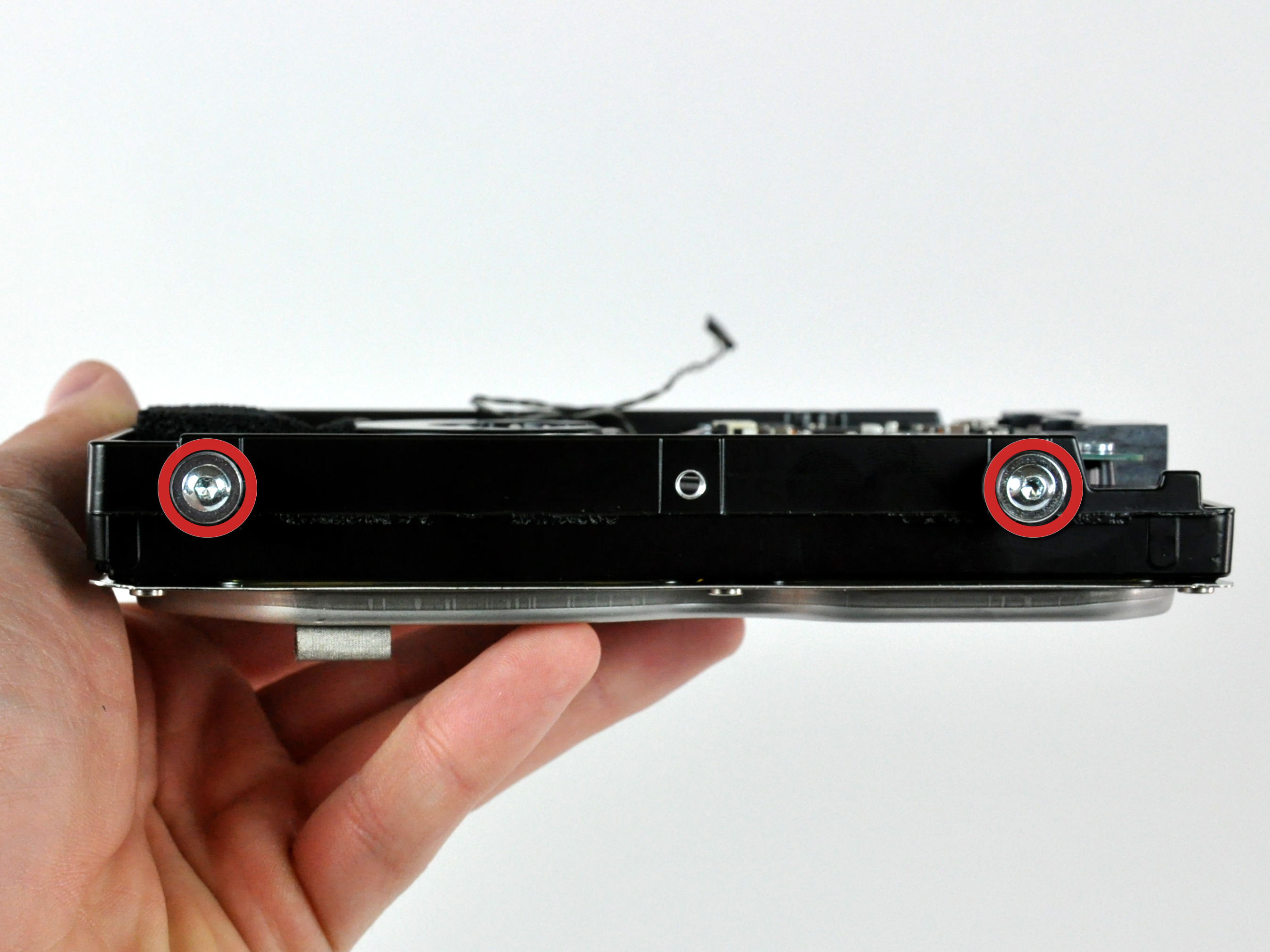

  16. iMac Intel 20" EMC 2266 Hard Drive Replacement, Hard Drive: step 16, image 1 of 1
    • Remove the two T8 Torx screws and their attached rubber grommets from the hard drive.
