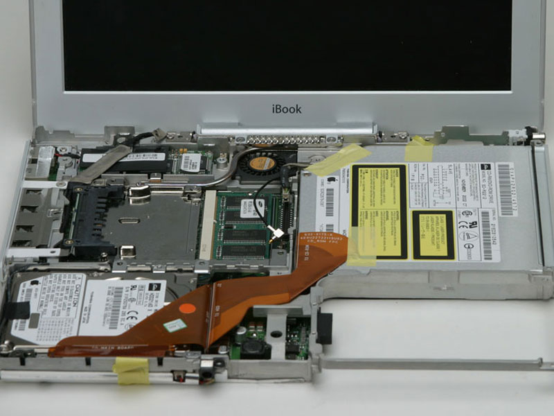

Add Note Edit Step 38 — Hard Drive  ¶
  • Your laptop should look approximately like this.
first image
Add Note Edit Step 39  ¶
  • Use the transparent orange loop to disconnect the large orange ribbon cable from the logic board.
first image
Add Note Edit Step 40  ¶
  • Lift up the front edge of the hard drive.
  • Peel back the black tape to free the microphone cable from the hard drive.
first image
Add Note Edit Step 41  ¶
  • Use the transparent orange loop to disconnect the hard drive ribbon cable from the hard drive.
  • This is a bit tricky. Try rocking the cable gently from side to side while applying even pressure. If you bend the pins, do your best to straighten them, using the hard drive cable as a guide.
first image
Add Note Edit Step 42  ¶
