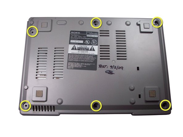

    • Before you begin, make sure the console is turned off and unplugged.
    • Turn the console upside down and remove the five 15.8 mm-long Phillips #1 screws.

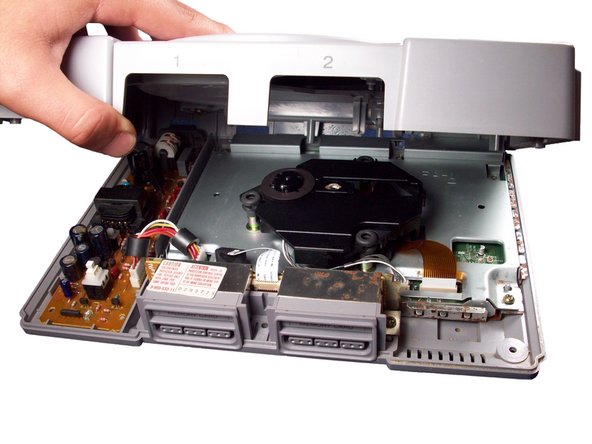

  2. PlayStation Controller Ports Replacement: step 2, image 1 of 2 PlayStation Controller Ports Replacement: step 2, image 2 of 2
    • While holding the top and bottom halves of the console together, flip the console back over. Lift the top cover straight up to remove it.

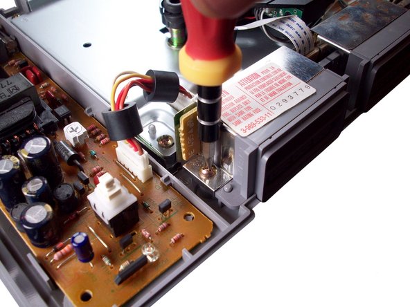

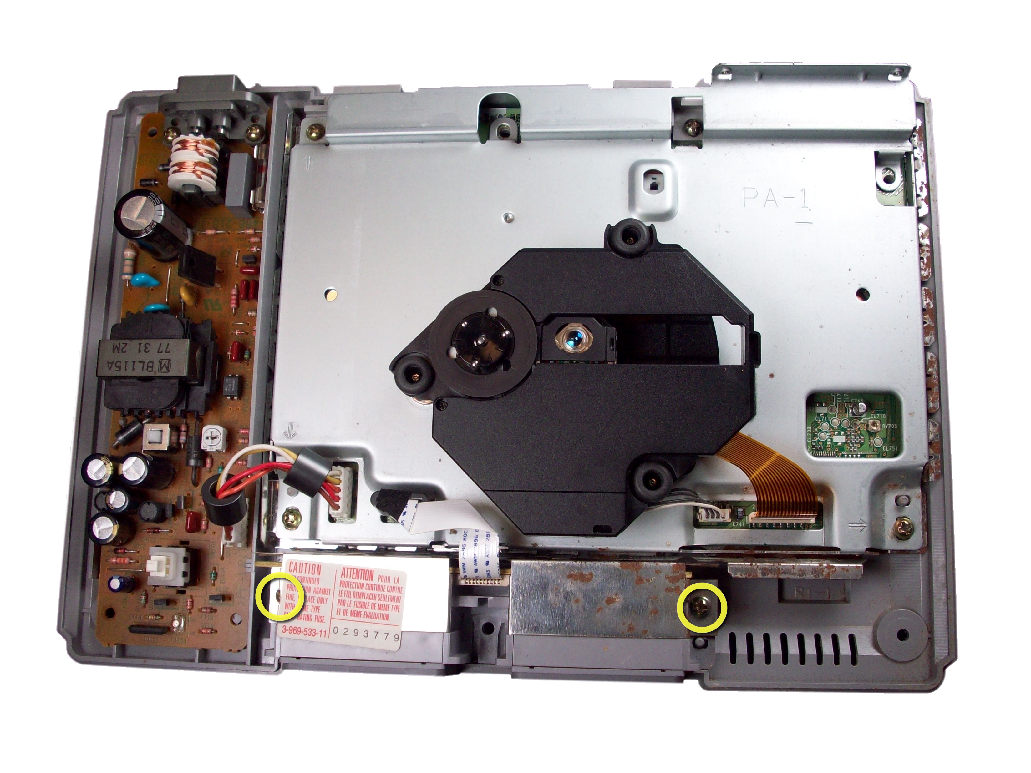

  3. PlayStation Controller Ports Replacement, Remove the Controller Ports: step 3, image 1 of 1
    • Remove five Phillips #1 screws securing the metal shield to the controller ports:
    • Two 14 mm screws
    • Three 8 mm screws
  4. PlayStation Controller Ports Replacement: step 4, image 1 of 2 PlayStation Controller Ports Replacement: step 4, image 2 of 2
    • Lift the metal shield straight up to remove it.

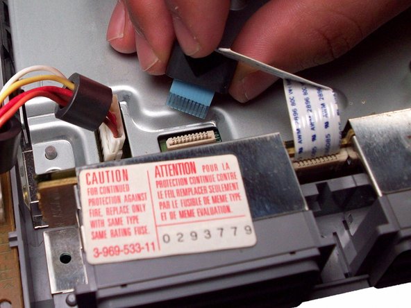

  5. PlayStation Controller Ports Replacement: step 5, image 1 of 2 PlayStation Controller Ports Replacement: step 5, image 2 of 2
    • Pull the controller port's ribbon cable straight up and out of its socket on the motherboard to disconnect it.
