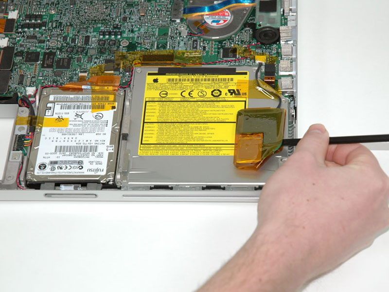

Add Note Step 3
  • Remove the following 8 screws:
    • Two 3 mm Phillips in the battery compartment, on either side of the battery contacts.
    • Two 12 mm Phillips on either side of the memory compartment.
    • Four 16 mm Phillips along the hinge.
