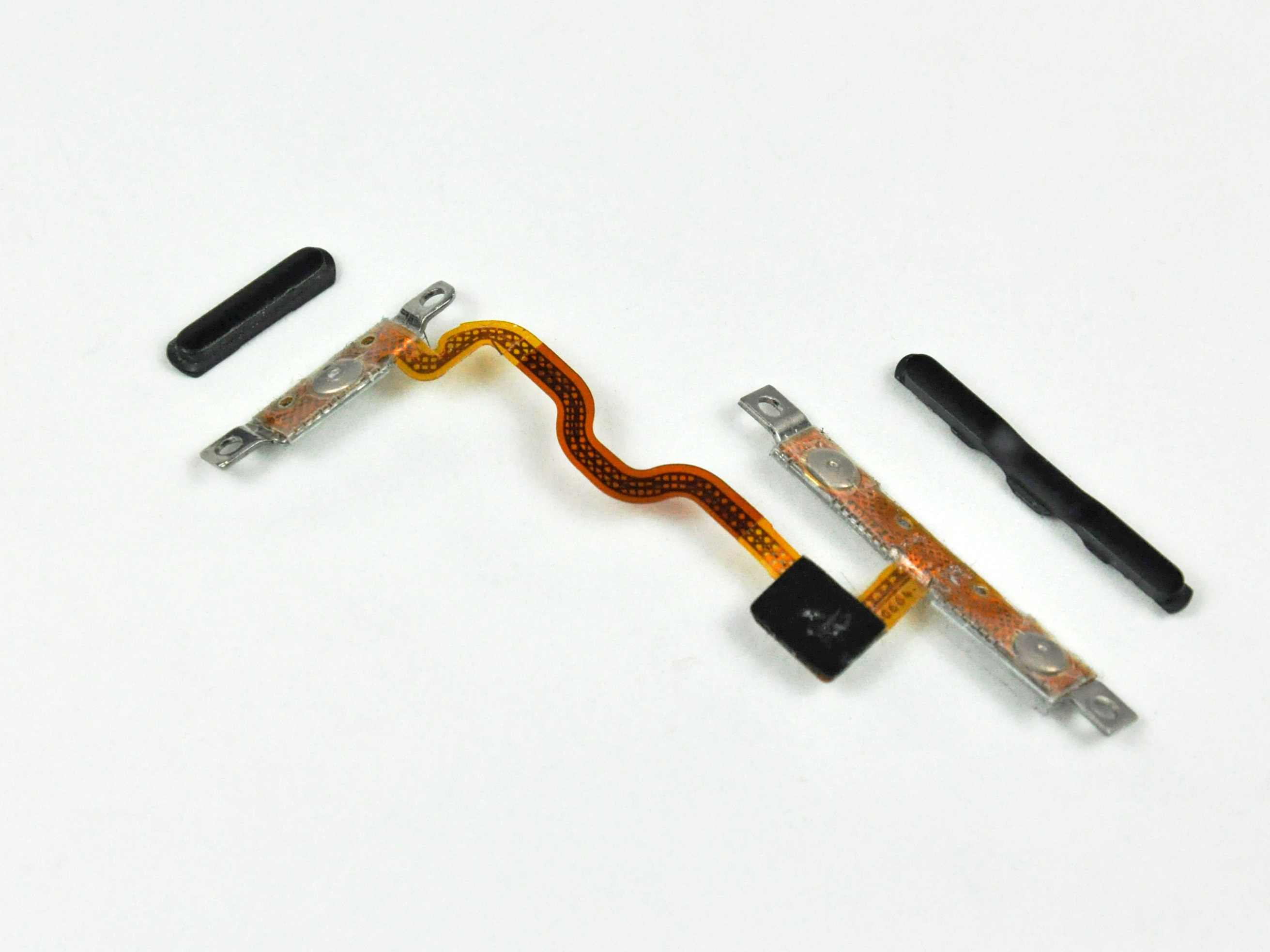

Add Note Edit Step 31 — Power/Volume Controls  ¶
  • Remove the two Phillips screws securing the power/volume controls to the rear panel.
first image
Add Note Edit Step 32  ¶
  • Use the tip of a spudger to remove the yellow kapton tape covering the power/volume control ribbon cable.
first image
Add Note Edit Step 33  ¶
  • Lift the power/volume controls out of the rear panel.
first image
Add Note Edit Step 34 — Power/Volume Controls Replacement  ¶
  • Power/Volume controls remain.
