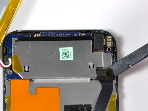

Add Note Step 1 — Case
  • Opening the case is a tough and potentially dangerous task. A good amount of force is required to wedge the iPod opening tool in between the case seams. The case may be damaged if this step is not done properly. Make sure not to hurt yourself while opening your iPod.
  • Insert the small iPod opening tool into the seam in between plastic display panel and the metal back panel. The angled edge should point towards the metal back panel.
  • Hold the tool in place once it is wedged inside and the two panels are separated.
first image
thumb image 1
thumb image 2
thumb image 3
Add Note Step 2
  • There are seven interlocking retaining clips on each side of the iPod. The large iPod opening tool will be used to separate the front panel from the metal back of the iPod.
  • Insert the large iPod opening tool into the right side of the iPod, with the edge of the tool pointing towards the metal back.
  • Gently enlarge the existing crevice by wiggling the large iPod opening tool and moving it to the right.
  • Continue doing so until the right side of the iPod is loose.
first image
thumb image 1
thumb image 2
thumb image 3
Add Note Step 3
  • Switch to the other side of the iPod.
  • Follow the same procedure as in the previous step to release the seven clips holding the panels in place.
  • Once the panels are separated on this side, the back panel can be separated from the rest of the iPod.
