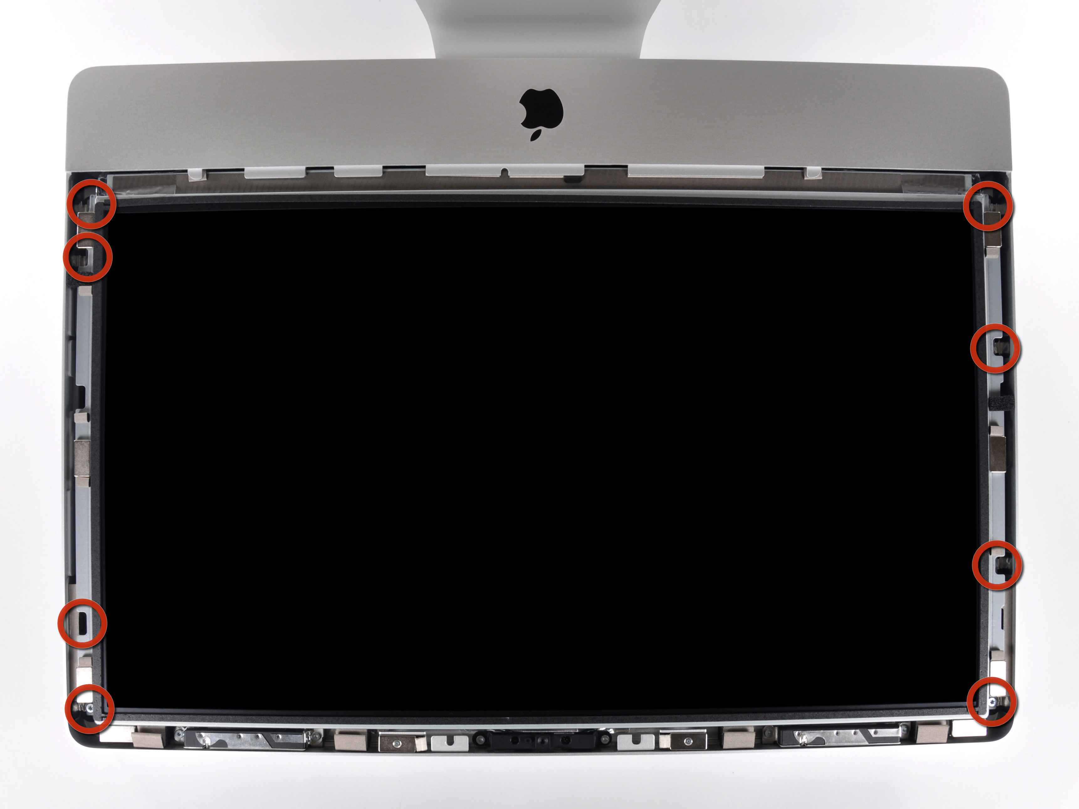

  3. iMac Intel 21.5" EMC 2308 Display Replacement, Display: step 3, image 1 of 3 iMac Intel 21.5" EMC 2308 Display Replacement, Display: step 3, image 2 of 3 iMac Intel 21.5" EMC 2308 Display Replacement, Display: step 3, image 3 of 3
    • Remove the eight 8 mm T10 Torx screws securing the display to the outer case.
    • The last two pictures are detail shots of each side of the display.
