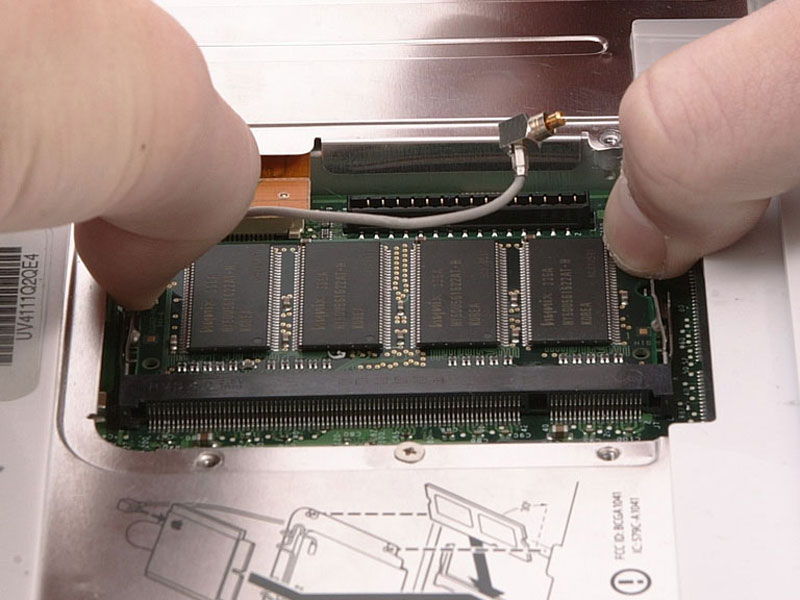

Add Note Edit Step 10 — RAM  ¶
  • Release the tabs on each side of the RAM chip at the same time. These tabs lock the chip in place and releasing them will cause the chip to "pop" up.
first image
Add Note Edit Step 11  ¶
  • Pull the chip directly out from its connectors.
