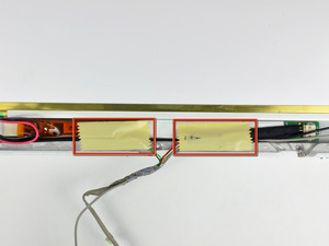

Add Note Edit Step 60 — Display Data Cable  ¶
  • Remove the two pieces of tape over the display data/microphone cables near the lower edge of the display.
first image

Add Note Edit Step 63 — Inverter/AirPort Cables  ¶
  • Remove the two pieces of tape covering the inverter/AirPort cables along the lower edge of the display.
