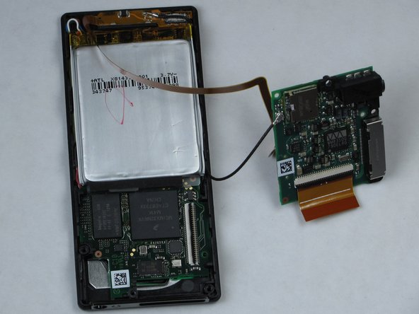

Add Note Edit Step 7  ¶
  • Use your finger or a Zune opening tool to pry back the two clear flaps.
  • Next lift the communications board that was being held down by the clear flaps.
  • Be careful not to accidentally detach the slim ribbon that connects between the communications board and the device.
Image #1 Image #2 Image #3

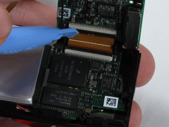

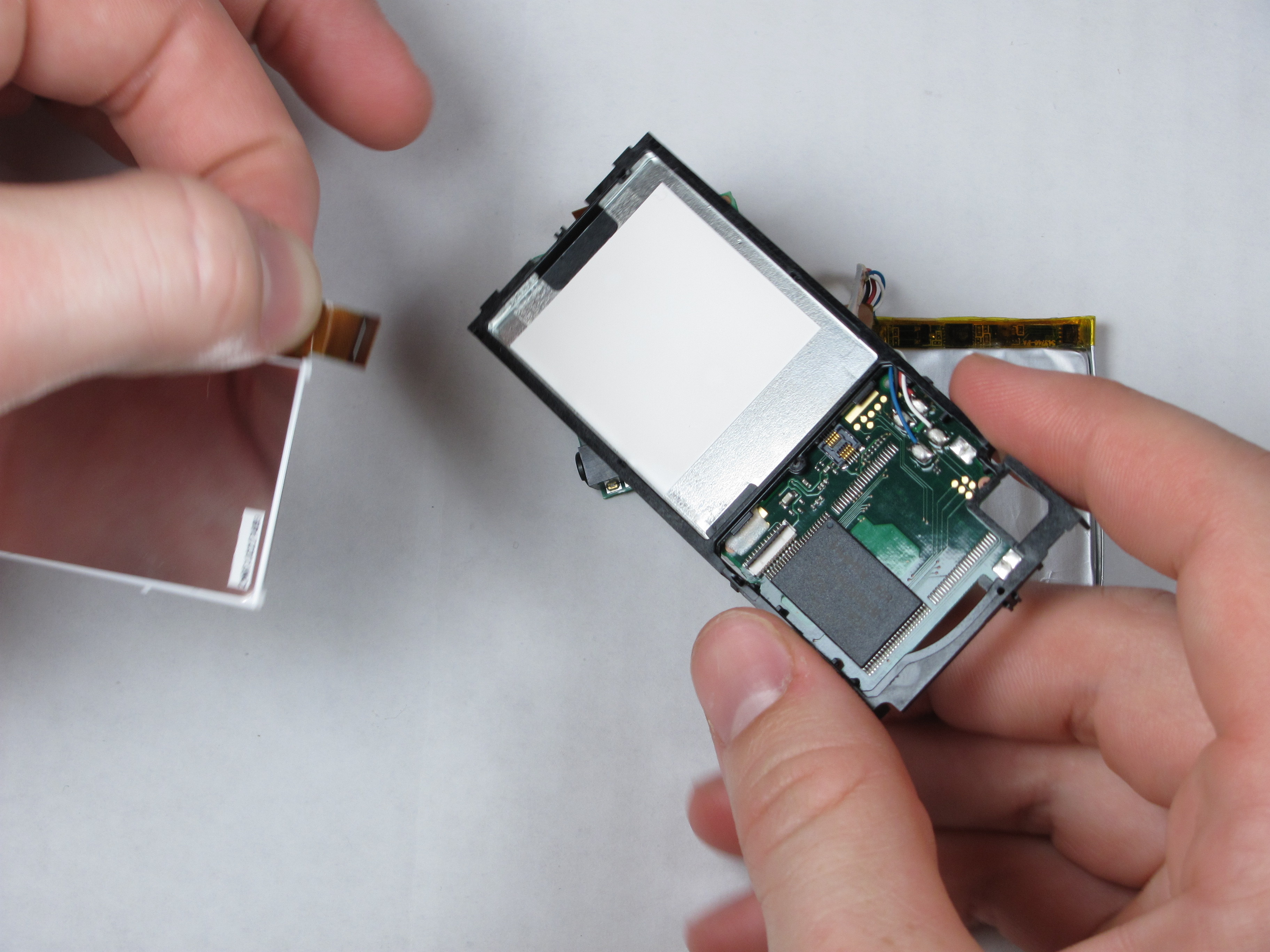

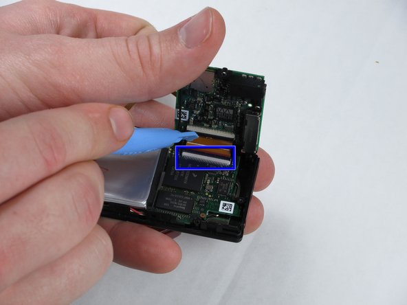

Add Note Edit Step 8  ¶
  • Disconnect the ribbon with the plastic opening tool by flipping up the black plastic flap where the ribbon connects to the memory board.
  • Carefully pull the ribbon out of the memory board, ensuring that the black plastic flap is up before removal to avoid the ripping the ribbon.
