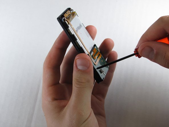

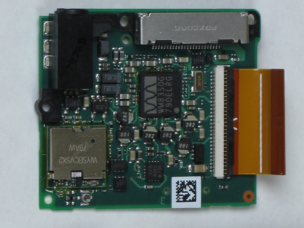

Add Note Edit Step 6 — Communications Board  ¶
  • Remove the three screws (5.5mm by 3mm) from the backside of the Zune using a small Tri-Wing screwdriver.
Image #1 Image #2

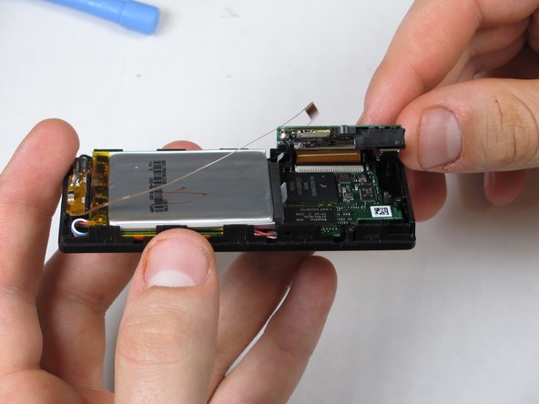

Add Note Edit Step 7  ¶
  • Use your finger to pry back the two clear flaps.
  • Slowly lift the communications board that was held down by the clear flaps.
  • Be careful not to accidentally detach the slim ribbon that connects between the communications board and the device.
Image #1
Add Note Edit Step 8  ¶
  • Disconnect the ribbon cable with the Zune opening tool by flipping up the black plastic flap where the ribbon cable connects to the memory board.
  • Pull the ribbon cable out of the memory board.
