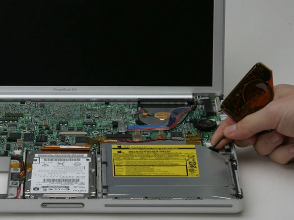

  15. PowerBook G4 Aluminum 15" 1-1.5 GHz PRAM Battery Replacement, PRAM Battery: step 15, image 1 of 1
    • Use a spudger to pry up the PRAM battery from the optical drive.
  16. PowerBook G4 Aluminum 15" 1-1.5 GHz PRAM Battery Replacement: step 16, image 1 of 1
    • Disconnect the PRAM battery cable from the logic board and pull the PRAM battery out.

For those that are trying to do this in 2021, when new replacement parts are basically unavailable — you can replace just the cell itself with a new unit — Panasonic actually still makes these 3032 rechargeable cells. The part is here: https://www.digikey.com/en/products/deta...
The new ones are a 3V cell; the Apple spec’d battery is 3.7V, but it seems to work fine. You’ll need basic soldering skills — take the old unit out, unwrap it from the kapton tape, unsolder the old one and solder in the new one. Make sure to use a hot iron and spend a minimal amount of time heating (not more than a second or so). You want to heat the terminal, but not the battery itself.
When I did this, my old Apple OEM battery was reading a 1.03V charge; the new one was a full 3.05 volts.
david - Reply
An update 3 weeks later — the cell above did NOT work. Battery stopped holding a charge and was leaking badly; I think this may be because the new cell was only 3.0V and the original was 3.7V, and possibly the charging circuit was overcharging it.
I have found a 3.7V cell on ebay, so I’m going to try that next.
david -
SUCCESS! The 3.7V battery worked wonderfully, and has held a PRAM charge overnight twice now. Charges back up fine too; no leaking.
I purchased this one from eBay: https://www.ebay.com/itm/Cgl-3032-3-7-v-...
If you’re reading this in 2025, I’m sure that link will be dead — you’re looking for a 3.7V (NOT 3.0V) 3032 LIR (Lithium Ion Rechargeable) battery with solder tabs.
david -
Thanks for the detailed information, david (from another david)! I’m searching here in 2021 (in Canada) and that eBay option is unavailable to ship here, sadly. Doesn’t seem to be options for 3.7V of the 3032 LIR - but searching like crazy to avoid paying $100 from Apple dealers here who somehow have private stock for old PB G4s. Would really love to find one to do repair myself on my otherwise great condition PB G4 15” that kept freezing up (most likely dead PRAM - but haven’t been able to test / discover that).
David - Reply
