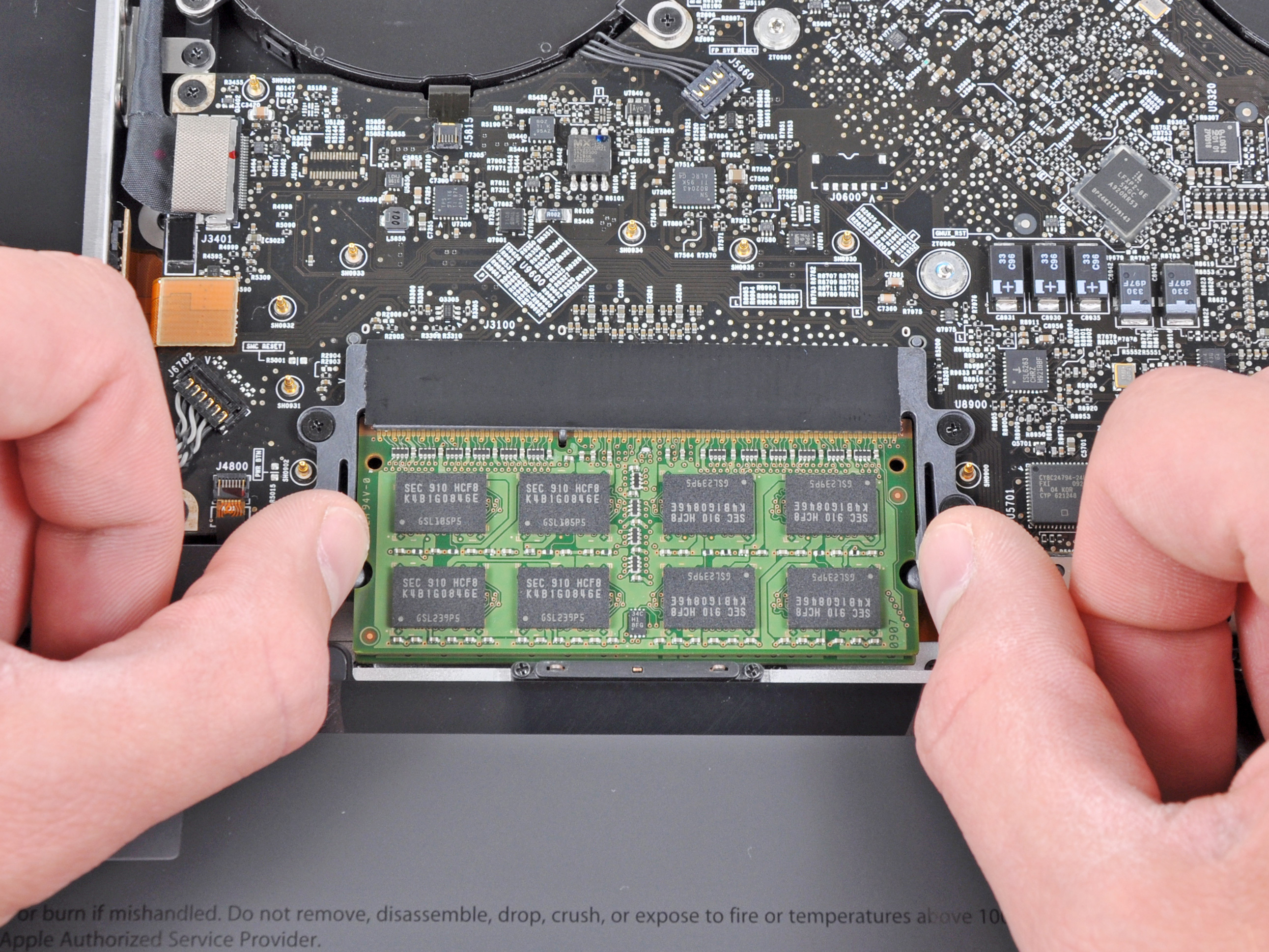

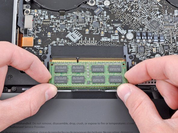

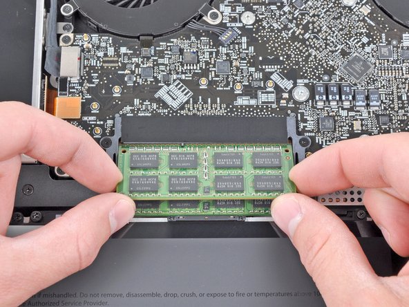

  4. MacBook Pro 17" Unibody RAM Replacement, RAM: step 4, image 1 of 3 MacBook Pro 17" Unibody RAM Replacement, RAM: step 4, image 2 of 3 MacBook Pro 17" Unibody RAM Replacement, RAM: step 4, image 3 of 3
    • Release the tabs on each side of the RAM chip by simultaneously pushing each tab away from the RAM.
    • These tabs lock the chip in place and releasing them will cause the chip to "pop" up.
    • After the RAM chip has popped up, pull it straight out of its socket.
    • Repeat this process if a second RAM chip is installed.
