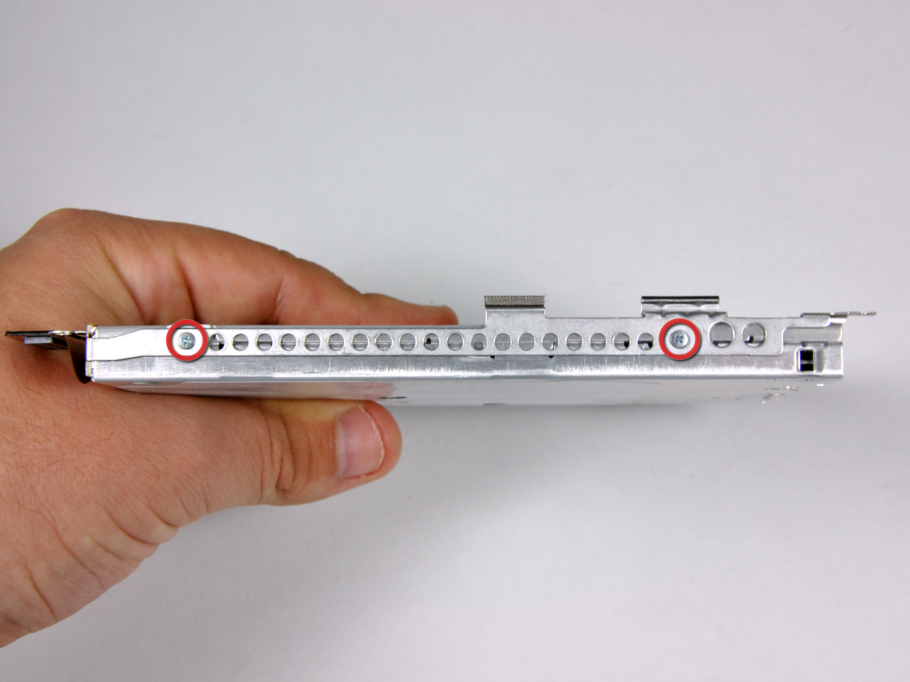

Add Note Edit Step 14  ¶
  • Rotate the drive and remove the two Phillips screws securing the mounting bracket to the right side of the optical drive.
  • If you purchased an optical drive without mounting brackets, simply transfer the three silver metal brackets and orange ribbon cable to your new optical drive.
