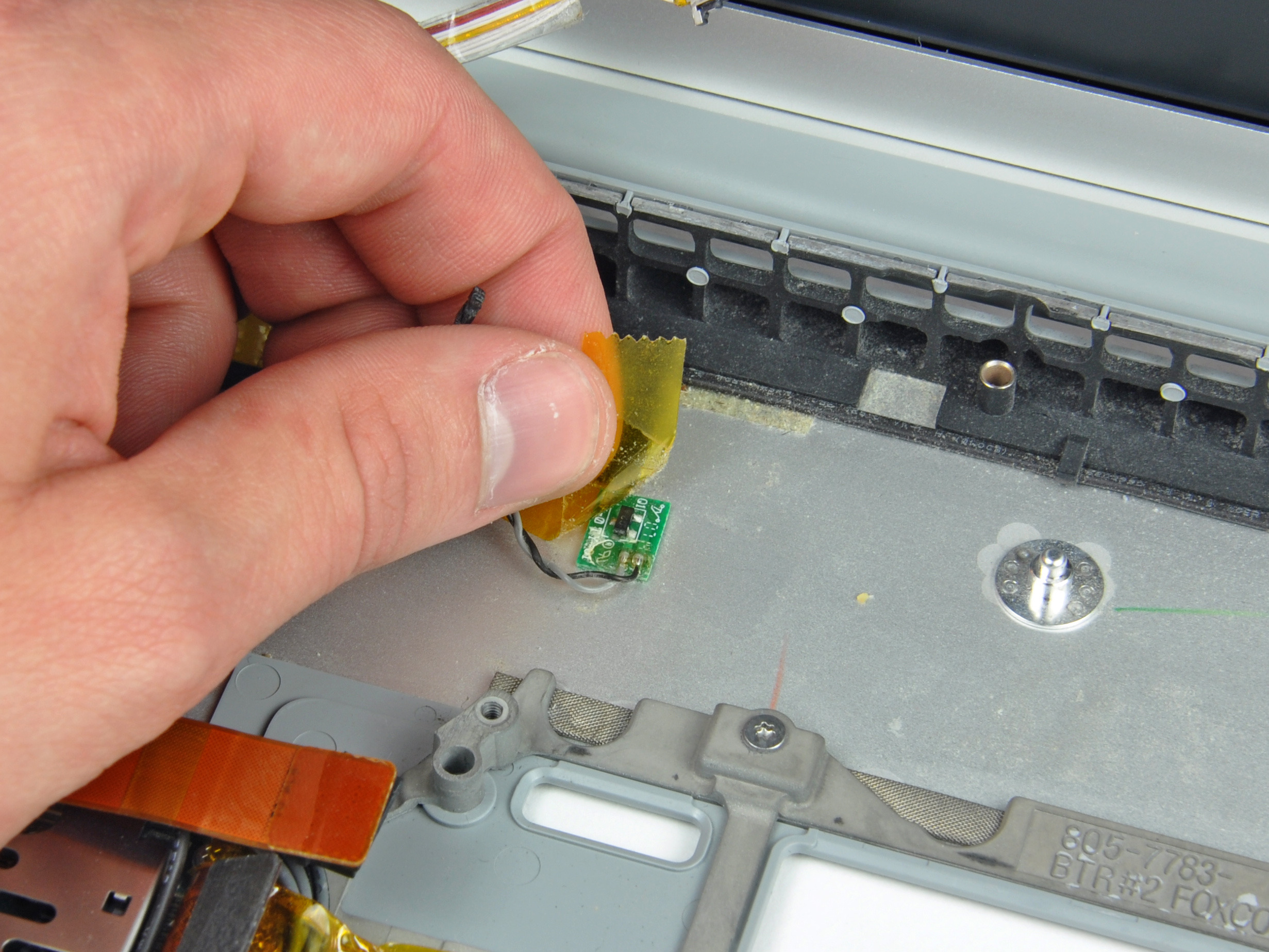

  23. MacBook Pro 15" Core 2 Duo Models A1226 and A1260 Left Thermal Sensor Replacement, Left Thermal Sensor: step 23, image 1 of 1
    • Peel back the piece of tape covering the left thermal sensor.
  24. MacBook Pro 15" Core 2 Duo Models A1226 and A1260 Left Thermal Sensor Replacement: step 24, image 1 of 1
    • Use the flat end of a spudger to pry the left thermal sensor board off the adhesive securing it to the lower case.
