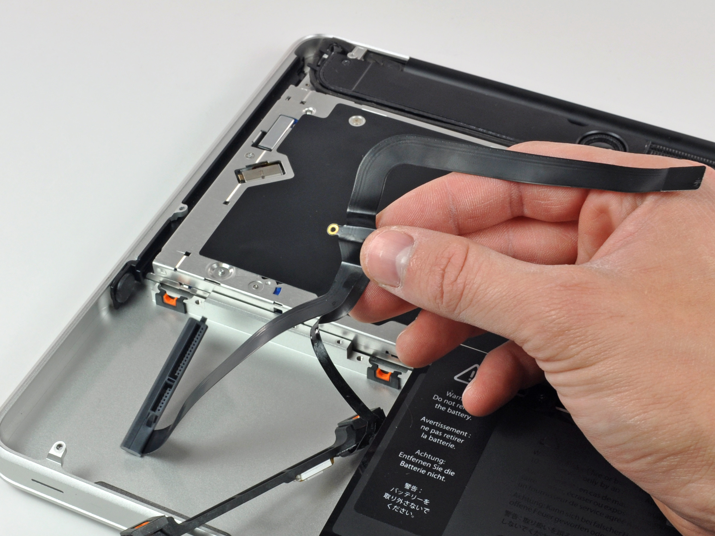

  8. MacBook Pro 13" Unibody Mid 2010 Hard Drive Cable Replacement, Hard Drive Cable: step 8, image 1 of 1
    • Remove the following four screws securing the hard drive and IR sensor cable to the upper case:
    • Two 1.5 mm Phillips screws.
    • Two 9.5 mm Phillips screws.
  9. MacBook Pro 13" Unibody Mid 2010 Hard Drive Cable Replacement: step 9, image 1 of 2 MacBook Pro 13" Unibody Mid 2010 Hard Drive Cable Replacement: step 9, image 2 of 2
    • Slide the hard drive and IR sensor bracket away from the edge of the upper case.
    • Carefully peel the hard drive and IR sensor cable from the upper case.
  10. MacBook Pro 13" Unibody Mid 2010 Hard Drive Cable Replacement: step 10, image 1 of 1
    • Use the flat end of a spudger to pry the hard drive cable connector up off the logic board.
  11. MacBook Pro 13" Unibody Mid 2010 Hard Drive Cable Replacement: step 11, image 1 of 1
    • Lift the hard drive/IR sensor cable assembly out of the upper case.
    • If your replacement part does not come with the hard drive bracket and indicator light, you will need to pull those off of the part you are removing and install them on the new part.
    • Your replacement part may come with several adhesive foam bumpers. These are to ensure a snug fit of both bracket and hard drive. Apply only as needed.
