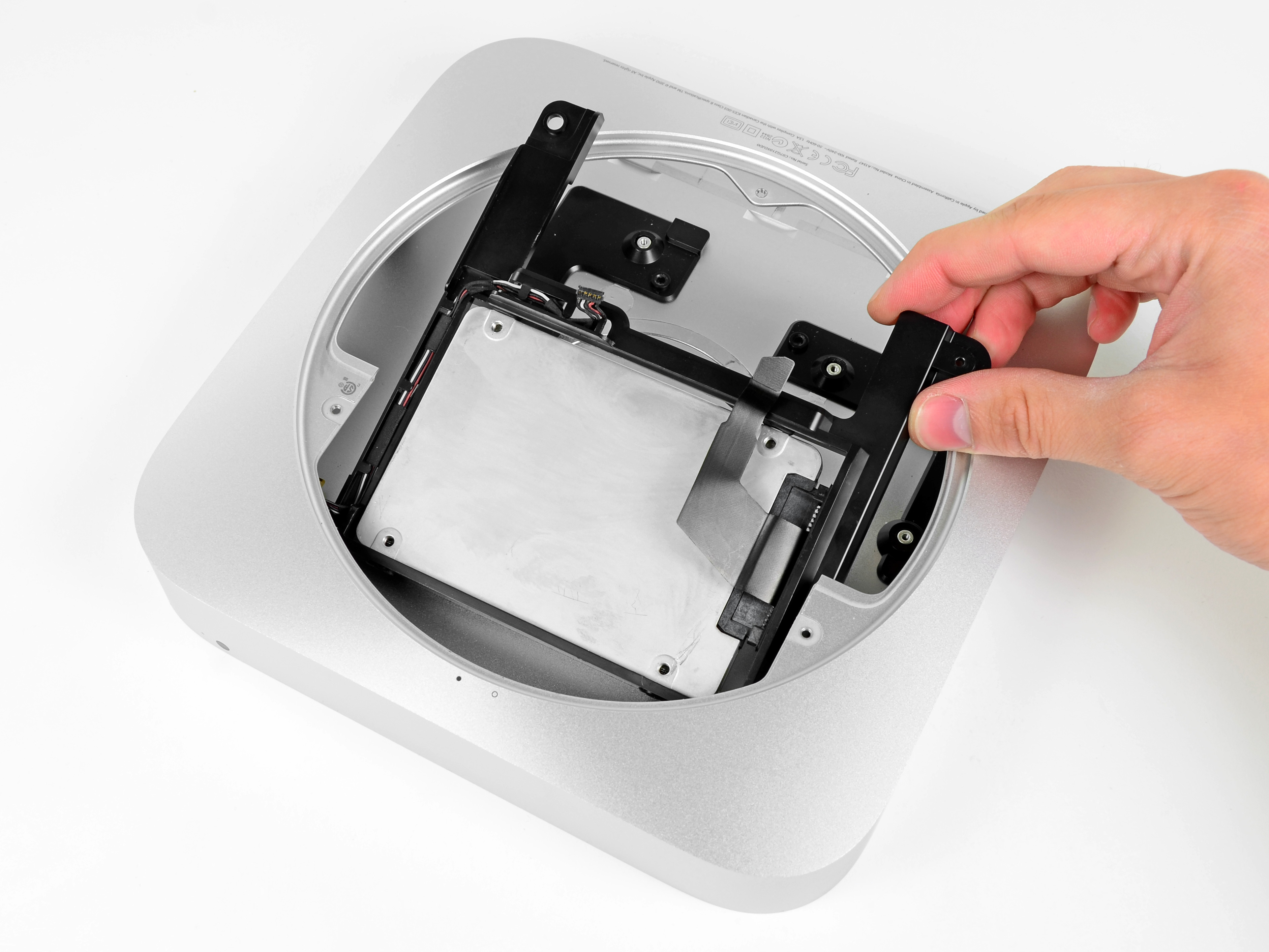

Use this guide to install iFixit's Dual Hard Drive Kit in your mid 2011 Mac Mini.

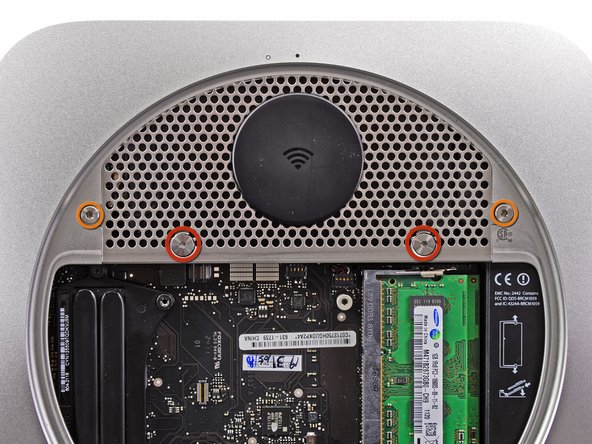

Add Note Step 8 — Dual Hard Drive Kit  ¶
  • Remove the following screws securing the antenna plate to the mini:
    • Two 6.6 mm T8 Torx screws
    • Two 5.0 mm T8 Torx or 2.0 mm Hex screws (either screwdriver will work)
