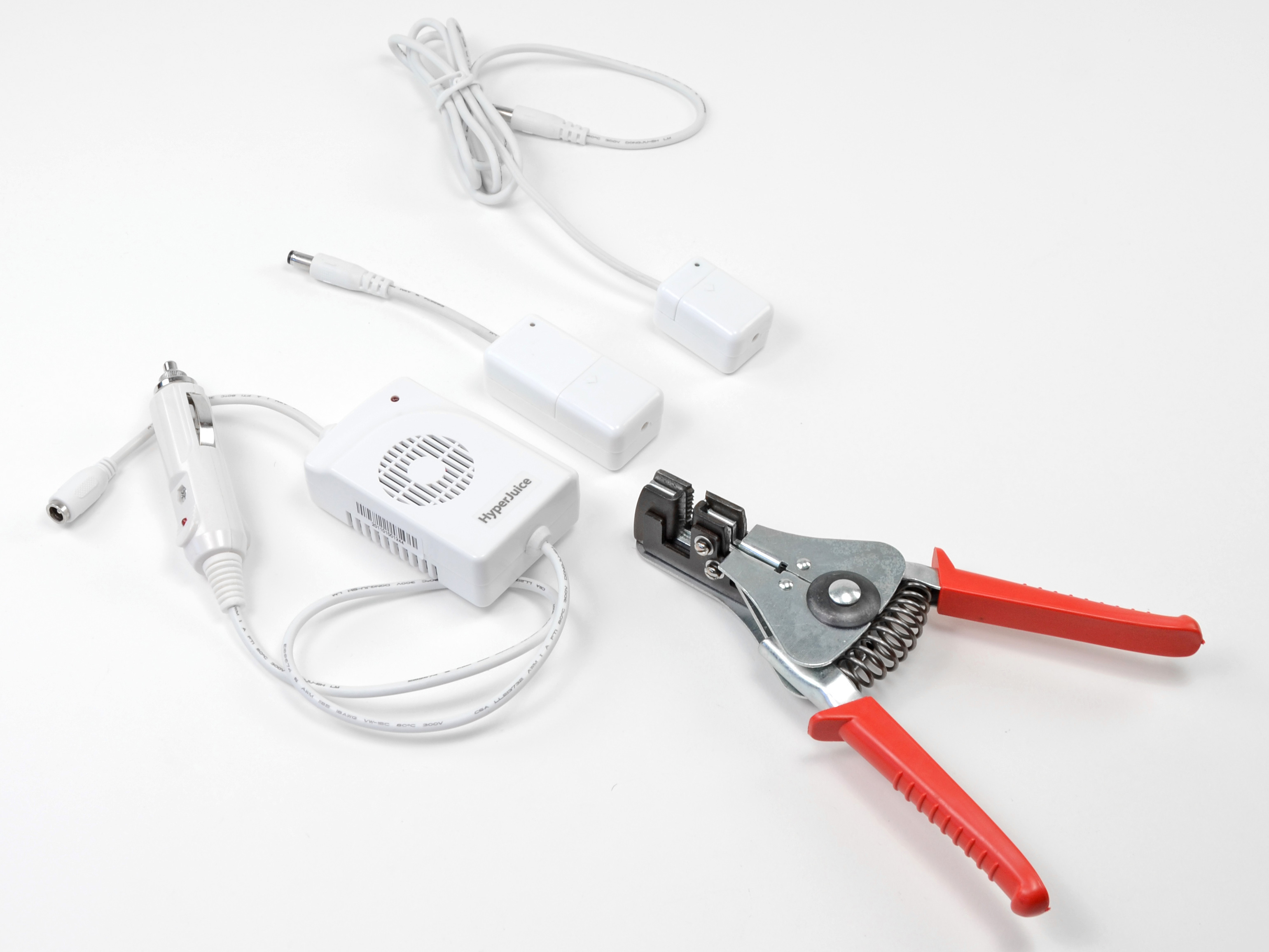

  2. HyperJuice Magic Box User Guide, Materials: step 2, image 1 of 2 HyperJuice Magic Box User Guide, Materials: step 2, image 2 of 2
    • Before beginning, lay out the contents of the Magic Box kit. They should include (clockwise from the left):
    • Car Adapter
    • Large Magic Box
    • Small Magic Box
    • Wire Strippers
    • Also locate the MagSafe charger you wish to modify.

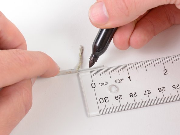

  4. HyperJuice Magic Box User Guide: step 4, image 1 of 1
    • Use a pen to make a mark about .75" (2 cm) from the cut end on the side of the cable attached to the power adapter.
